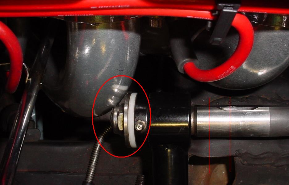

      I pulled my stock UCAs and LCAs today in hopes of installing my DSE tubular a-arms. Well, the right-front UCA has a huge interference (at least 1") with the #4 header tube.
      Don't get me wrong, I love the DSE control arms, but crap why can't anything just work without major surgery? I guess now I get to pull the header, find someone to alter the tube and have it re-coated.
      Sorry, just venting.................

      Does your tall deck 572 have anything to do with them not fitting?
      Delaware, OH
      1,379
      Quote Originally Posted by Norwoodx55
      Probably has everything to do with it.

      I'm thinking a large diamter socket and a heavy hammer! Hopefully teh coating is flexible enough. Looks like a little dimple would do it. The cross shaft shouldn't move much unless the frame has alot of flex so just a little clearance should do it.
      I could be that individual set of header. I had an extra pair of the same Hooker I run on the car we used on the dyno. I could not get the oil filter off as it hit the headers, never and inssue on the same model number. I have yet to find a set of headers that didn;t need a little tweak somewhere.

      I'd have to 'dimple' the tube in half to get it to fit. I put two red lines on the pic I posted and the a-arms needs to go left at least 1" before the cross-shaft bolt will line up with the hole. I just need to find someone to re-work that tube.
