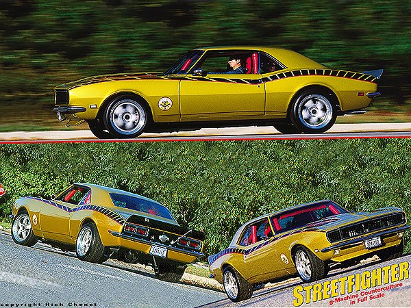

      I'm starting to collect ideas for a cage to put in my '67 Camaro. The car will primarily be a street car with some Track use. I'm looking at the April 2002 PHR where Mark Stielow detailed the install of the cage in the Mule. He states "Having a removable crossbar on my rollcages is nice, so when the car is not being used for competition, I have full access to the interior." He never actually says this is to allow rear seat passengers though. Does anybody have any more insight into this?

      Here is part of an article from the July 2003 Chevy High Performance:
      Mark didn't pull any punches with the interior either. Perhaps the biggest challenge was tucking the 10 point rollcage up out ot the way to allow use of the back seat.
      Another part:
      What may not be immediately noticeable is the 10 point cage because Mark spent hours adjusting the tubing until he had tucked it almost out of sight. Detroit Speed & Engineering also came up with the custom dash pod mounting the auto meter instruments......
