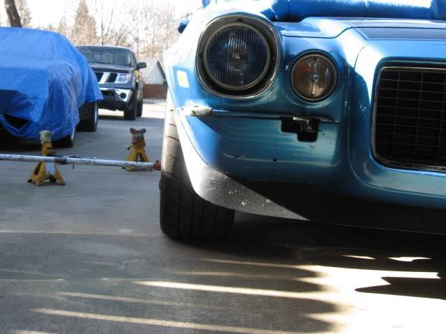

      Today test fit some wheels on my 2nd gen Camaro and the larger diameter of the tires causes rubbing on inner fenderwell when turned about 3/4 of the way to full lock. I noticed that the wheel is also off center when straight ahead. Attached is a photo. I also have 6* of caster which would attribute to this. I was wondering how your cars were. I have been working on 2nd gens for sooo many years and not sure if this ever came up.

      Keith,
      What size tire is that?
      Mary's 73 barely touches at full lock with a 245/45/17 with 7 deg positive caster.

      Camber will cause the wheel to rub as well

      Are the upper and lower control arm bushings in good shape. I had the same problem with my 68 Camaro. I just installed urethane bushings and it corrected the problem. Look at the pic of my 68 in my PT Garage. It was taken before I fixed the problem.

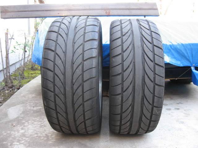

      Sorry i should have mentioned the tires are 275/40/18. I usually have 255/45/17 up front, but a customer wanted to go "BIG" so I test fit my rears on the front. I think a 25.5" tall tire is the max on a lowered car, the 18" are nearly 27" tall. As far as bushings and such, all is good. Sorry guys, if you can't fit enough brake in a 17" wheel, you don't need it. Formula 1 runs 13" front wheels! Get a better brake!
