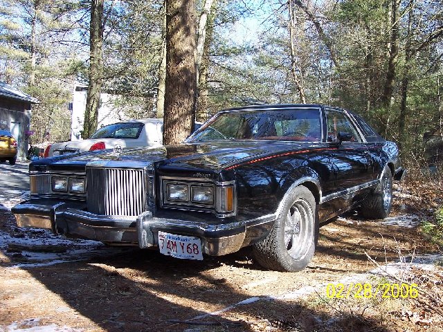

      I figured I'd pop in and say hi. This is my Cougar so far.
      Started out like this
      Car has 80K miles. 351W/C4/2.41:1 rear.. power sport buckets with console and column shift (weird I know).

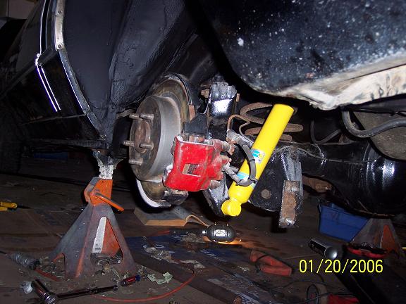

      I've upgraded the front from the stock 11" to 12" rotors, using factory parts.
      Before
      Rear discs are Ford Explorer pieces. I'm still rolling with stock 351W springs but all the bushings are now poly, and I upgraded the shocks to Bilsteins, heavy duty pieces from a Crown Vic P71 (I should have used non cop car shocks in hindsight).

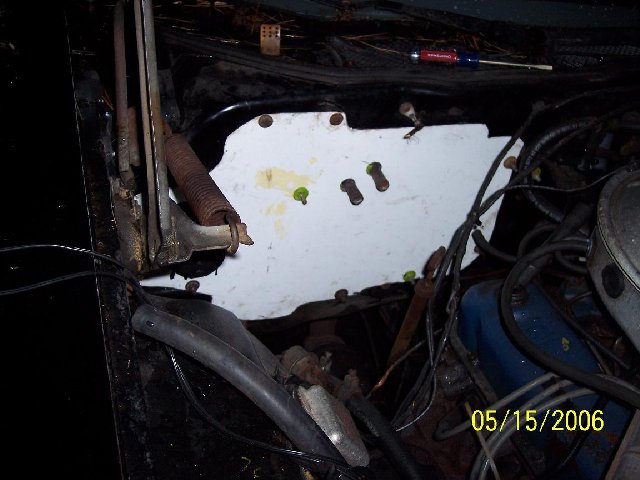

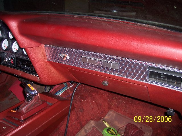

      I also "de- ac'd" the car, using all factory parts from a non A/C 76 Ford Elite.
      (some pics here, but if you want the full conversion, click this link
      http://v6z24.com/jbodyforum/viewtopi...461&highlight=
      This shaved 95 lbs from the car.

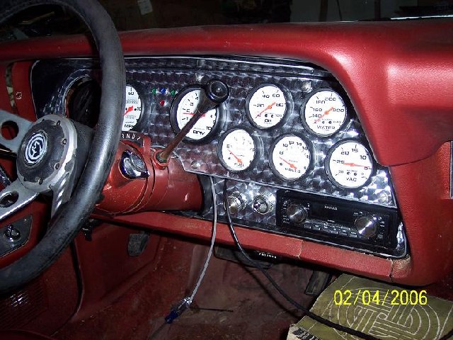

      I also made up an Auto Meter gauge panel. Not bad for my first attempt at this sort of thing
      a buddy cut out the plexiglass for me.
      Looks factory :-)

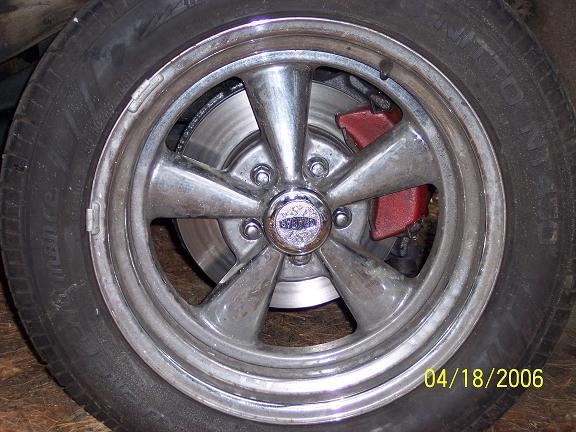

      I roll (for now) on 17" cragars.

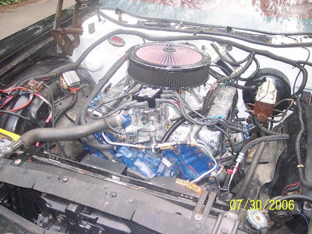

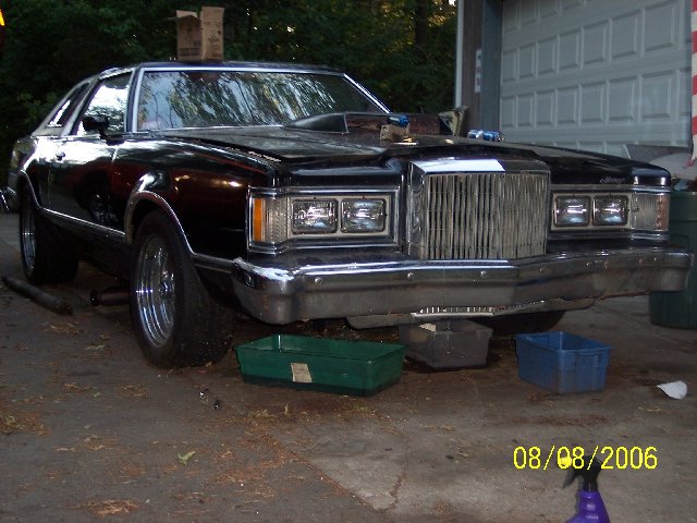

      I also finally got my 460 in!
      Thread here.
      http://460ford.com/viewtopic.php?t=4429&highlight=swap

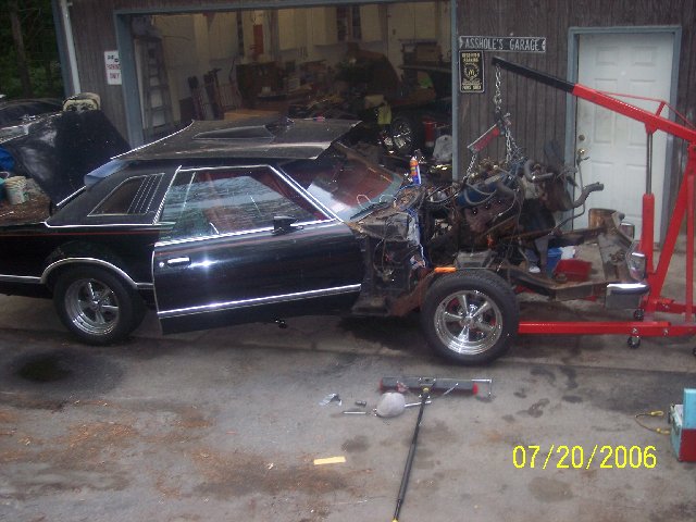

      The nose was off so I could swap nicer sheet metal.
      Rough draft (yes I know the glass filter was bad)
      I've swapped to this
      Of course, once the engine was in (which is from my old Elite), one piston was down on compression a lot.. bent valve and a nicked bore.. awesome.. Engine is currently out, and I have "other plans"

      Wheels MIGHT turn into 18s and 20s. However the Explorer rear discs barely handle the 17s on the car now, and the 12" rotor is as big as I can go without making something up.
