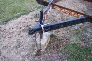

      I have never had a car hauler but have a brand new truck and need something to pull
      I have a lead on a 16 foot single axle for $100 bucks. I imagine I could probably add another axle and clean it up to make it worth my while.
      What do you think? Does the frame look to thin for a car hauler?

      frame is too thin (a guess per picture)
      adding an axle and additional structural support, decking, lights, brakes, paint and all the labor will cost more than to go buy one new.

      I am with harshman, run!! I learned the hardway, don't skimp on the car trailer. The fenders need to be low enough to open the car doors I had one that you had to take the fender off the trailer to get the door open. battery caught fire in the trunk with the windows rolled up, and the only set of keys inside the car. By the time I got the fender off and got the fire extingusher out of the car the thing almost burnt up. Learned alot about safety and having the right trailer!

      What was that, an old travel trailer? 16 ft is too short unless you are hauling MGs.
      Like the other posts say, run from this, no way I would put a car on it.

      I figured the steel would be to thin, but was hoping maybe I could reinforce.
