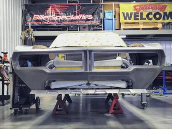

      Grill is in place, light assemblies and buckets are done but not mounted yet. Will hopefully post pics of that soon. Things are taking shape but there is plenty to do still. Hoping to get the intake printed soon so we can complete the induction plumbing.

      CNC Machined 6061 Aluminum Grill Installed
      Grill finally in place.

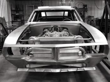

      Front end has been off and on so many times. Troy is working on the engine bay here, trying to wrap things up in time for SEMA. Hope to have updated pics soon with the front end put back together.
      Intake should be in within the next couple of weeks. Despite wanting to print the intake like we did for the prototype, the manufacturer lost interest in the project so now we are fortunate enough to have the guys over at EVOD jump on the project and work quickly to knock things out for BBT.

      This is where things stand on the engine compartment. The engine was put back in late last week. We are waiting on a few machined parts for the hood and inner fenders and things should start to wrap up on the front end for the moment.

      The engine bay is coming together and wrapping up. Plans for 3D Printed intake fell through despite having a really cool polymer model made. We are now having it machined out of billet and expect to have it next week. Everything does “not” always go as planned.
