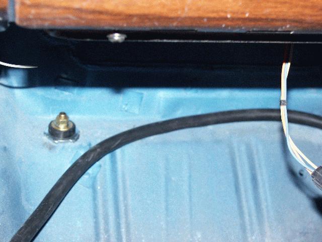

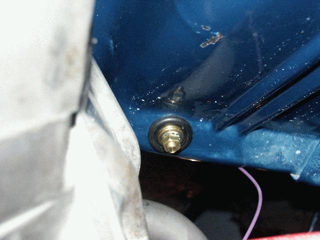

      Yeah, what he said. That's what I did on mine. Pictures aren't the best, but here they are...
