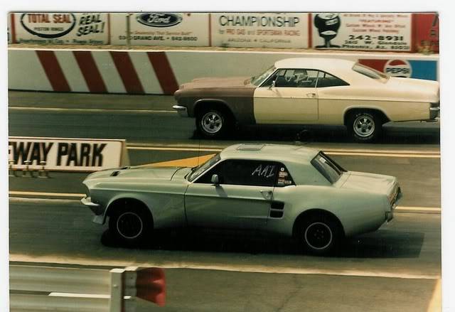

      Drag racing at Phoenix Raceway Park 1991 I think, 390 FE motor at the time....

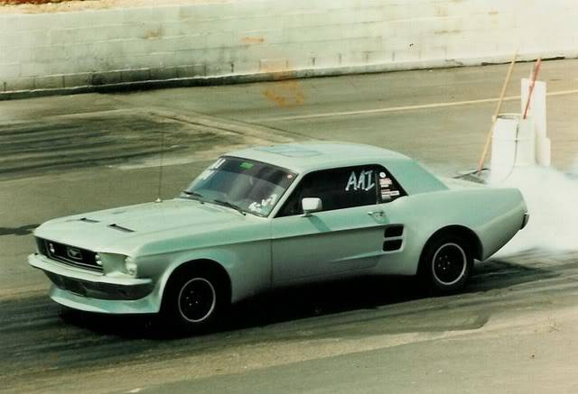

      Another shot same day, broke the rear end on that burn out... towed home.

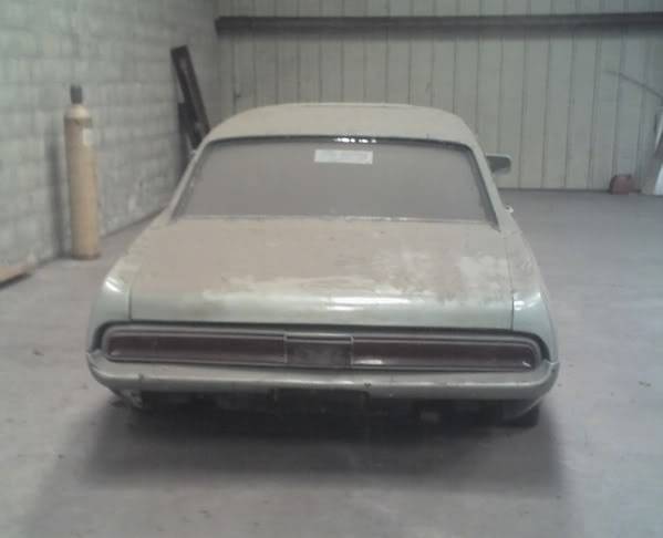

      Her spot of decay for over a decade...

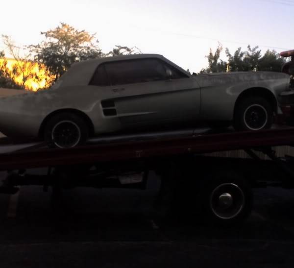

      The rescue...

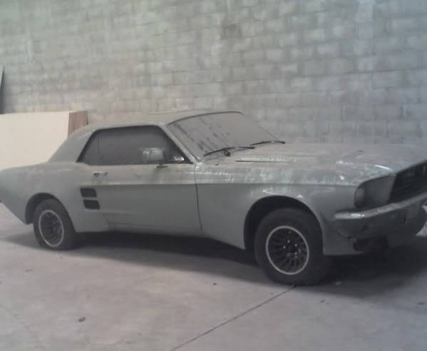

      And where she is today awaiting tear down...
