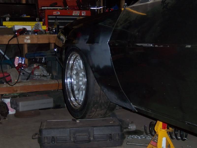

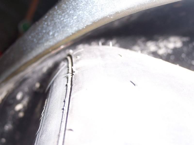

      You can fit them, but in my case (69) it took a lot to get it down low without dialing out any steering.
      At full lock
