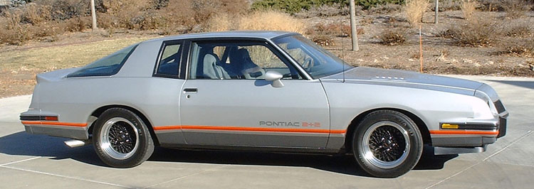

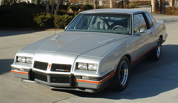

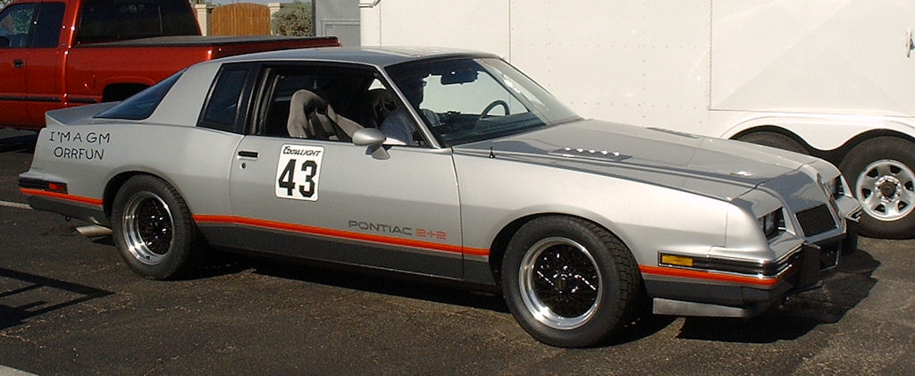

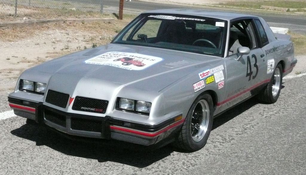

      The windows blow out at about 140 and by 168 the gap is about 1.5". When we drop below 120 mph, they pop back into place. They actually have about 2" of inward preload on them. The great thing about them is you can tell approximaely how fast the car is going when someone takes a picture of it.
      Here are some pictures of it without the stickers:
      And some with:
      The Stickers mainly cover "field modifications" where we had to bust out the sledge hammer to get more fender clearance, etc, so we'll leave them on until we redo the 14 year old paint.
