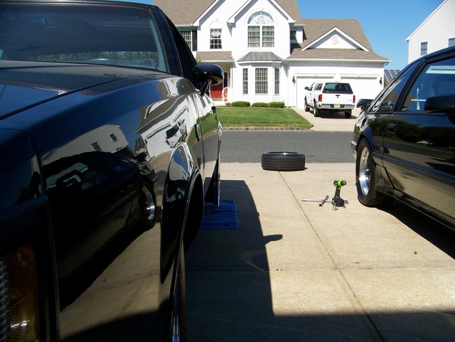

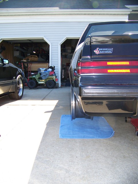

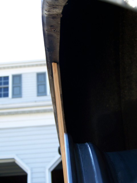

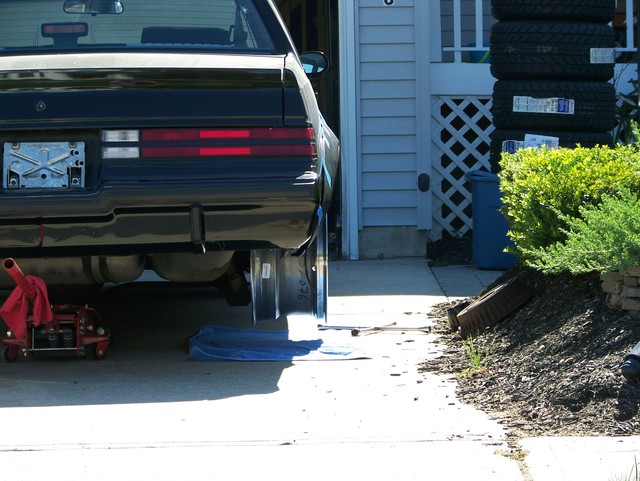

      Attached are the photos I took of the TT2 on the rear of the GN. I posted to the turbobuick site last night. I know its tough making a wheel choice. No one wants to buy wheels twice. Hopefully, this will help someone with their purchasing decision.
      I'll be running fender flares and doing the wheel centers in black. The straight edge shows where the wheel will land in the fender lip. Although they will need trimming, everything looks good. Keep in mind that mounted behind the wheel is an aluminum brake drum. The tires are not mounted yet.
      TT2 17x9.5 w/4.5" bs - will be using 285/40/17 BFG gforce KDW tires on the rear

      I hit the wrong button. Pics attached here...

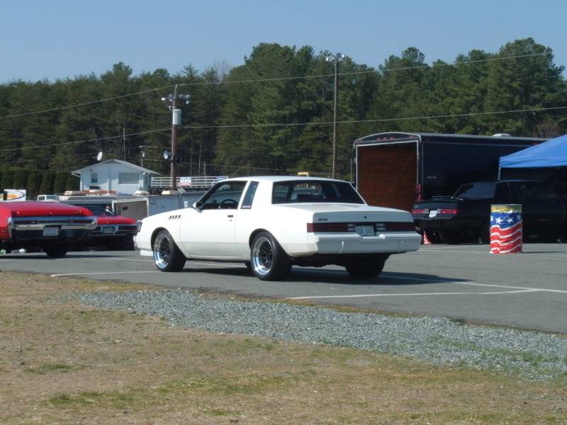

      I'm running this wheel & tire set up on our GNS Test Car "NO NOTCHING" at all !!
      REAR:
      285/40-18'' on 18x10" CCW "Clasic's" with a 4.75 BS
      FRONT:
      255/35-18'' on 18x9.5'' CCW "Clasic's" with a 4.75 BS
      If I were to do it all over again I would go with a 9'' wheel up front OR Try and squeez a 265 up front. (First I will try out the 265 up front)
