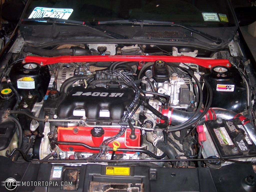

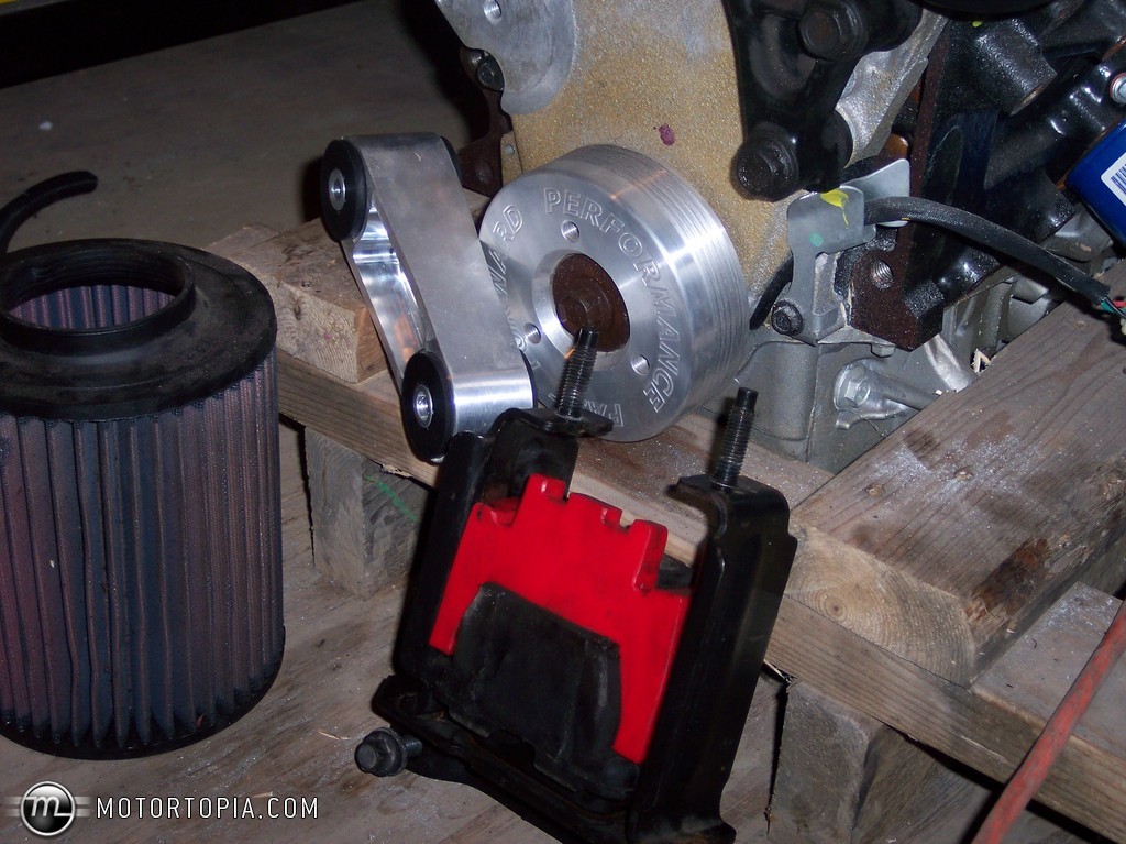

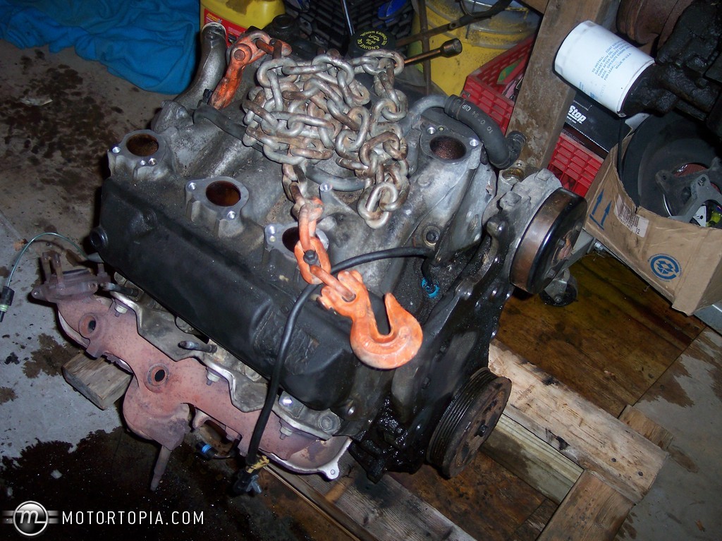

      3.1L to 3.4L. The engine is from a 2004 Impala with 4k on it going in my 95 Beretta. Had to change over sensors and do some rewiring to make it work with the 95 OBDI computer. Has a couple bolt ons (very limited aftermarket) and poly mounts.
      Should be some more fun in a straight line now. Still slow (~15.0) but faster than stock (16.5). It's already fun in the twisties with all the suspension upgrades.
      I do get a ton of crap about it cause it's "only a Beretta" and I know if I could get $4000 for the whole car I'd be lucky, even with double that in it, but it's something different. What do you guys think?
