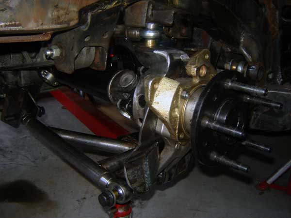

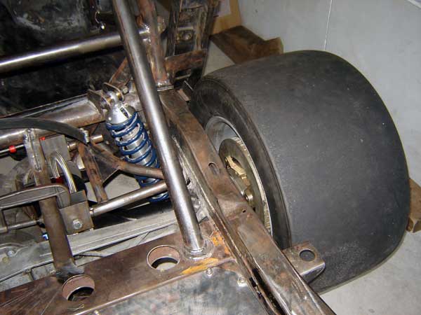

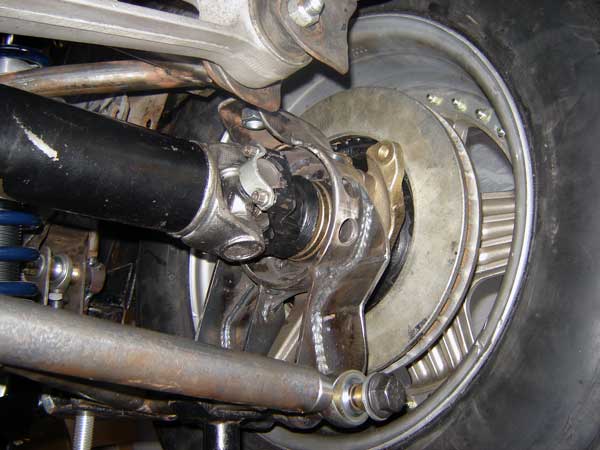

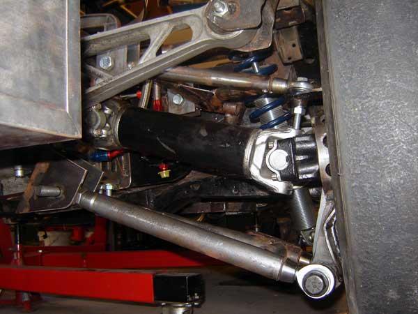

      My corvette came stock with IRS (although a petty crappy trailing arm setup) , I first changed it to a 5 bar but then decided to build a double a arm setup.

      Your tires don't have tred on them. I'm interested in your porject. care to give us the scoop?

      They are slicks that's why they don't have thread. Pics are here:

      TT, I think Wendell kind of knew what your tires were all about.... Bitchin car! Have you had the double wishbone setup on the road yet?
      You are definitely my kind of guy. Great ideas on that car.
