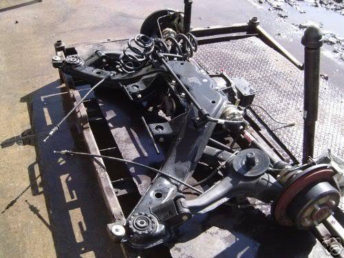

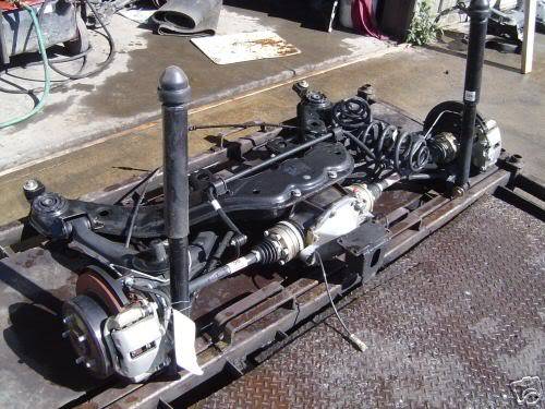

      The cobra and gto unit come already assembled on their own cradle/subframe.
      COBRA
      GTO
      Why not just weld that subframe to the frame of my chevelle?
      If it aligned propely an the spring towers are moved on the car, I dont see why this would be a bad idea.
      I like the gto setup because it doesnt have any camber and the srping location is similar to a chevelle.
      I hear they are weak however.
      I think I can retain the back with both of these.
      The C5 is not really a stand alone system ans seem like it would be harder to install properly.

      The GTO setup has to have some camber curve otherwise it'll suck in cornering-- because as the body rolls the outside tire will go positive camber decreasing available lateral grip since the tire contact patch is compromised.
      The Cobra setup being an SLA-based setup will have definate negative camber gain on compression, which is what you want to maintain grip on the outside tire during cornering.
      Stuff like this is why designing a good *effective* IRS is more difficult than designing a good stick axle suspension. With a stick axle you're more limited in design parameters since you don't have to worry about camber/toe change (unless running a cambered housing) and lateral scrub issues... with an IRS setup you suddenly throw FVSA, toe change, lateral scrub, etc, into the mix as well.
      Perhaps are the trailing arm mounting points angled in the GTO to give some form of camber gain on compression? There has to be *something* in that IRS to compensate for body roll.
      All I'm trying to say is given the effort involved to retrofit an IRS into your car I would want to see you do it RIGHT. No reason going through all the work IMO just to be able to say you have IRS in your car when the setup performs worse than a well thought out stick axle.
      Weight is a mixed bag too, usually IRS setups have reduced unsprung weight at the expense of greater overall assembly weight. At least with the Cobra setup I know that will be the case!
