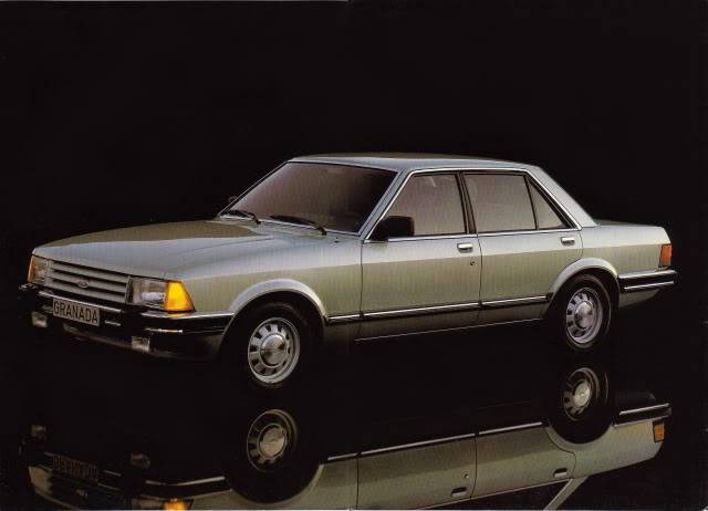

      This is what the looked like from the factory:

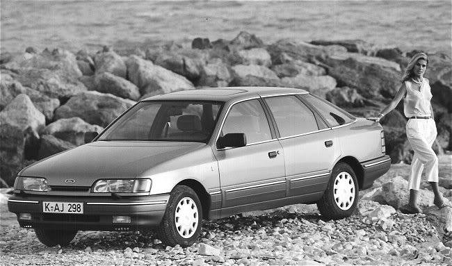

      And this is the european Ford Scorpio, from witch i used the bumpers
