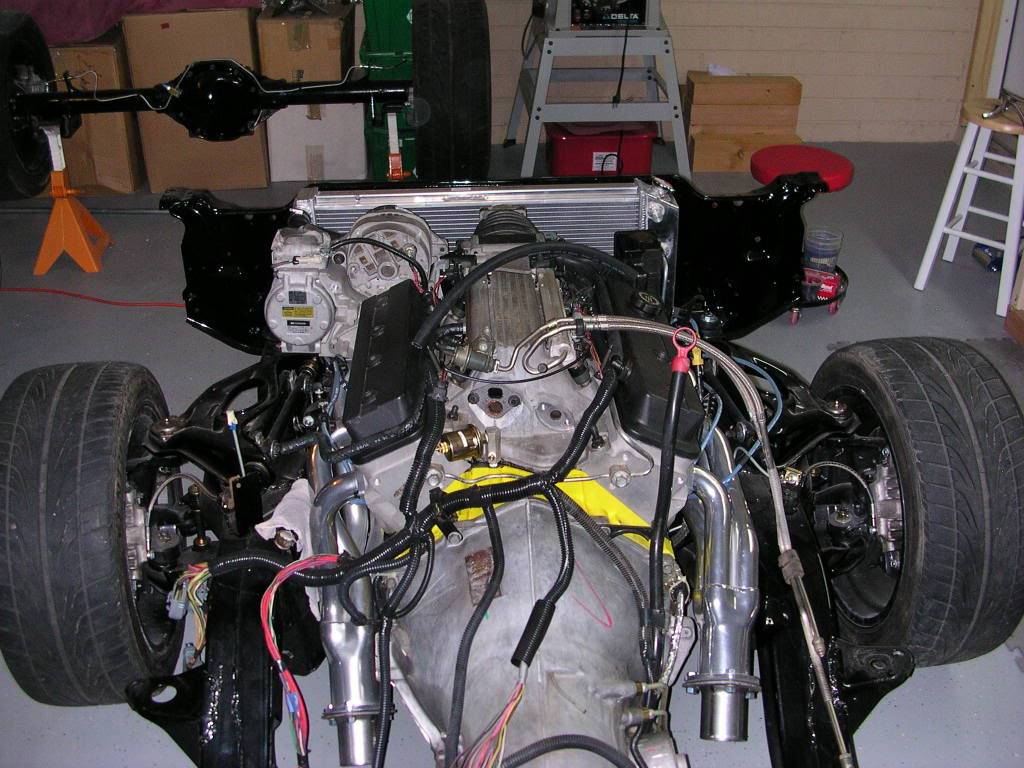

      After nine months of little to no progress, I finally got a little time to work on the car (or pieces of it at least!). I bought the Camaro four years ago from a kid who had it stripped down for circle track. It looked like swiss cheese on the inside due to all the holes drilled in it.
      This past year I decided to quit half-assing it and start a frame up, unfortunately the city compliance guy was not a car fan and issued a few citations... Long story short, I now have a new garage at the house .

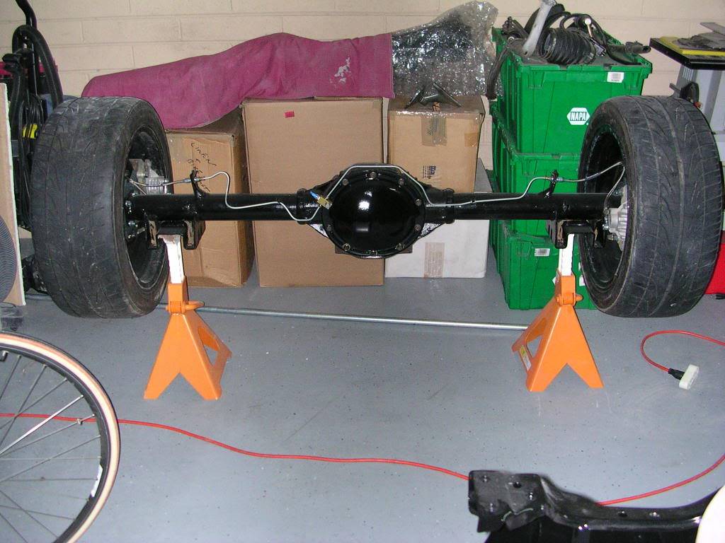

      The body is currently at the shop and is sloooowly taking shape. They have the firewall smoothed and are working on newly discovered cancer. I am hoping that it will be ready by spring, but... Anyway, the engine is coming along and most of the sub-frame is now complete. Monday I completed the brakes, installed new studs and got it sitting on the ground. The trans cross member still needs modified, but I think I can just turn it around and weld the tab on the opposite side. Also the Corvette exhaust manifolds hit the cross-member, so if anyone has header or manifold suggestions for the LT-1, send them my way (picture would be nice also).

      The wheel are aftermarket BMW rims from Discount Tire. I picked them up off Craigslist for $200 and am using them for rollers. When I put the LS1 brakes on, my 16" ralley repros would not fit; such is life. They were a bit of a pain as the offset is around 16mm, so the lug holes are very deep necessitating the use of tuner lug nuts and new wheel studs. True to form, no upgrade performed so far has been easy.

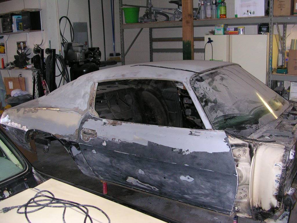

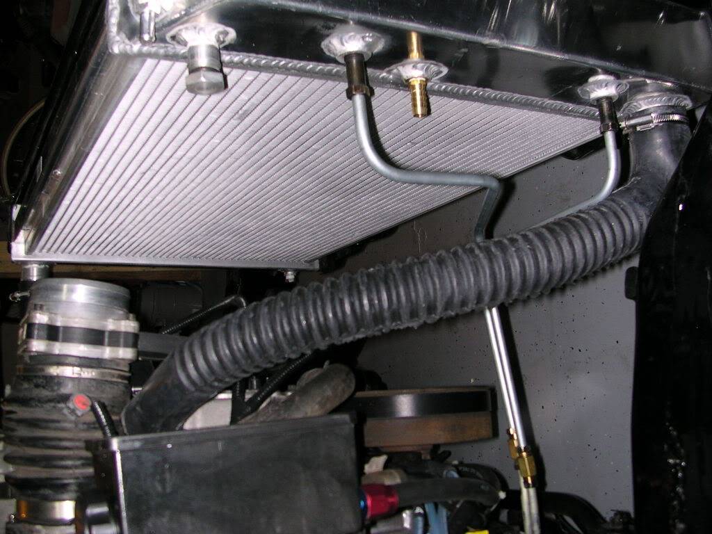

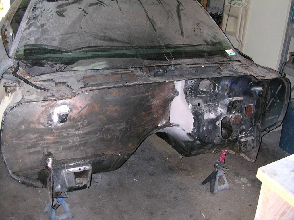

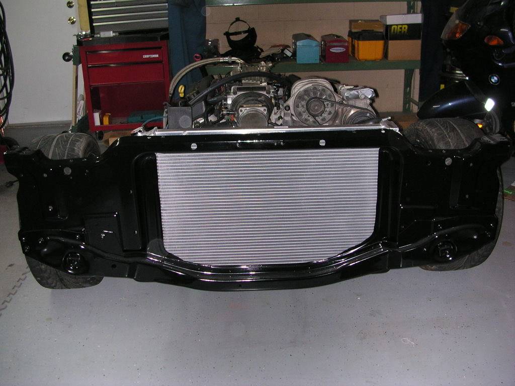

      It has been awhile since I posted an update. After 15 months at the body shop, progress is finally being made ! Hopefully I will have it back at my place by June... The engine is close to being finished, just a few block-off plates to fab and a little more wire work. I finished (well almost) plumbing the radiator this afternoon, so it is ready to load for the shop as is the rear.

      All this time and still ugly!

      Yes, I know, the tubing is a bit long :-)
      Radiator
      The rear is not the best view... hmm, I think I have heard that before...
