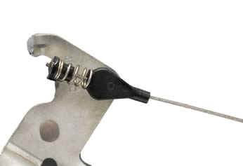

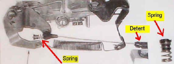

      328
      Brian, I know about the brackets that you are talking about.
      The manufacture that I am dealing with uses a "corrector spring" that I have attached pictures of. I was told by them to use only this and that I would not need any additional brackets to make the trans work properly. My lack of faith that this spring will fix everything is why I have posted this question.
      BTW, I am running a Speed Demon Jr carb.
      NY
      1,070
      When setting up a TV you are to pull cable out approx 3/8 out with throttle at rest. This usually gives you a very close setting. You can then have someone hold pedal to floor and verify cable is fully extended without slack. I would assume that spring has just the right tension to give you the initial setting. Good idea? I guess it gets you in a close ball park. I just do not think it would eliminate the progressive? bracket. The bracket is about $25 and you can still use the spring deal? $25 VS $2000 tranny? GM designed those brackets to work with that tranny. If they could have saved cash with a spring it would have been in there?
