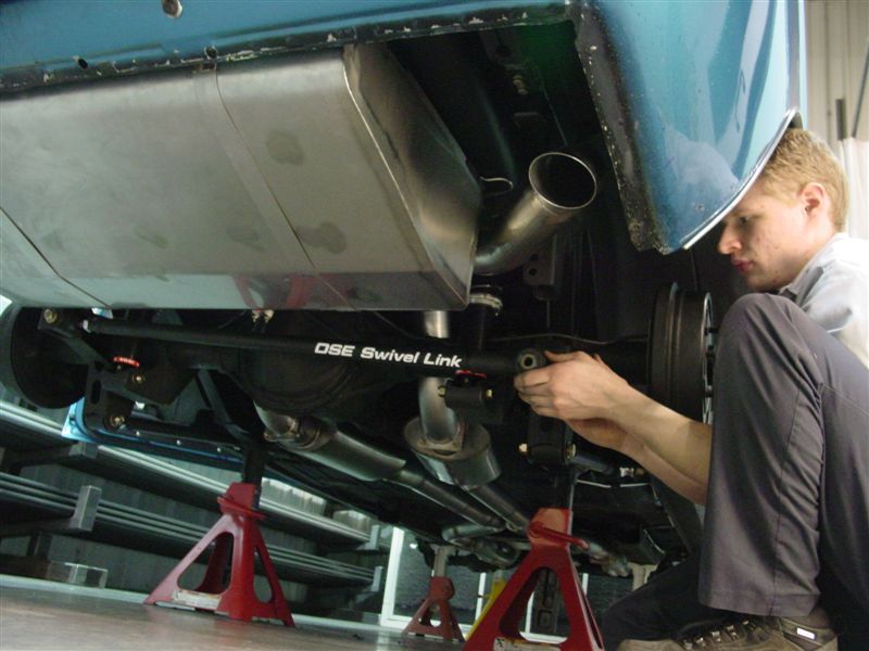

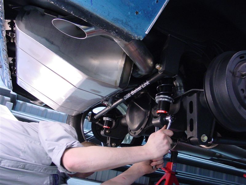

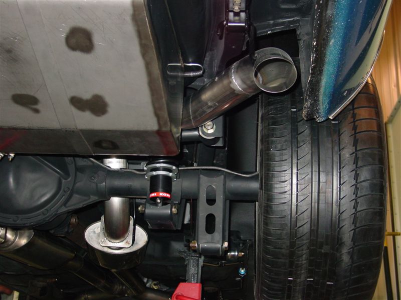

      Scott at DSE sent me some pictures. The same picture is in the super chevy with the test results.
      You need to notch the gas tank.

      This is the best of the pictures from DSE. There is a fairly large notch in the tank. I think the angle needed to clear the shocks makes the angle by the corner of the tank. But it can be done with 3" round pipe.

      I would like to answer your questions regarding the exhaust clearance with our DSE QUADRA Link kit. The bolt-in stainless steel fuel tank that we sell comes with an angle built into the fuel tank to provides adequate clearance for a 3" round exhaust system to run all the way out the back. The pictures below show our prototype fuel tank on our DSE Test Car. Once we developed the angle required, we changed the design on all of our Camaro fuel tanks. They still have a 19 gallon capacity, but allow more exhaust clearance. If you do not have our fuel tank, you can still run your exhaust all the way out the back of the car; however, it is tighter.
      If anyone has any questions, please feel free to contact us. We are happy clarify any questions you may have.
