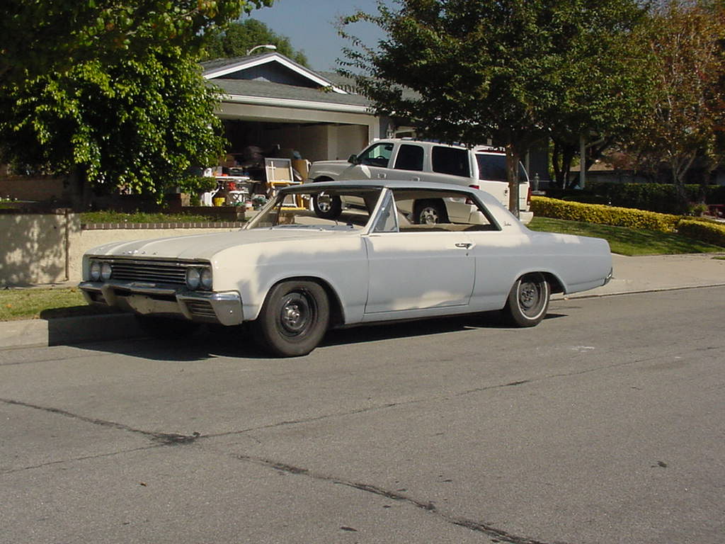

      Here is mine at the moment -
      Need to get wheels/tires for it so I can adjust the stance a bit. Need to lower the front a tad or raise the back a tad.
