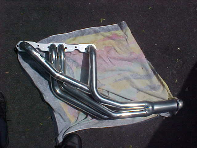

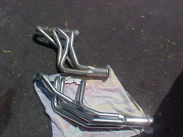

      Well the hookers were bad so i ordered these. tell me if im wrong be these are longtubes right? i just have to hack the old exhaust back and put on the collectors hopefully.

      Those look like longtubes to me. And they look pretty nice!

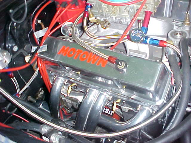

      ahh sucess...

      hey that's lookin nice!
      new zealand
      113
      hey 1fine success with the headders cool,just took a look at your site man i had your car confused with another wow that is nice will be killer with your combo.

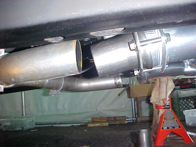

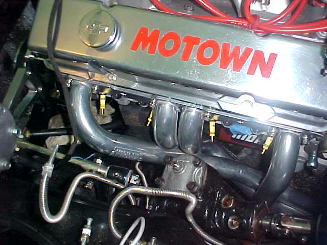

      well i just noticed the headers are kitting the steering bow by like a paper sheet width. if i push the headers a little bit they clear. should i just run them and see if there is vibration? and if there is just dimple it? one more question......how should i connect this. i was doing to hack saw the collector that came with the headers. put it in a vice and slot it in 4 places then clamp it and lessen the radius a little. that would enable it to slide inside the exhaust. heres pics. what do you guys think?

      What brand headers are these? What size primaries are they? I'm on my third set of Hooker Super Comps 1 3/4 primaries. They hit the pitman arm. I'm running an AGR box. This is the last set I'm going to try then I think I might try S&S. What do you think of S&S?
