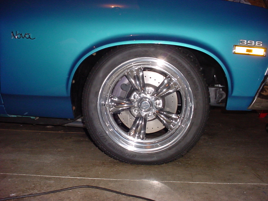

      I 100% agree! Noel helped me out tremendously and they have a GREAT product!
      http://www.danhardison.com/discs/DSC00869.JPG

      nice rims....look familiar

      nice rims.....look kinda familiar
      Thanks. The rims are Centerline Retro's. Not bad for the money, though they have gone up consideribly since I bought mine.

      i thought they were budnik fontana's. thats what mine are
