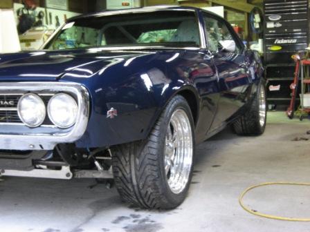

      Better late then never I guess..
      The attached is the best picture I have to date. It's a little more put together but not much.
      The best way to describe how it drives has to be by comparing it to flying a F-14 or something....
      I was able to get one of my buddies to actually pass out.
      The newest update happing this spring is flopping out the rear suspension with coil overs and a watts link setup.
      Jake
