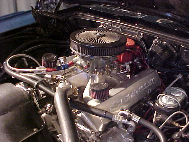

      Well heres the install. Everything went great. Only had a little trouble with the driver side motor mount but it took ten minutes to fix. I have to get those valve covers off though! i think they look horrible. What your opinion and if you feel the same way as me whats your suggestion. More pics will be coming.

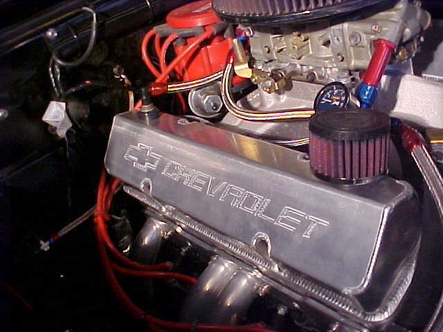

      the new fabbed alum valve covers came from canada and they look awsome.i also took the car to my local shop and had them install the new 3 inch x pipe system from pypes. unfortunately we couldnt get it to go over the axle so its turned right before. the new flowmaster delta force 40 series race mufflers are unreal.i need to wear earmuffs after ten minutes. so loud and flow great.im happy. now i jsut gotta get pics of valve covers and sound clip of exhaust

      heres the covers...tell me what u think
