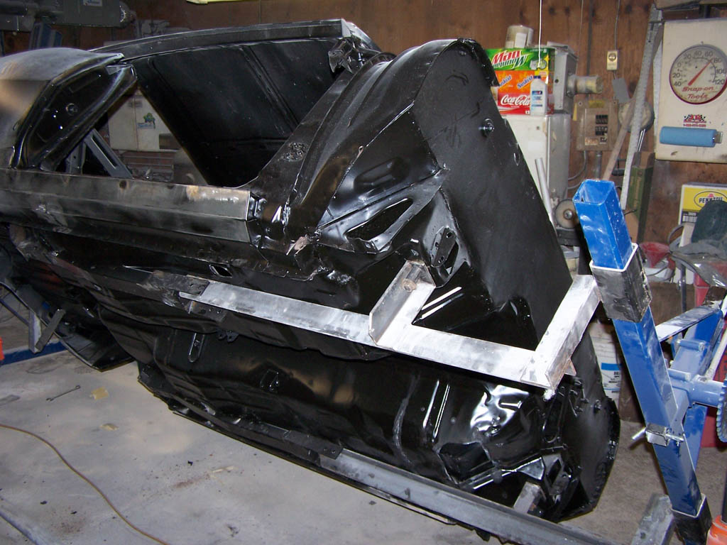

      Actually, I prefer not seeing the factory seam. So I used 2 pieces of 16 gauge scrap metal (cost was about $12) and made a new firewall that won't have the factory seam. The fuse box will also be hidden, so you won't see the wires. Anyway, here is a few photos to show the work. Initially we was going to tack the sides in, but my friend thought I would prefer it to be welded in solid (shown in the last photo). Lot more work involved here, but the firewall will be painted the same as body color. Which is marina blue.
