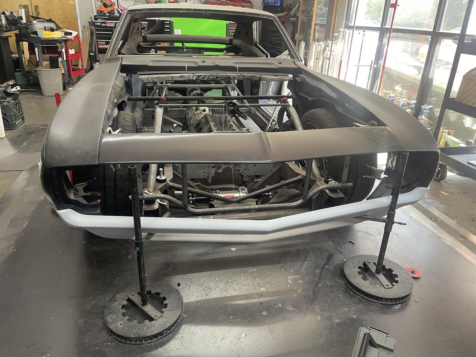

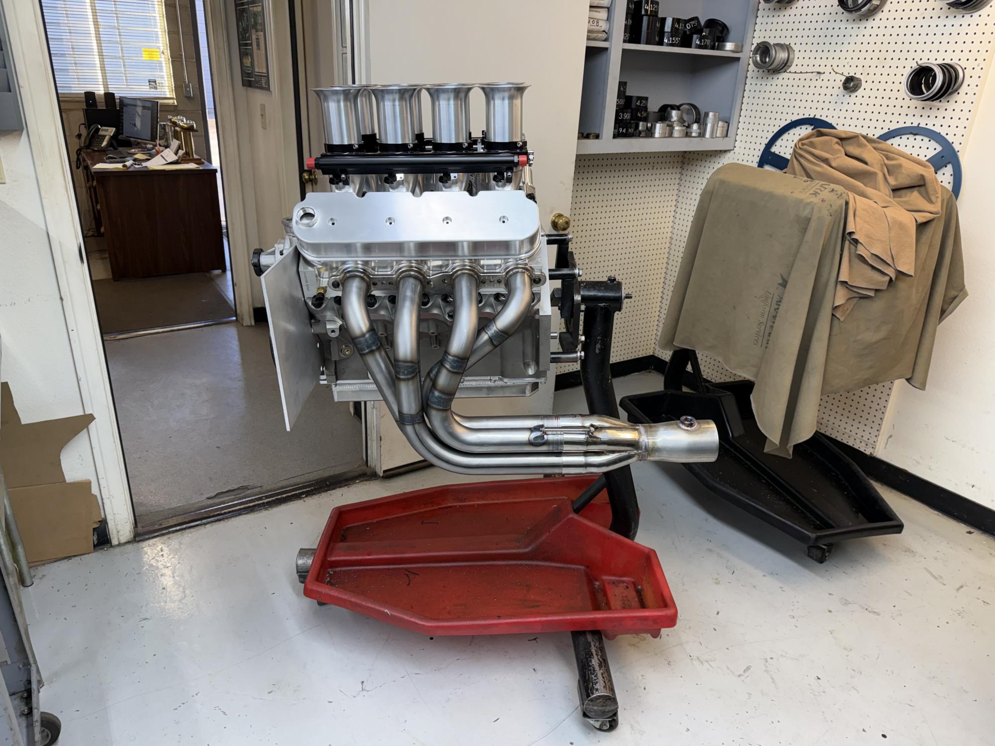

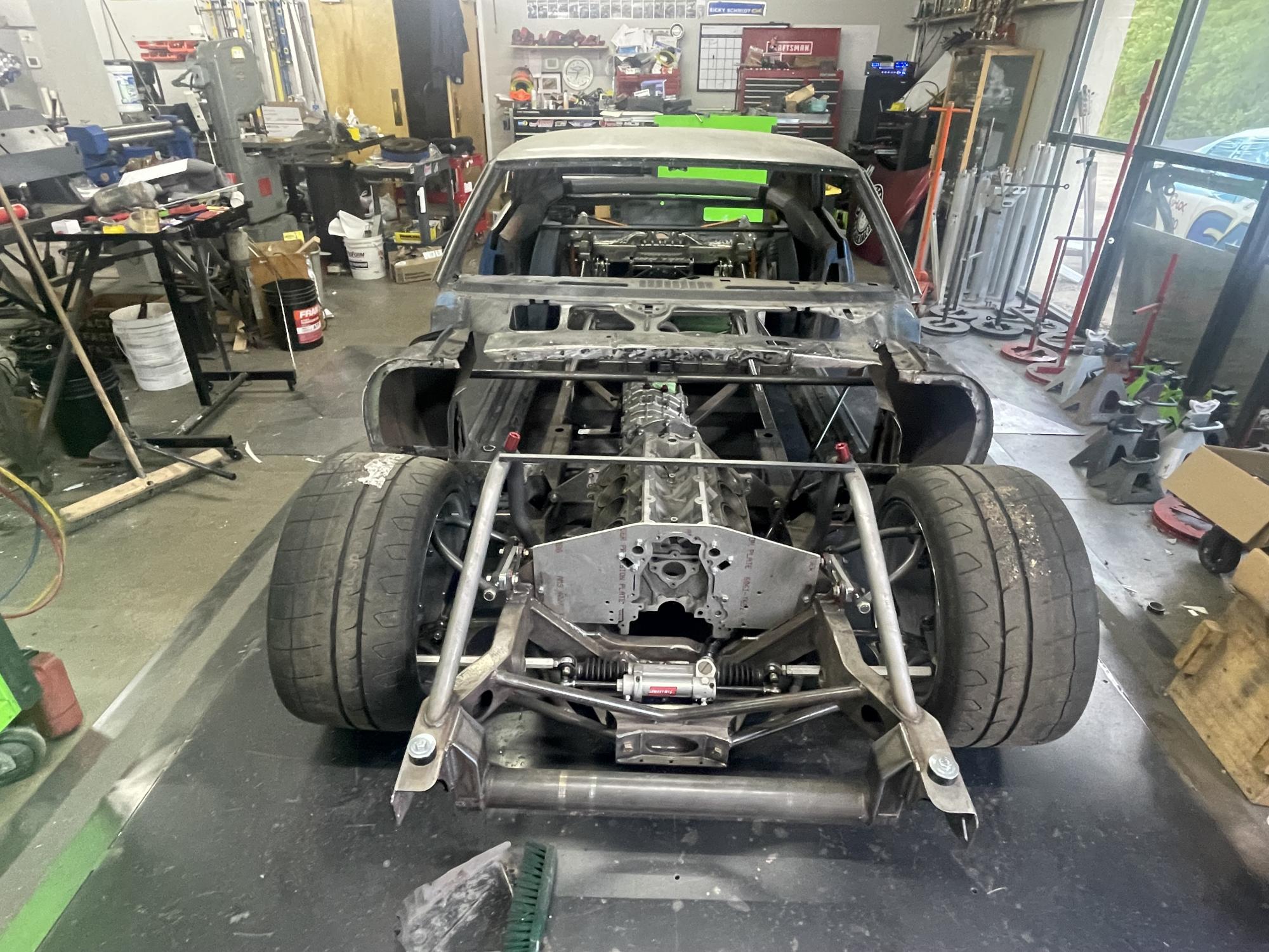

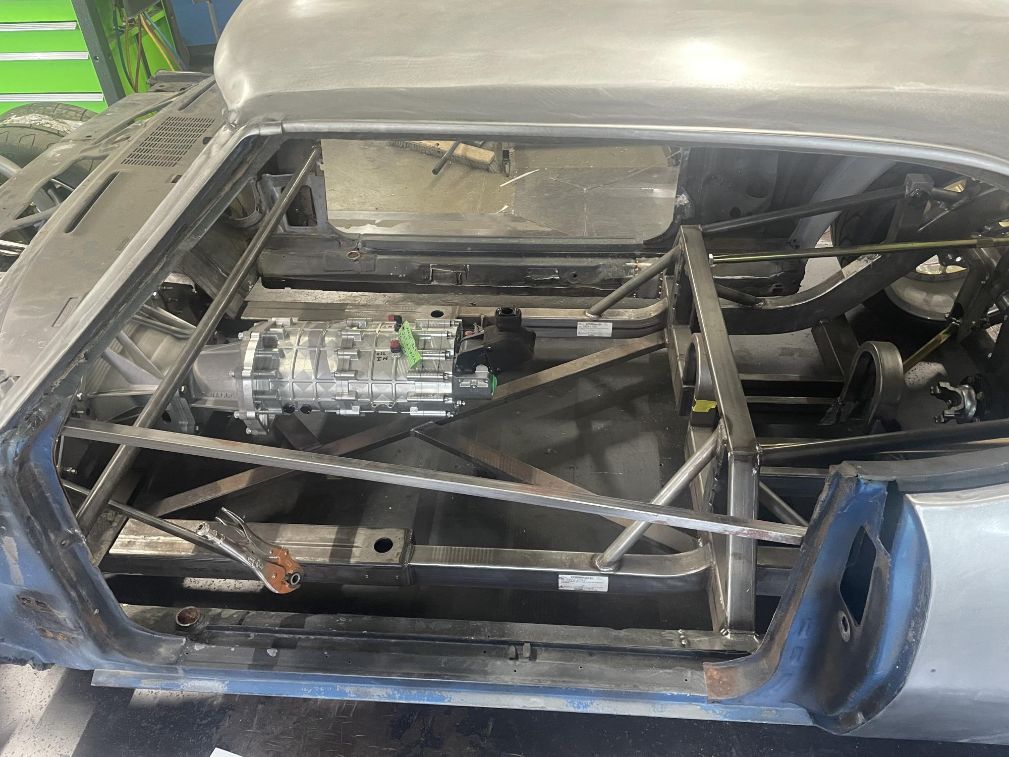

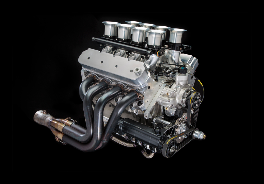

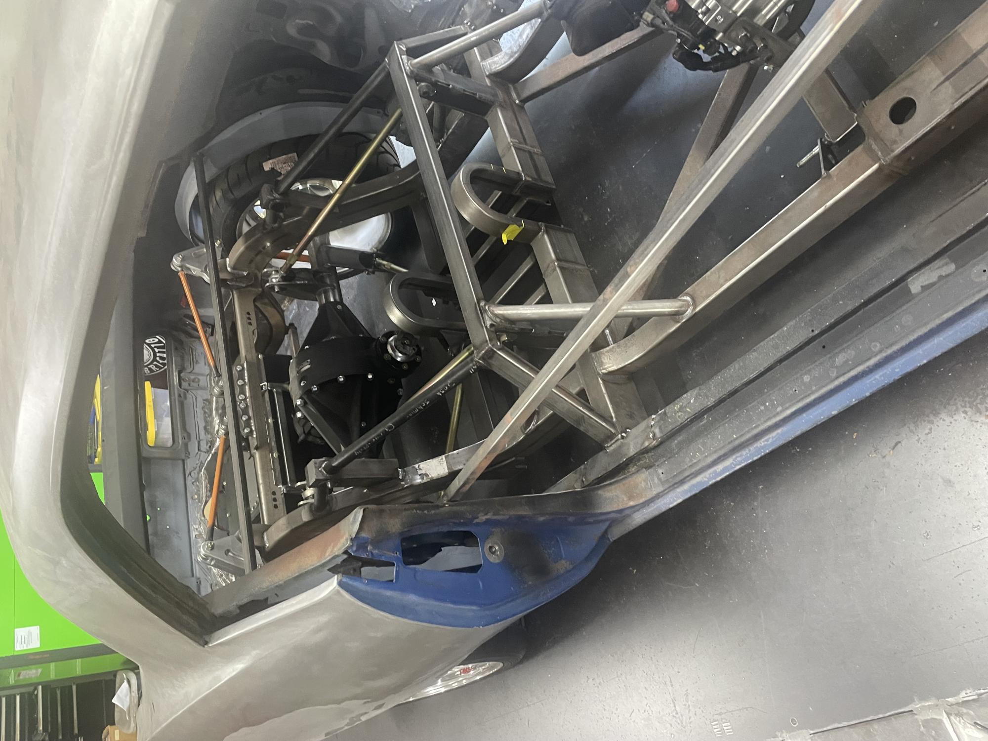

      Here are a few pictures of my build. This will be a CAM T and USCA car. The engine is a 434 CID LS which makes 975 bhp on race gas. The engine was built by Kenny Duttweiler. Details of the engine can be seen in this month's Race Engine Technology Magazine. The car has a 6-speed sequential transmission. The engine and trans are set back to make it front mid engine.
