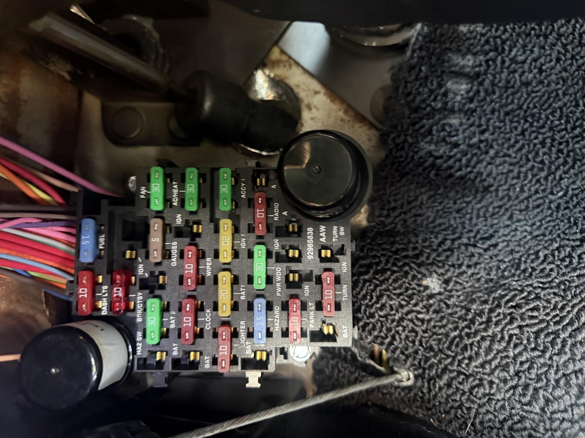

      I would appreciate any help anyone could give in this next step.
      Any videos on how to do this would be appreciated. Or something that would walk me through how to work on the terminal. This would be something new as I did not do this install of it.

      I would disconnect the battery, unplug the two bulkhead connectors under the hood, and unbolt the fuse block which will allow you to take a look at where the yellow wire terminates in the fuse block.

      Wiring looks and sounds harder and scarier than it actually is. With a little care and attention to detail, it's actually pretty easy other than it seems lke a lot of effort over a tiny little wire hidden in a bundle going who knows where. I would call https://americanautowire.com/ and tell them what fusebox you have, and ask them to send you a new yellow wire with the correct terminal ends on it. It'll probably just cost a couple of bucks.
      To remove the fuse box, I see two shiny silver bolts. If that doesn't get it there may be bolts underneath the round relays on either corner. Be careful moving it around, and be extra careful when bolting back in that you don't get any wiring caught under or around the bolts. You don't want to introduce new problems by fixing this one.

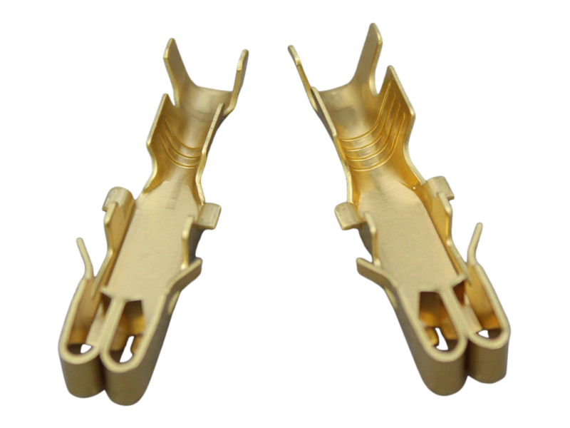

      The terminal look like this.
      It has little arms sticking out (you can see them in the picture, coming off at a shallow angle) that hold it inside the plastic box, and you can either get the correct tool or use a very small, thin flathead screwdriver to remove it. The tool you use will slide down the hole the terminal is in. Push the wire up a bit, then use the tool to push down the side to bend the arms in on each side, then it just slides out the back. Have the new wire with you when you pull the old one out. Don't just yank it out, but carefully slide it out. Pay attention to the terminal's orientation as it comes out, and immediately install the new wire in the same hole with the same orietation. It will go in the wrong way and if it does, it won't work correctly. Once the new wire is in you can run it along with the rest of them, then bolt the fuse box back in place.

      Yeah, but his battery wire is dead, not the ignition one.
      There is actually 2 yellow wires coming out of the fuse block on that same terminal. One is the clock feed. Does that one have power?
      Did you check the clock fuse? Because that is the fuse for battery power to the radio. The radio fuse is for the ignition power to the radio.

      This was it. It’s funny but not funny. I check all of the fuses and somehow missed this one. I went and bought a nice Klein tested. Did fuse testing on all of them I thought.
      Just pulled it out and it’s fried.
      Thanks everyone. Yall were great.
