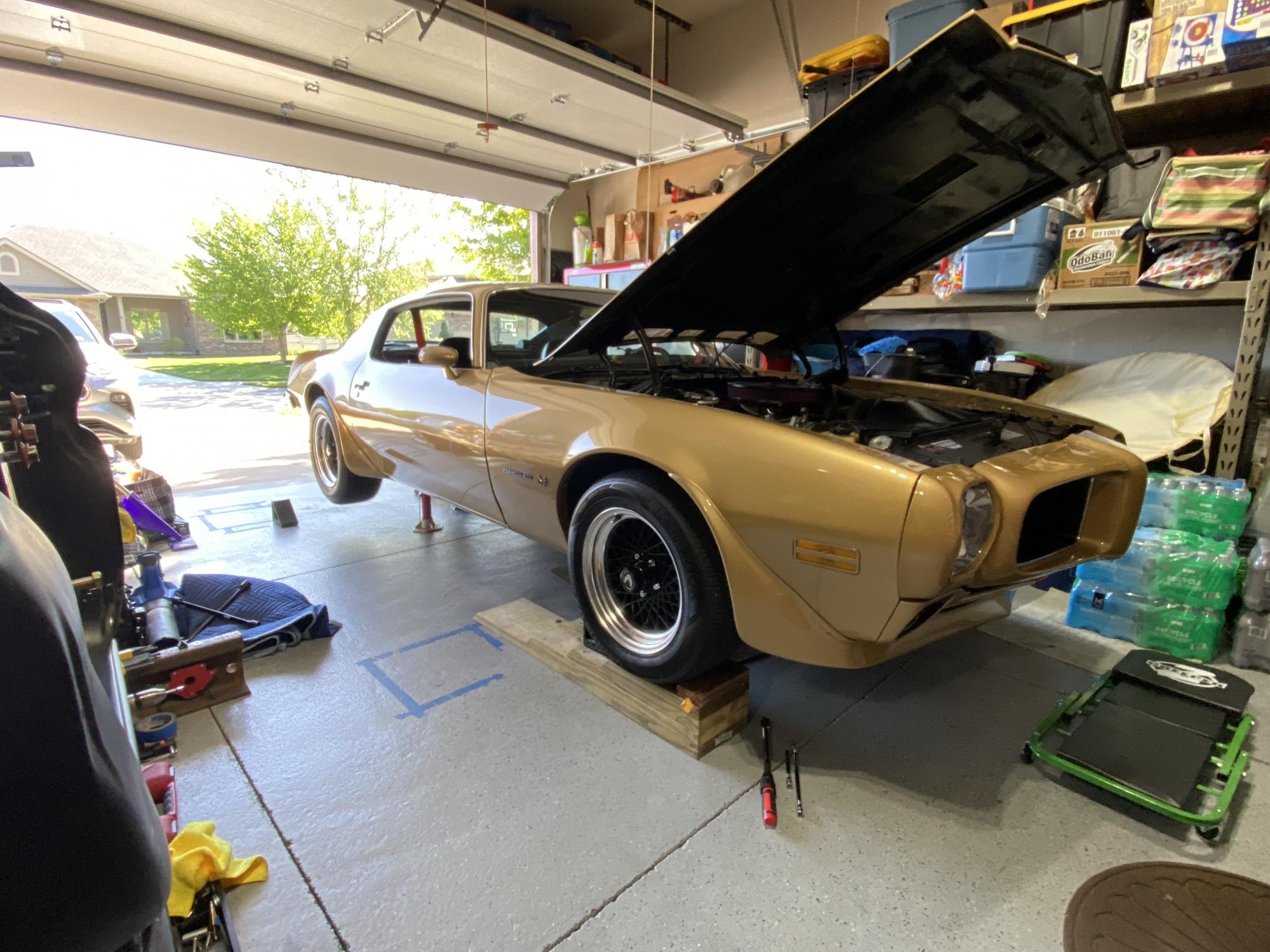

      The Car... I bought a 1973 Pontiac Firebird Formula 350 (VIN verified). It had already had some modifications, such as a 1978 W72 400 and the car was painted 'Gold' to match other cars in the guys collection.
      Why this car? I wanted a car that was extremely clean (no rust or very minimal at worst) and I just wanted a fun cruiser to take the family out in.

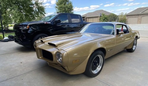

      Did I mention that the car was repainted Gold? The original color of the car was Navajo Orange (which can still be seen in certain areas of the car). It isn't even a "real" Gold car... FooL's GOLD is getting pretty ingrained in the persona of this car!
      Well, at this point, I needed to figure out what to do with the car. It was absolutely going to need motor work. It needed at the minimum new springs (the shocks were aftermarket, but don't know how old they were). And I started to question what else might I need to work on at this point. I did some shopping around to look at all my options. Contacted a few builders, one was excited but then never heard back. One said sure, but he was years out. Another said absolutely, and we could start in a few months once he finished another project to get room in the shop.

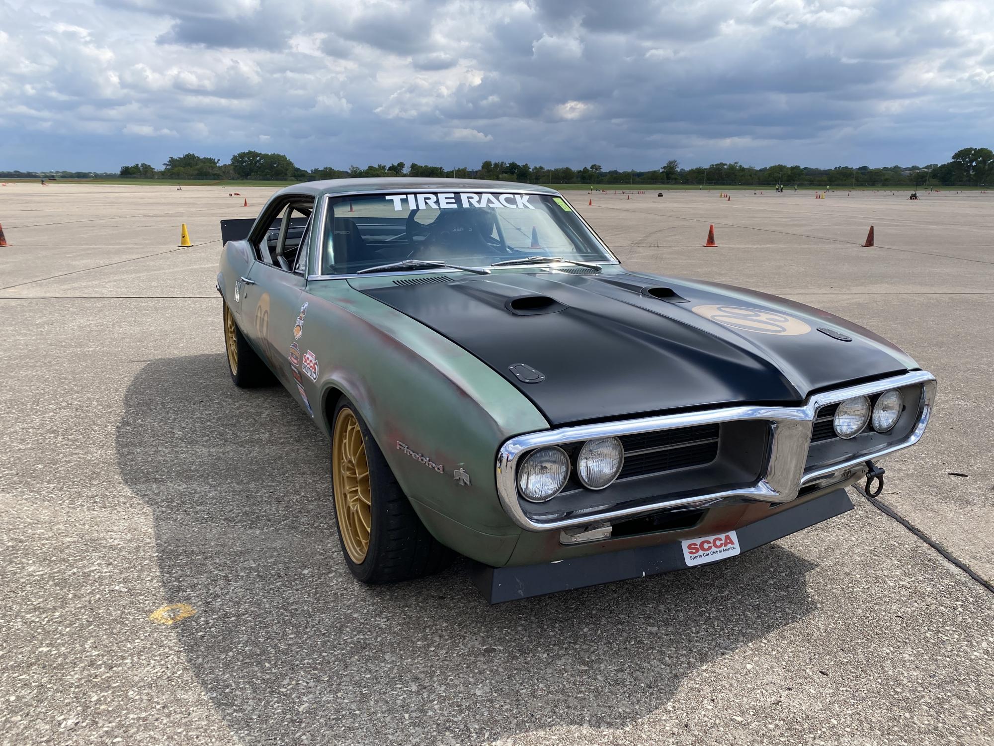

      A year later... I raced with a guy who owns and built a 1967 Firebird Pro-Touring car for CAM-T.
      He offered to help me out and let me build my car in his shop! A little over a month later, the car made it to his shop and the build began. But, before a "build" can begin, a tear-down must happen. So my plan was in place, lots of parts were purchased about 2 years before the tear-down started, many more parts have been purchased in the last 4 months. This project, even when doing it ourselves, is already going to surpass more than I ever thought I would have put into this car when I originally bought it. I just jumped down the proverbial "mine shaft" and FooL's GOLD is what I am working on... the question is, when it is all said and done, will this car be worth its weight in gold, or will I just be another fool with a really cool but expensive car?!

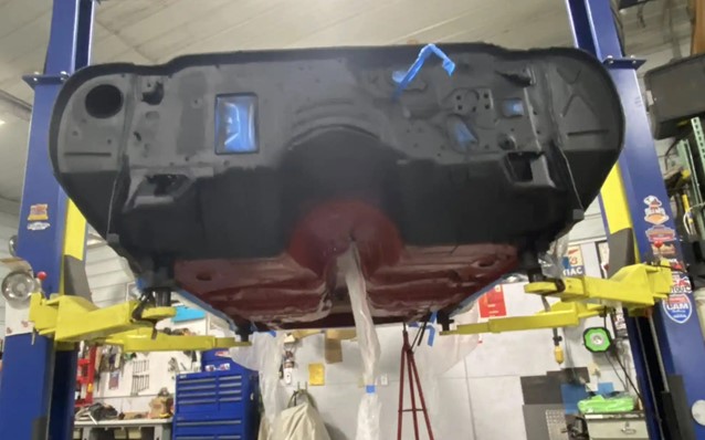

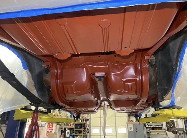

      Cleaning the underside...

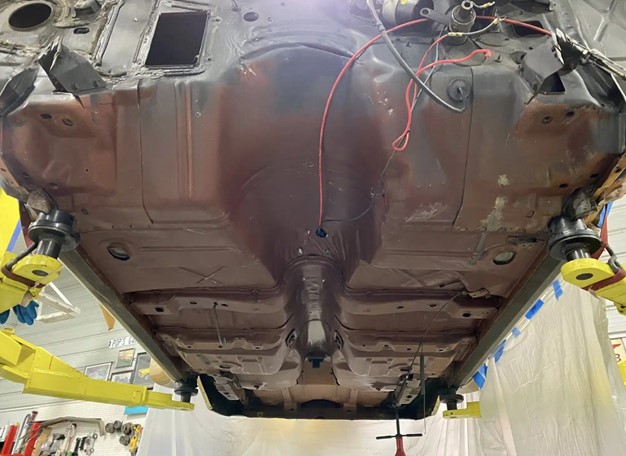

      So after we tore down the car, we cleaned everything off the best we could (Motor, Transmission, Stock Suspension, Rear axle, etc.)
      Attachment 219989
      Attachment 219988
      Then it was time to clean the underside of the car...
      Attachment 219987
      Attachment 219986

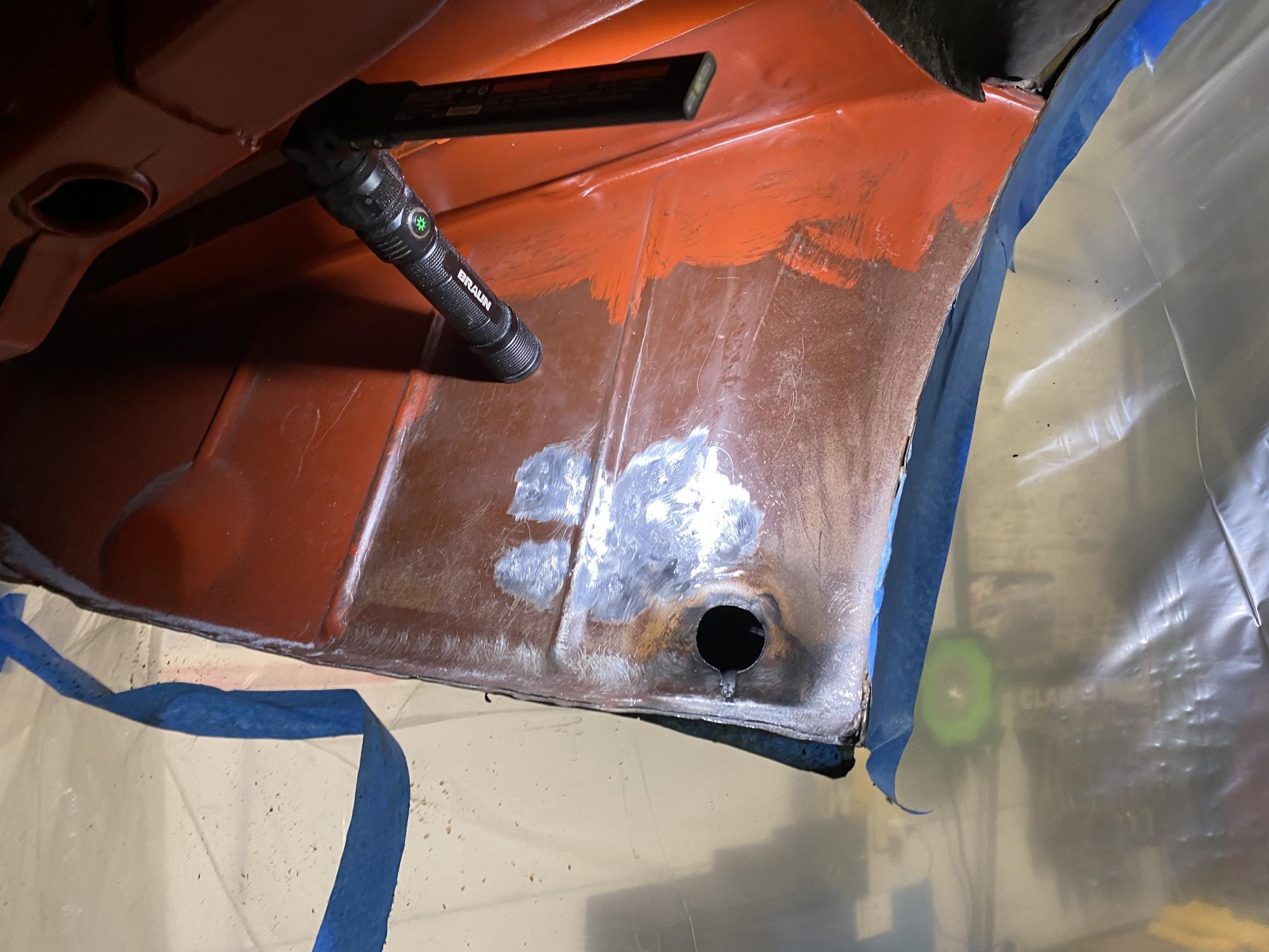

      I was extremely happy with how clean the underside of this car was. There was one small rust hole directly by the drain plug in the back driver's side corner (behind the rear tire, inside the rear wheel well) that was an easy fix. The underside of the car still had the factory oxide red under-coating (from the dip bath applied during assembly). I purposely looked for a car that had zero aftermarket undercoating so I could see if the bottom of the car was clean. I've looked at too to many cars that had either massive amounts of rust forming and flaking off those thick under-coatings or worse, people using those thick under-coatings to hide problem areas from potential buyers! The proverbial 'lipstick on a pig' fix!

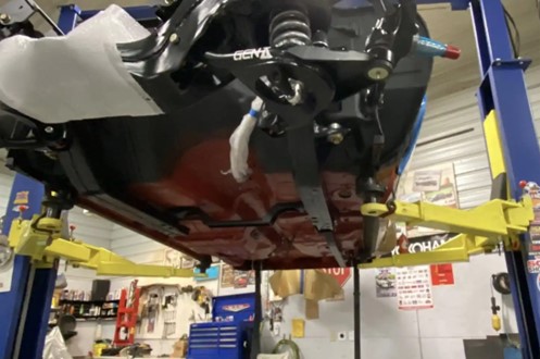

      But after taking lots of pictures and video of the underside of the car throughout the cleaning process (took a few weekends to get it done!), I decided to give it all a new coat of "oxide red" to protect it for many more years to come. I must say, with the amount of oil under the car, I think that is the number 1 reason why no rust ever formed under this car!

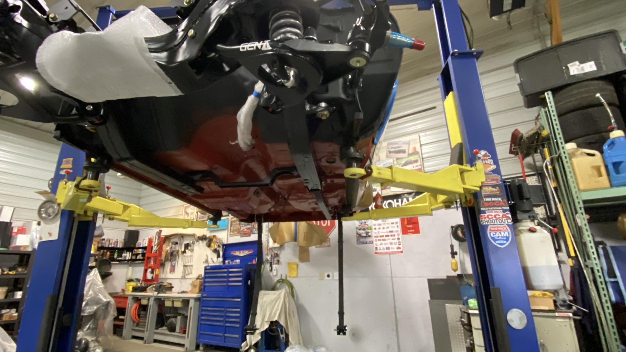

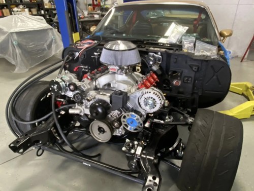

      With all of the metal taken off of the front of the car, I disassembled all the removable parts and hardware from the radiator support and fender liners and took them to get powder-coated near where I live.
      (yes, everything is getting powder-coated, some small stuff is getting painted, but everything is getting done!)

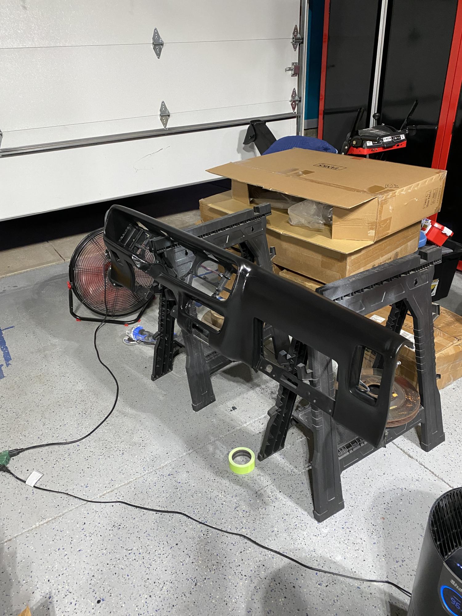

      I also was doing other stuff that I could do in my home garage, like repair all the cracks in the dash pad:

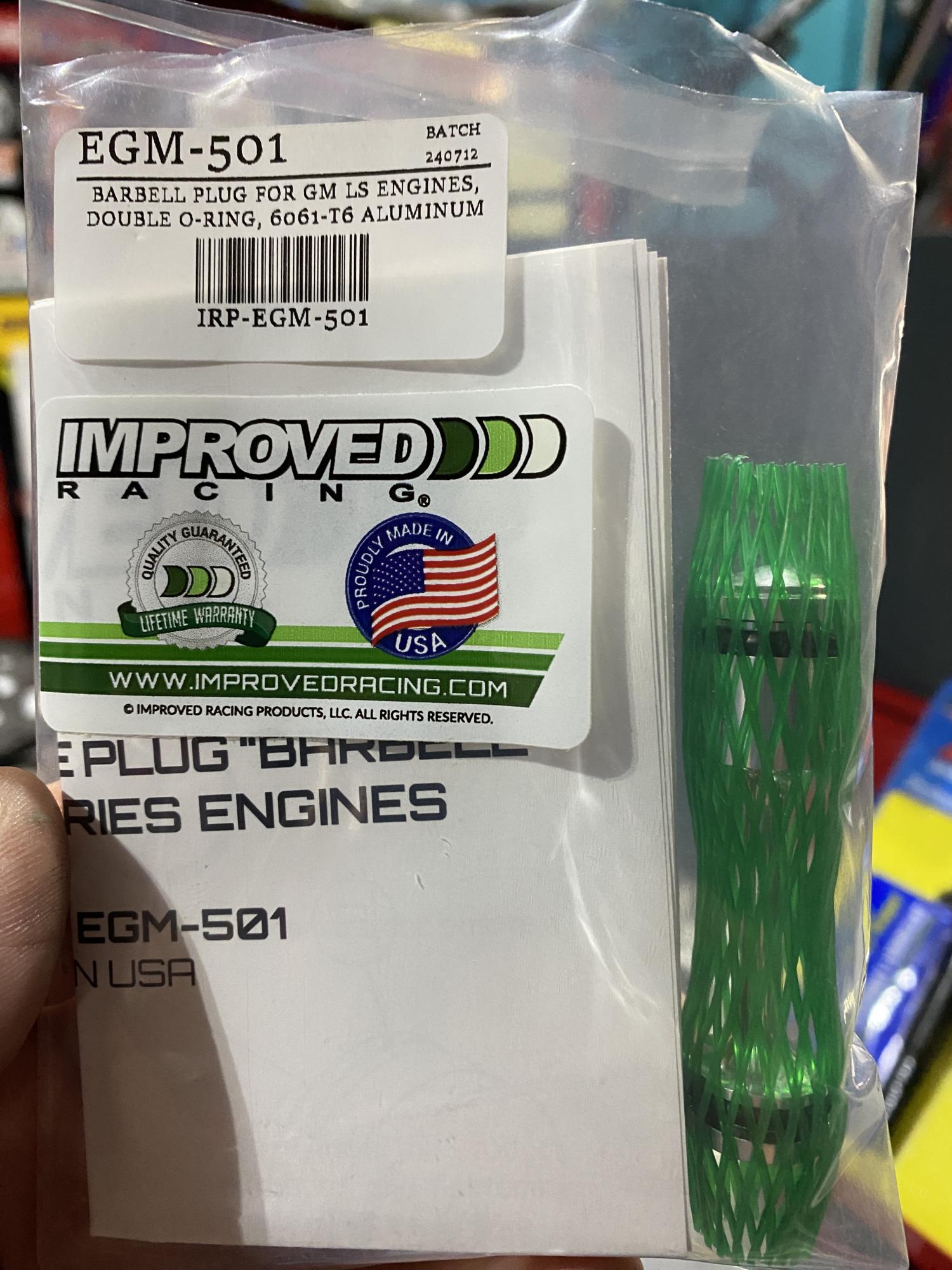

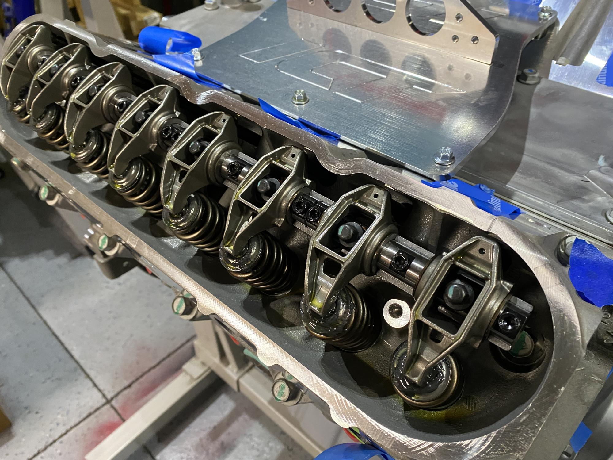

      Some reliability mods in the LS3 (Baffled Oil Pan with new oil pickup tube bolted on both sides, Improved Racing Windage tray and barbell, BTR Shaft Rocker system, Melling Oil Pump, FelPro Gaskets, etc, etc, etc.)

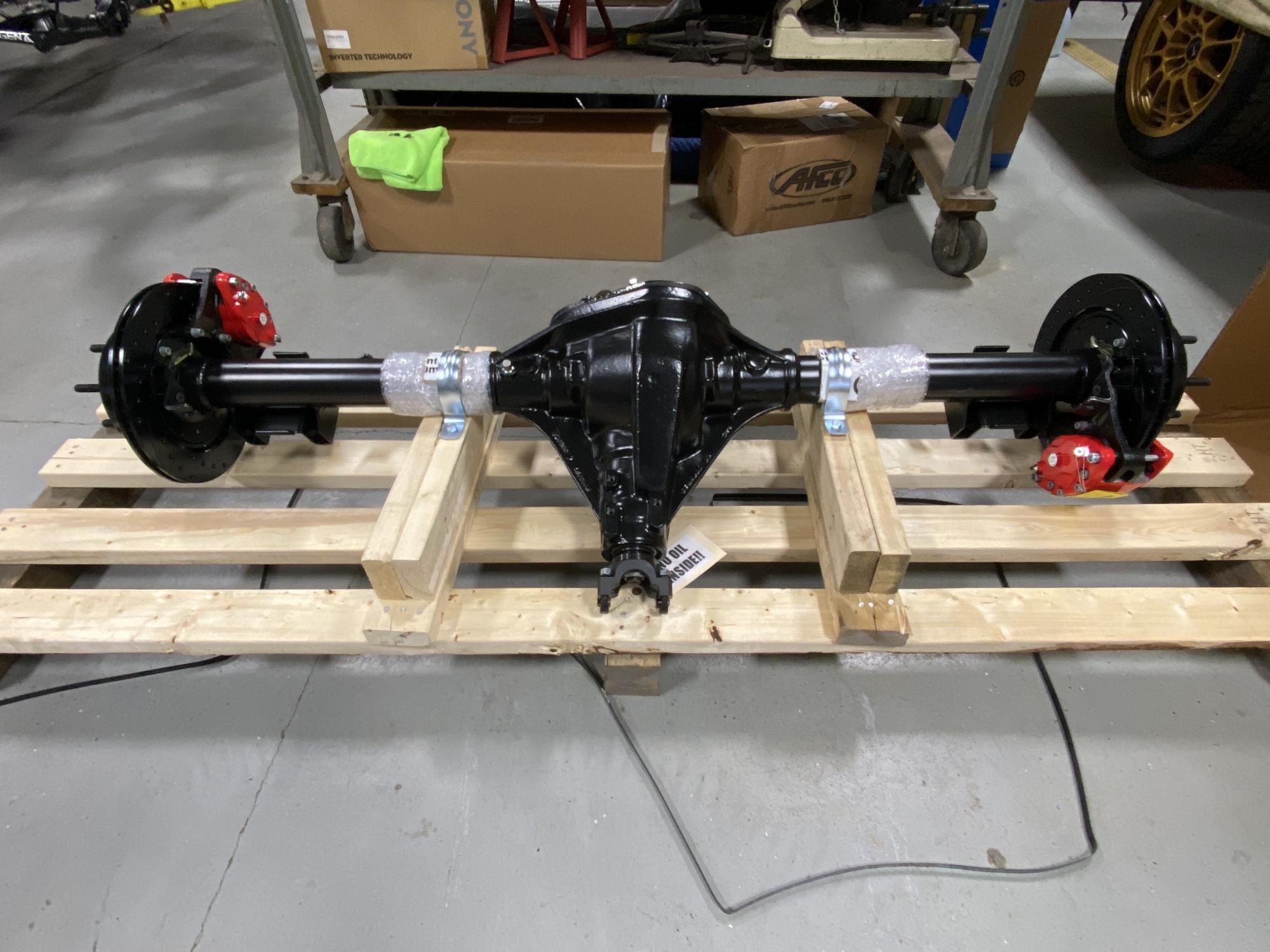

      We took a lot of measurements of the factory 10-bolt, and then I contacted Strange Engineering and worked with Ryan on getting what was going to best work with me on the build.
      I ended up going with Strange's S60 with 3.73 gears and their own style of True-Track.

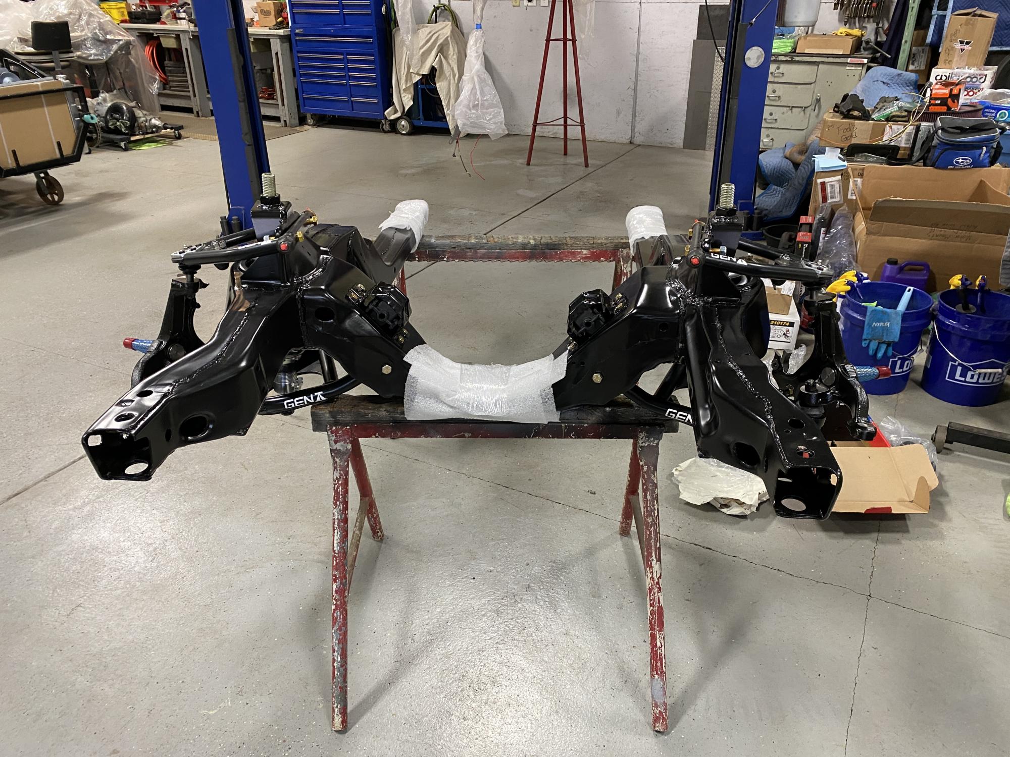

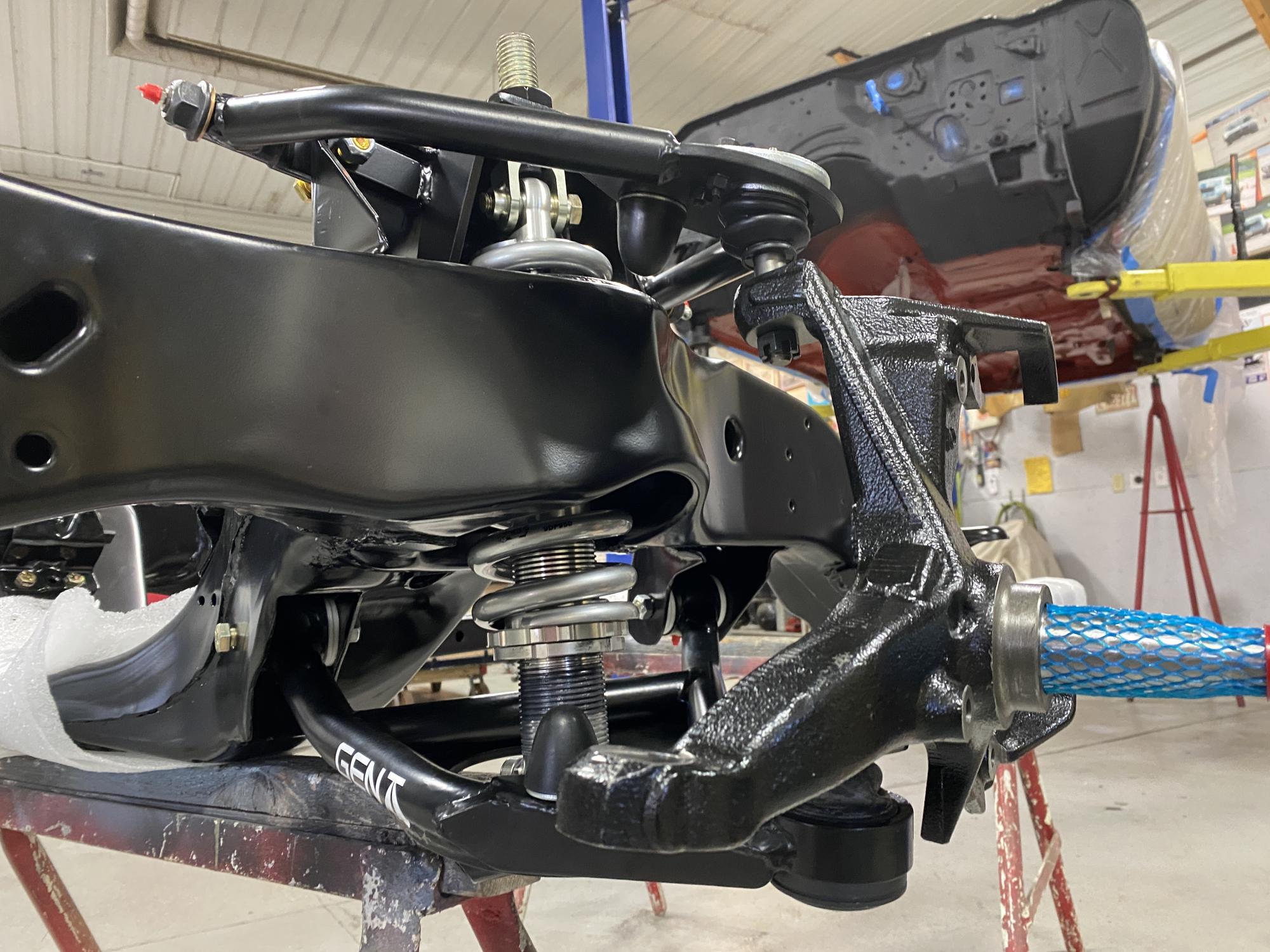

      We took the subframe and cleaned it up. Bill cut out the pockets and welded in the Pro-Touring F-Body Coilover tophats and stitch welded the rest of the subframe. I spent a lot of time cleaning the "pounds" of factory weld spatter off of the subframe to prepare it for powder-coating!
      Hot Kote in Lincoln, NE, did the powder-coating on the subframe.
      Now, before I had even purchased anything else for his car, I done a lot of research on which way I wanted to go when it came to replacing the springs (remember, 50 miles prior to the spun bearing.)
      I went back and forth between coilover setup, 4 link, torque arm, replacing stock, upgrading stock style... when I came upon Pro-Touring F-Body.
      At this point I wasn't considering full out ProTouring build, just a capable and fun cruiser that might go to an occasional autocross.
      After speaking with Dave, I figured the setup he was providing would perfectly fit the bill, as it would give me exactly what I wanted, allowing for height adjustments, but still looking essentially stock.

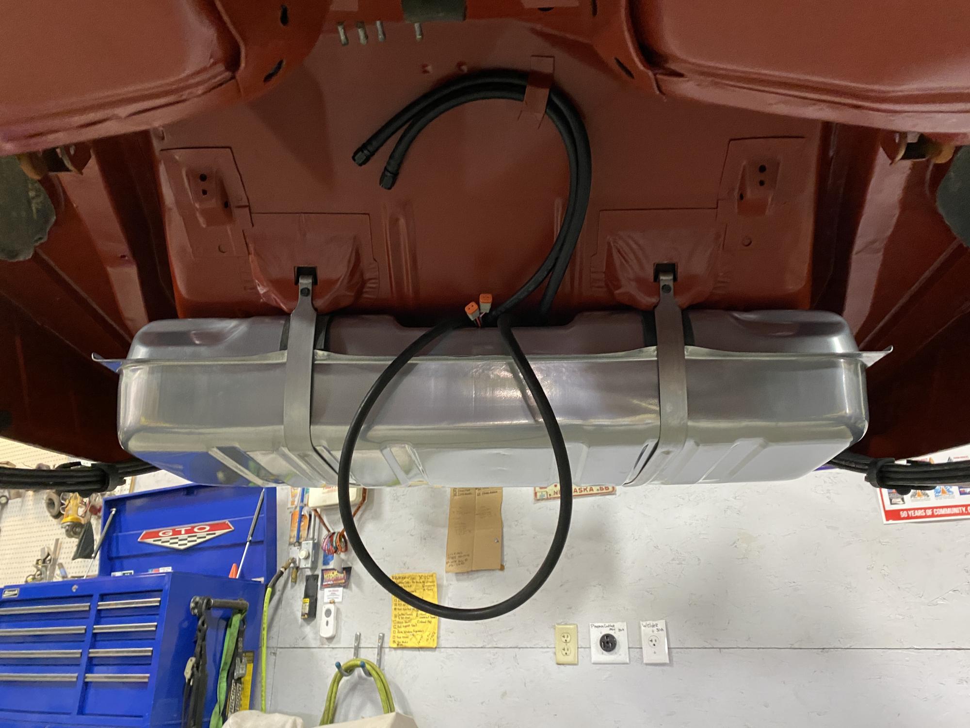

      Also called up my neighboring state (IOWA) and ordered and installed a Tanks Inc EFI Baffled fuel tank along with their kit:

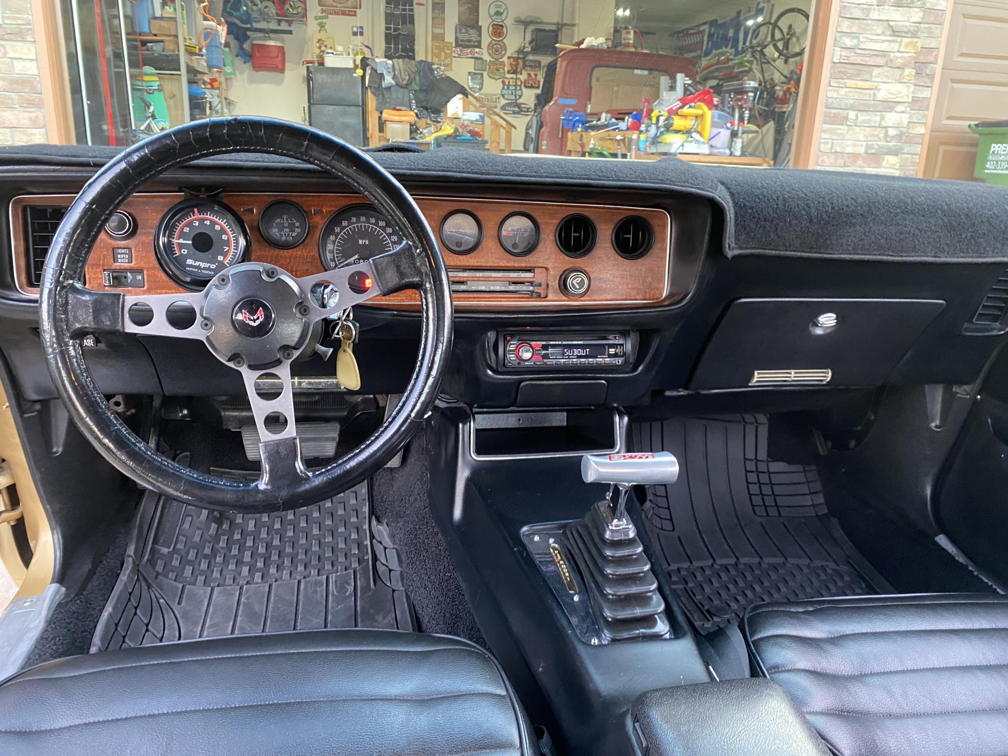

      So while doing all of this, I need to make sure the car will always have a 'Manual', so I am making a build manual along with wiring diagrams and part numbers... nothing worse than buying a car and not knowing what is what or where to even go to try and find a replacement part! So, I like making one of these and also storing all photos and build videos... data overload?! Maybe...

      Love that manual! Nice touch.

      I bevelled out all the cracks, removed all hard vinyl, suprising enough the foam under the vinyl was really spongy and soft. I used Polyvance and SEM products. A lot of layering, sanding, time, patience, until it looked and feels like a normal dash pad.
