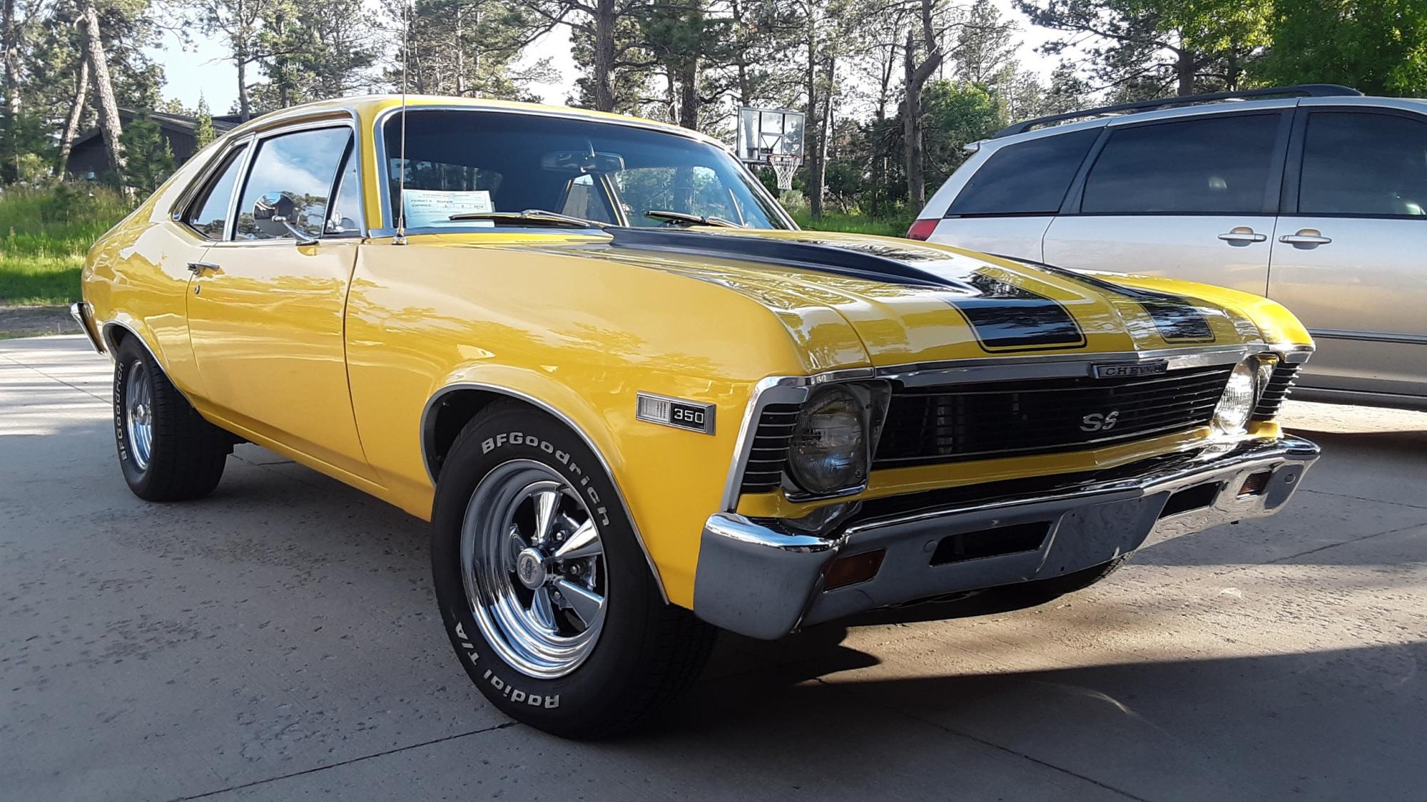

      Hello there. I'm new to the forum and am wanting to be able to bounce ideas and ask for advice on a pretty serious build I'm doing on my 68 Nova. The picture attached is the day I got it home after buying it. This was in the summer of 2019. Shortly thereafter, the main seal went out and I decided to upgrade it from the installed 307 to a Blueprint 383 stroker. Then I wanted to upgrade the suspension and perhaps repaint it to something a little more original, as there are probably three yellow Novas in Rapid City, SD, where I live. I ordered a TCI full tube chassis and went to work dismantling the car. Unfortunately it didn't take long to find hidden rust, courtesy of the bonehead who "restored" and painted it before I bought it. After finding rust throughout the floorpan and firewall, I decided to do a full blown, off the charts (for me, anyway), restoration and modification. Name:  Resized_20190625_184901.jpg
