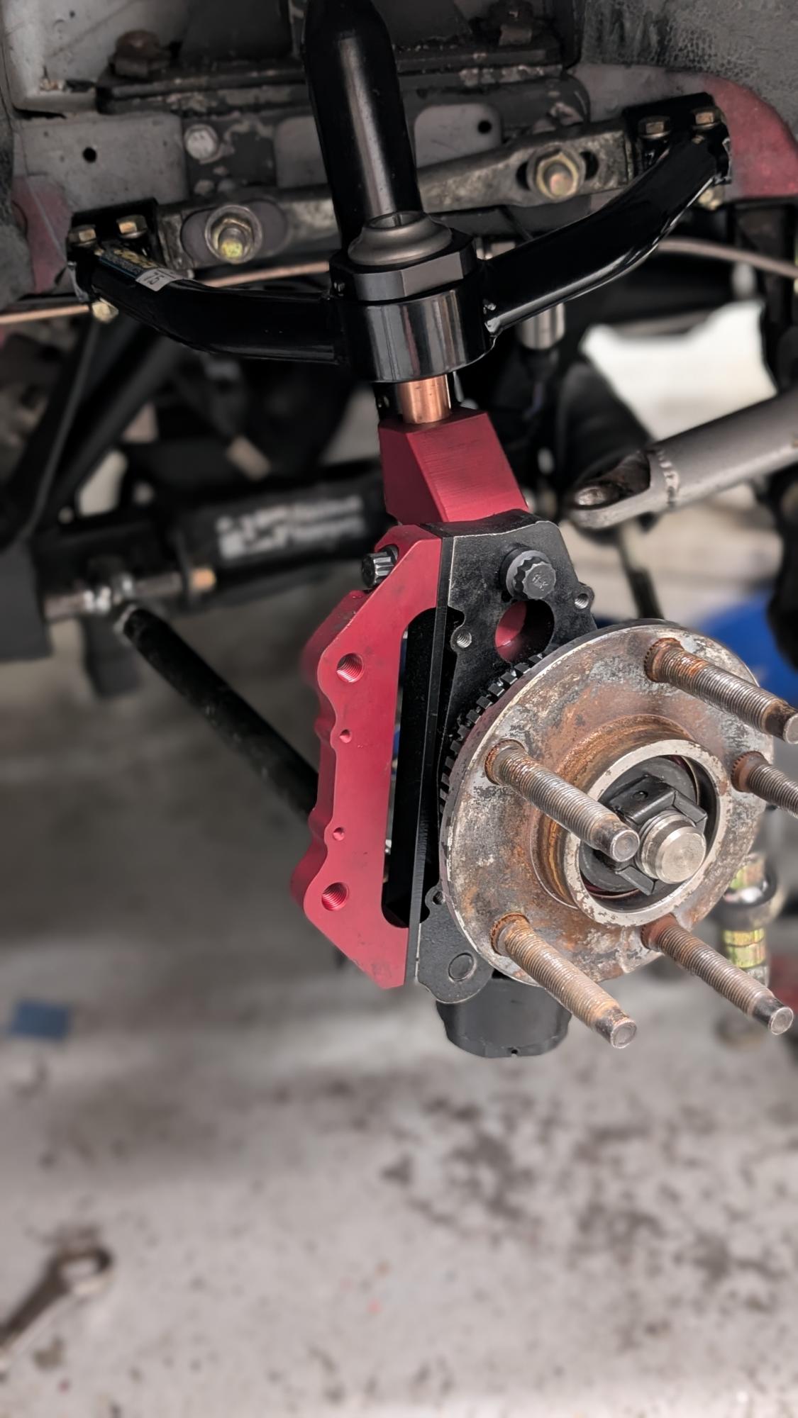

      For the past month I've been upgrading the front suspension. I'm changing the stock SN95 spindle with Griggs upper adapter to the Mod Squad Garage spindle. A proper double wishbone spindle with proper geometry.
      Some changes I've had to make to:
      Longer upper control arm
      0.5" extended K727 lower ball joint
      0.5" extended K772 upper ball joint
      New coilover upper brackets
      Wilwood brakes and rotors

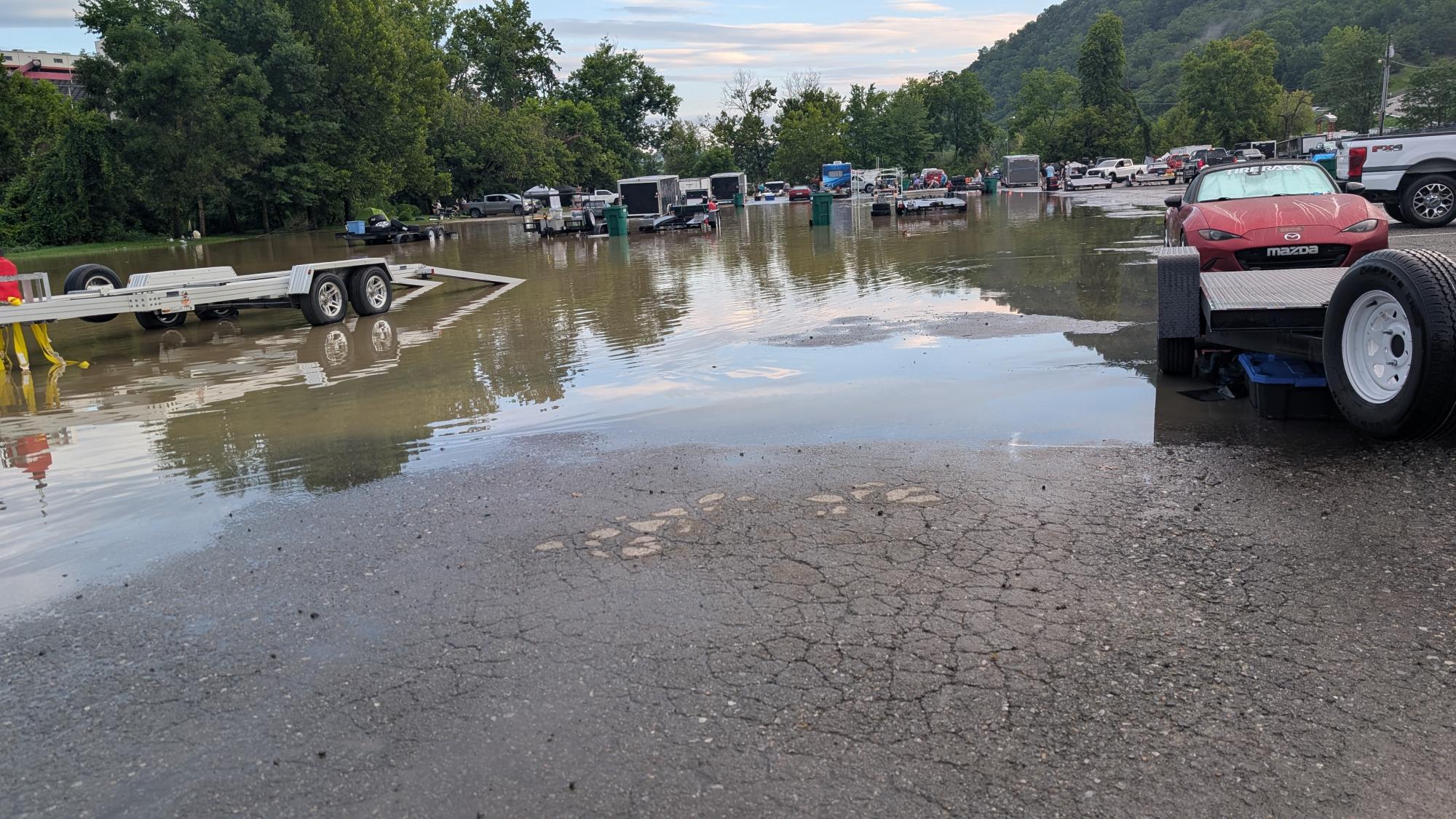

      Overnight there was a heavy thunderstorm. I went out around 1am to check on the canopy and stuff around our site. The amount of water running down the hill and through our site was unreal. I had just waterproofed the canopy and with trailers on 3 sides everything was pretty stable and dry. I parked uphill, mainly because it was one of the only spots left. Looking down by the creek it looked like there was water but it was dark and I couldn't tell the full extent. By morning light there was a lot of commotion as the creek water has been rising. There was about a foot of water in the low areas. People had tires and other belongings that floated away down the creek. We were lucky and had no damage. Lesson learned park uphill.
      Not only was lower paddock flooded, a portion of the course was also flooded. They had to change the course slightly and reduced our runs from 3 to 2 to beat another incoming storm. If that wasn't enough of a challenge there was also a water patch flowing through the middle of the course that you had to cross twice. It was being fed from uphill and never dried even for the 5th heat in full sun.
      I pushed a little too hard on my 2nd run through the wet patch. The car didn't turn and I hit a cone. I continued to push on the rest of the course cause you never know. There was a lot of spins, slides, and upsets. Overall, I stayed in P4 behind the Camaros.
