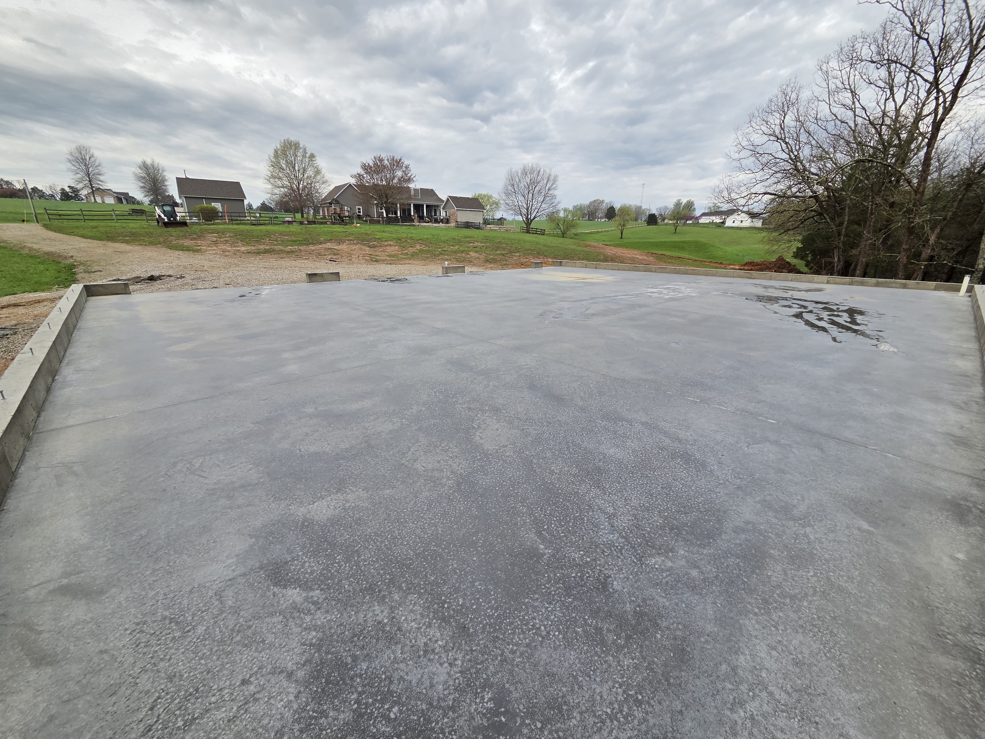

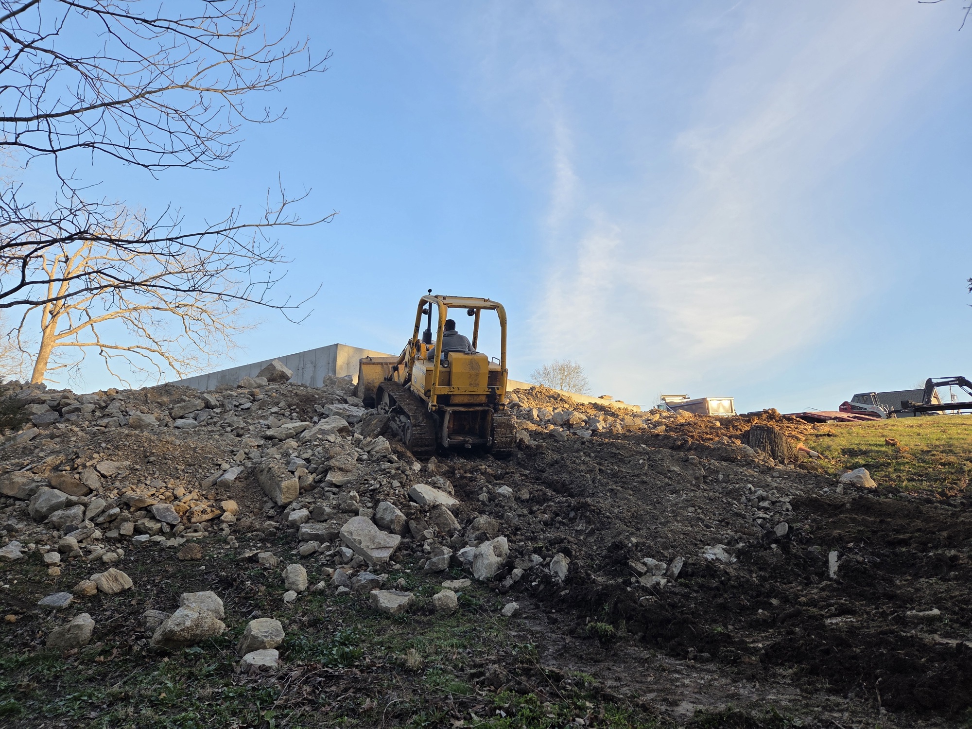

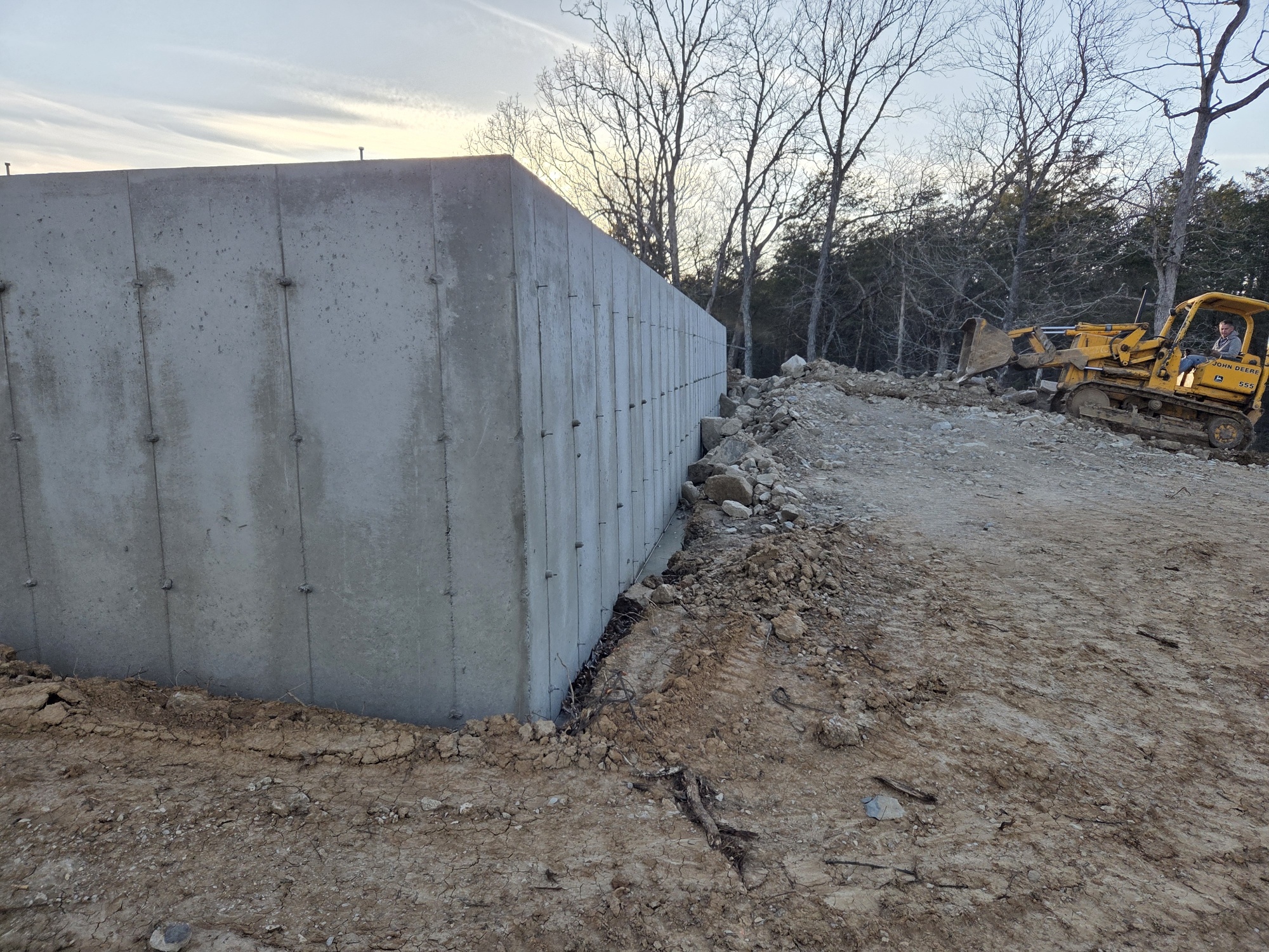

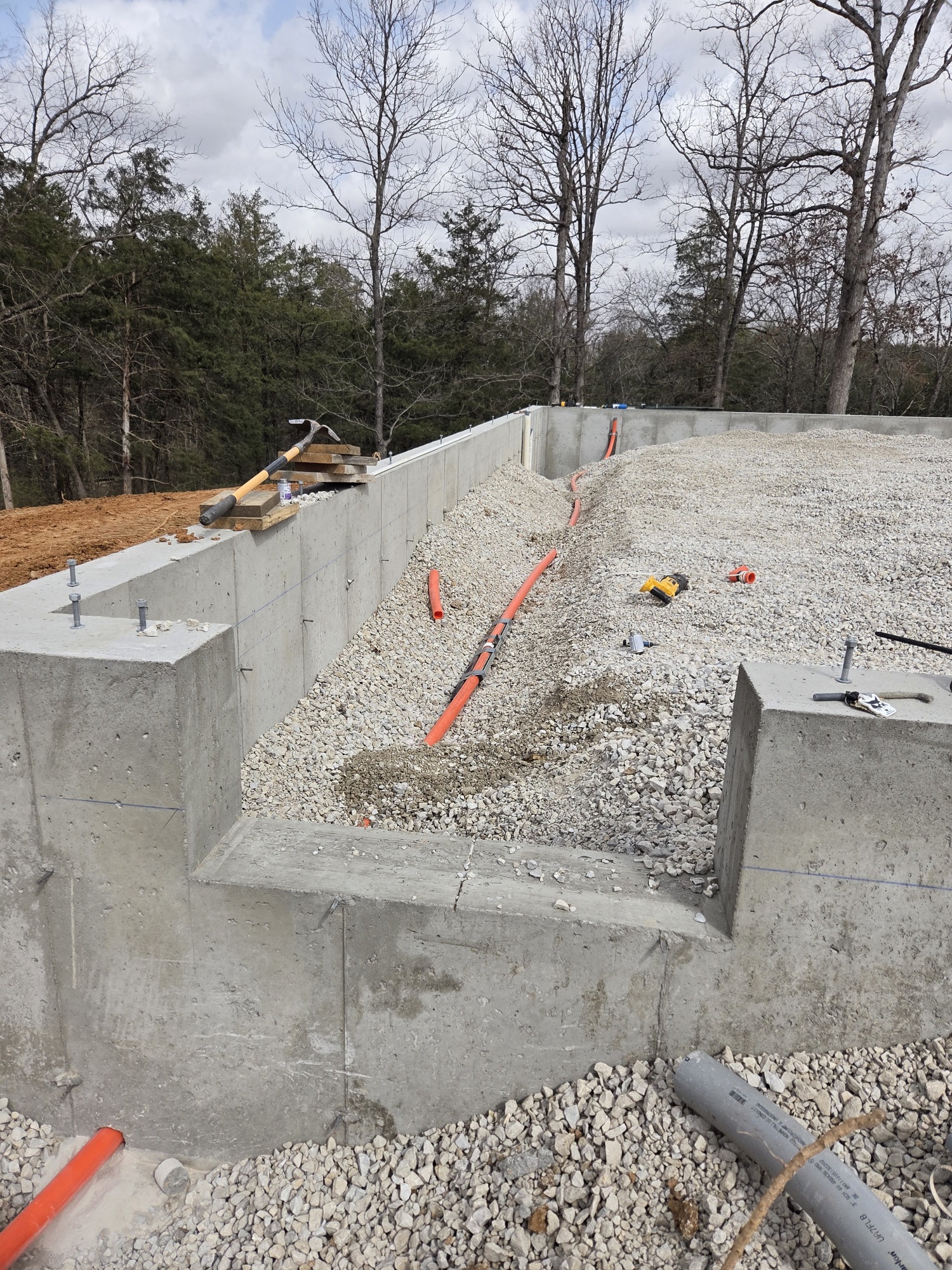

      Concrete:

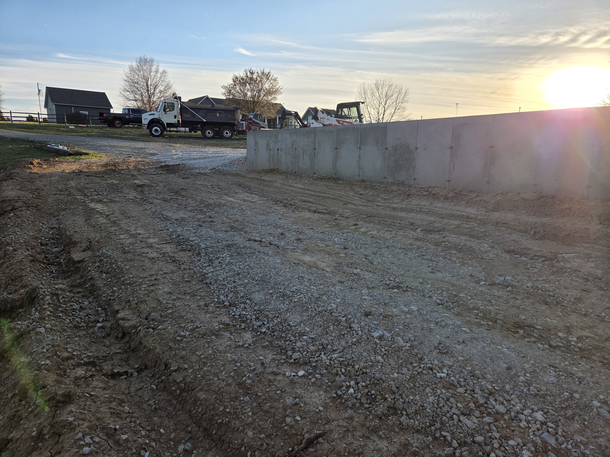

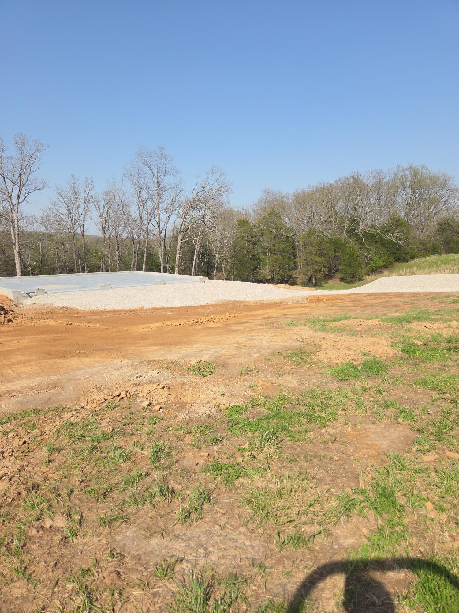

      Based on varying elevation, it was tough to get the size I wanted. It required 9ft of fill in the back corners and sides. The contractors did a 9ft wall, and I ended up backfilling all but about 2 feet of this to make it look more natural. Between my dad hauling 40ish tandem loads of rock in and both of us pushing dirt from the field nearby for 8 hours each, it turned out pretty good.
      The floor is 5" thick with rebar on 2' centers. I did not do heat in the floor. It was pretty straightforward, but did run plumbing beforehand for the floor drain (3") and a 4" for septic if needed. Both run out the side about 3' down below ground level. I will tie into this later.

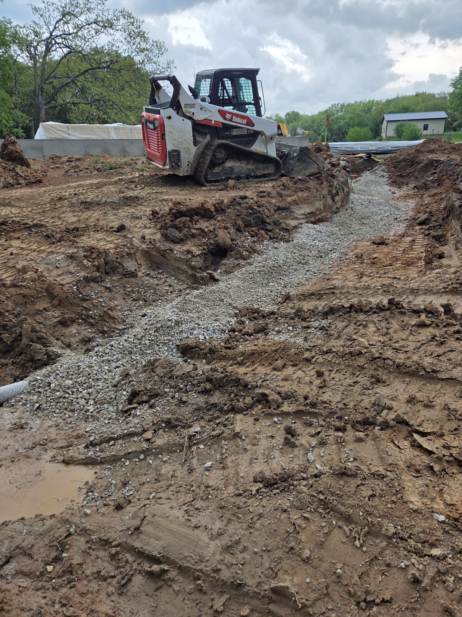

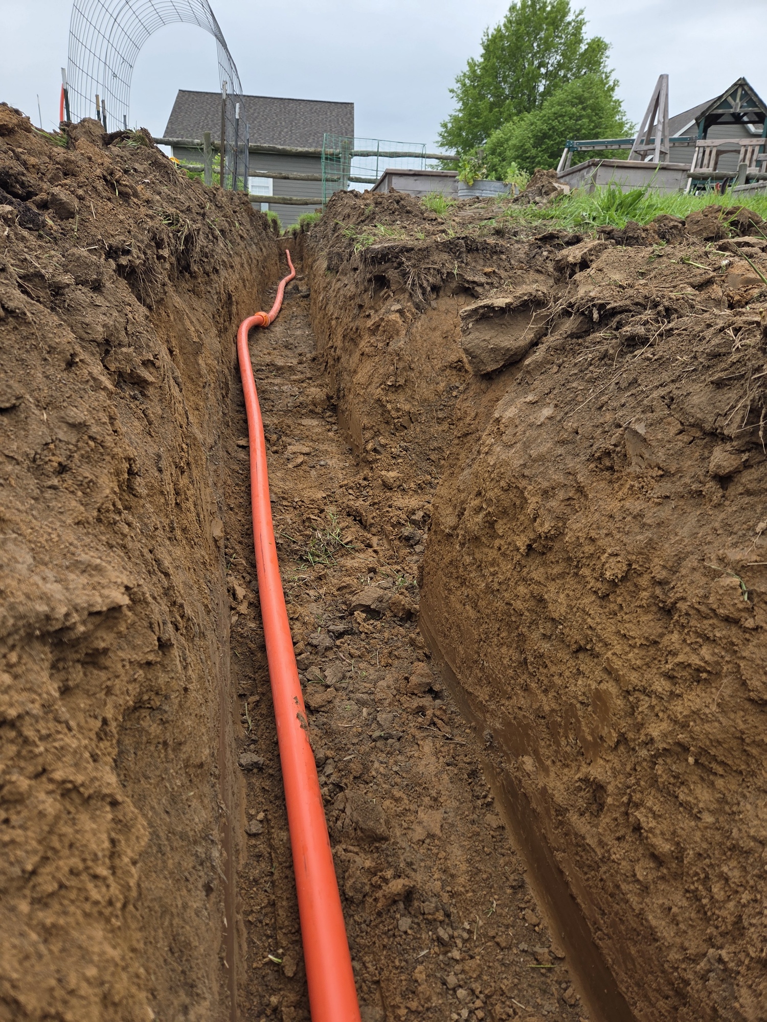

      Plumbing:
      3/4" PEX was ran from the house down to the area (220' or so), where I split and added a frost proof hydrant outside and split to run a line through the concrete to the back corner for a simple 5'x5' bathroom.

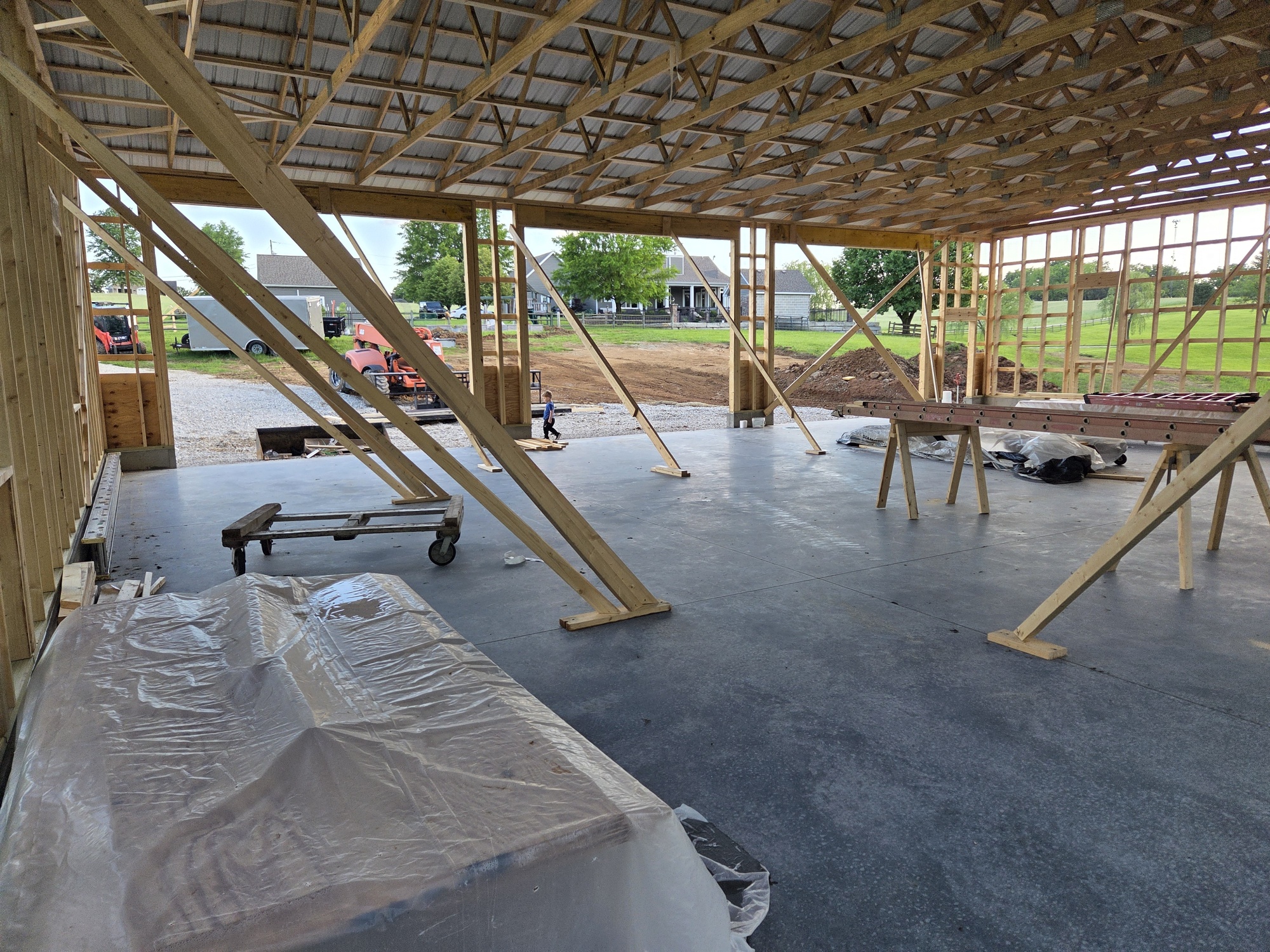

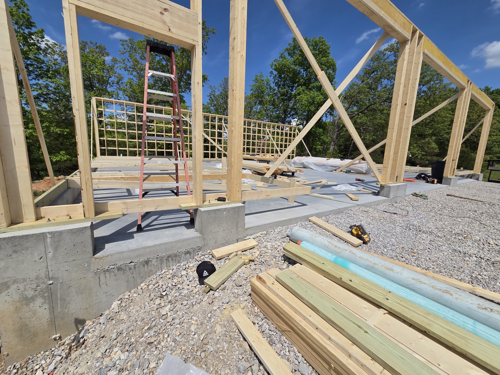

      Building:
      I won't have anything to do with this part. Definitely something best for me to leave to the pros than even attempt. 2x6 construction with 2x6 over 2x6 trusses (3-1/2:12 pitch) with metal tin roof and walls.

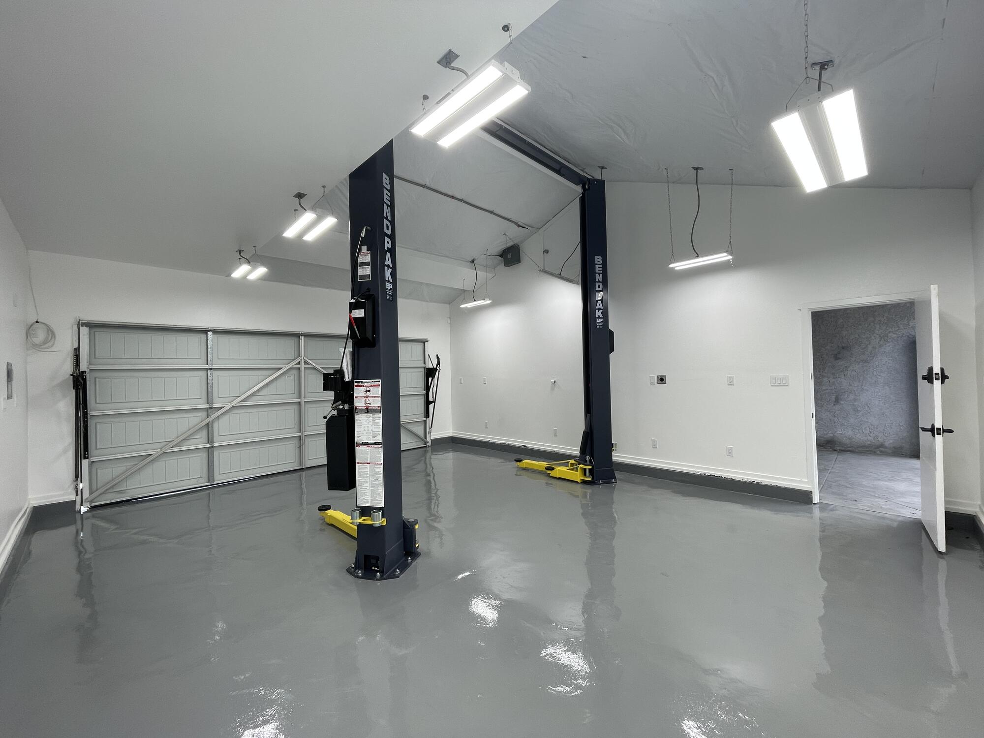

      As long as we are talking about lighting.
      I can't tell you how happy I am with what I did. They are LED's and can use a 0-10v dimmer that I added to my home automation. I can turn them up or down with voice commands.
      Everyone who walks into my garage when the lights are all the way up has almost the same reaction. Holy S!
      They are bright enough that with a car on a lift I don't need any extra lighting under the car except into the deep crevices.
      I have 9 of these LED 2' WILDCAT 110 Bay Shop Light 14,300 Lumens from Primelights.
      When you walk into the garage after having been outside in dark it's almost painful for a moment when they are at 100% brightness

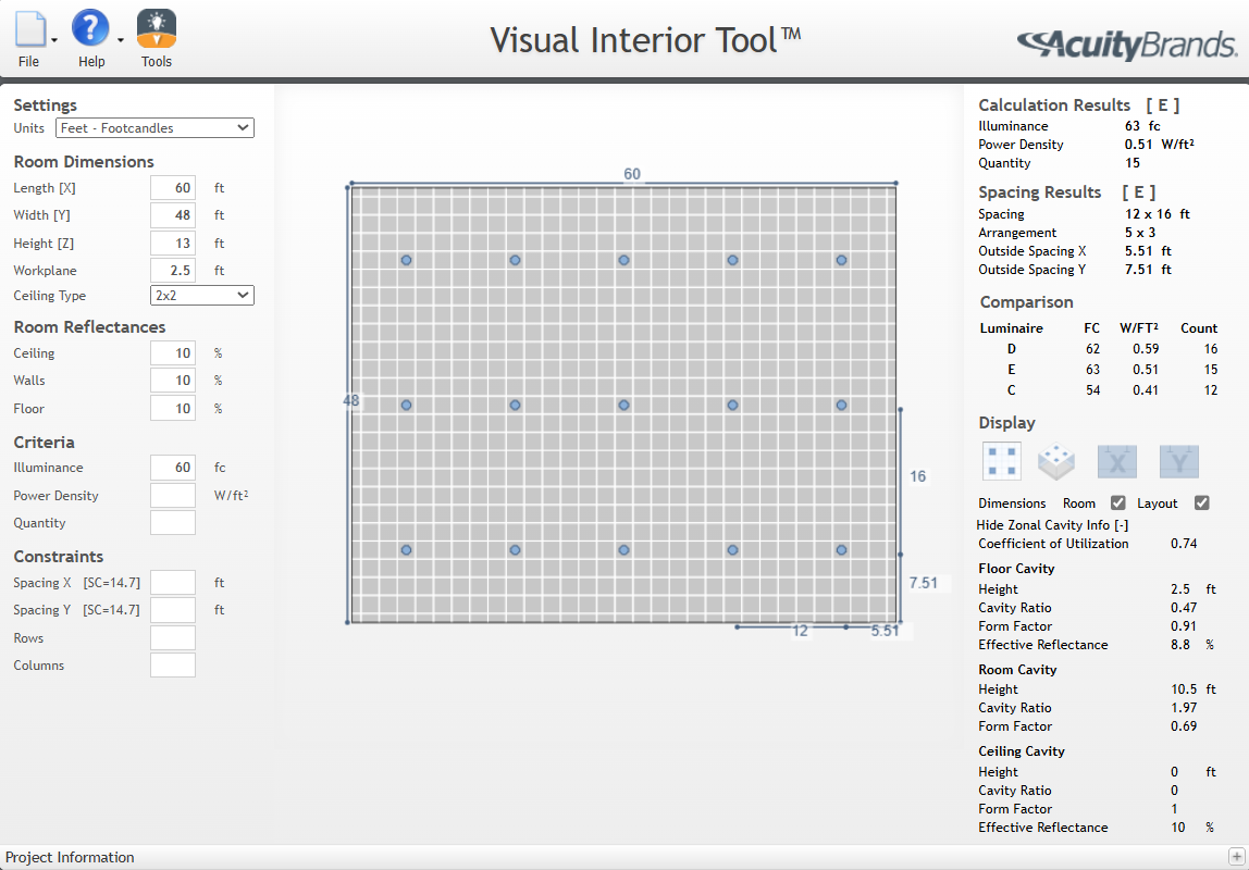

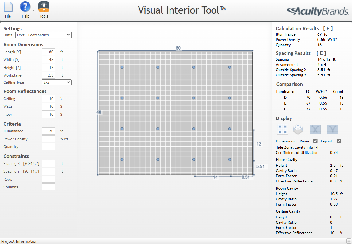

      Dontlifttoshift - I 100% understand where you are coming from with the "hot spots". This was my biggest concern. My brother is an electrician and uses the Lithonia REBL https://www.acuitybrands.com/product...l-led-high-bay in almost every shop he wires and said over a thousand lights he's only had callback on 2 that failed, which they immediately replaced under warranty. The ALO13 is rated for 12-16'. They have a "wide distribution" option, so I am playing around with lumen calculators for this. That's where I'd lean towards a lot of lights that are less bright to get coverage without shadowing. I just did 9x LED "wafer lights" to mimic cans in the house garage, and it certainly is better than what I had but does still cast shadows.
      Side note, any idea what Hunter fan you have? I was going to get two of the Hunter Downtown in 72" as seen here: https://www.homedepot.com/p/Hunter-D...1592/323891033 My concern and yes definitely staying away from the lighting spacing so you don't get that flicker from blade path being under the light.
      Vimes - My detached garage upstairs I did 16x 2-bulb 4ft fixtures with the LED tubes. It took forever but I split the tombstones on every fixture to wire up bulb 1/bulb 2 individually on 2 separate switches. That way I get 50% lighting with 100% floor coverage or hit the other switch and get 100% lighting. This kept me from having to do every other fixture or something where lighting wouldn't be even. I don't prefer the look of the 4ft fixtures, but honestly yes, they're probably the better way to go as I am completely happy with them. It would probably save me some money as well. Good point on the product availability if/when they go out.
      Larry - awesome setup! Looks like a medical lab in there. I assume those are 6 bulb high bays with a diffuser panel over it? They look really nice, and don't appear to give harsh lighting at all.
      I've got some work to do in now comparing the REBL to what I'd need with 4 ft tubes.
      Here is where I was at with the wide distribution REBL ALO13's:
      (leaning more towards the 4x4 though, if I don't do tubes, as it would create a natural happy space for two ceiling fans between the left and right side, front to back.

      Hunter Trak fan. It's outdoor rated and that helps keep the dust out. I had to order it from Home Depot https://www.hunterfan.com/products/c...41685712797828
      Those Lithonia lights look great, like really great, and their layout tool is fantastic. If those were available in 2017 I may have a different opinion, or if I had known about them last year before I went back to tubes. I still think the tubes put out more even light.......especially with lower ceiling heights, at the cost of requiring more fixtures. I replaced 25 12,000 lumen High bays with 128 4' LED tubes in a 36x58 space and it is better in every single way. It was about a 20% increase in lumens output but now every corner is lit as well as the middle. The corners and walls are where your benches and equipment are.
      If you decide on the High bays, I would for sure stay with ALO13 and probably run them at 12k lumens. To get 100 fc you will need about 25 fixtures in a 5x5 pattern.

      Did you pull your garage door wall lights back some so they weren't covered when the doors were open, or just do even spacing? You mentioned 100fc- is this what you shot for? I did research what you "need" and numbers were all over the place, with 20fc min and most recommending 40-50.
      Maybe I missed it, did you do 128 single bulb fixtures or were they 2- or 4- bulb units? Just realized I need to dodge garage door tracks when figuring layout also.

      I find the 60fc number is for general shop lighting with the intention to use task lighting everywhere. It's a business and I think that plan sucks. There's a work light on the band saw, we don't even turn it on anymore.
      All lighting layout was done without thinking about the doors. If the doors are open, there is sunlight, nighttime lighting with the doors open isn't a concern for me.
      I mostly 8', 4 bulb fixtures with a handful of 4' fixtures to get around garage door tracks and other things already on the ceiling.
      Hot tip, make sure to enter inside dimensions in the lighting calculator.

      Yes, walls take up a foot total of that space.
      Deep down A part of me still wants to do the 16x wide beam UFOs, and have dropped down lighting that is maybe 8ft off the ground on the side where the work bench would be for detail work. Will play around with calculators more later tonight.
