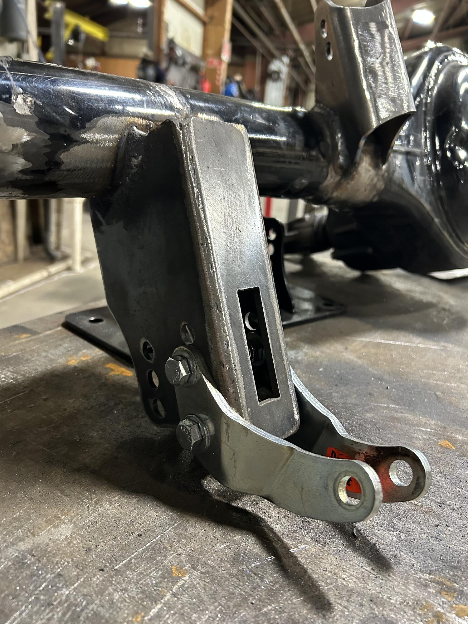

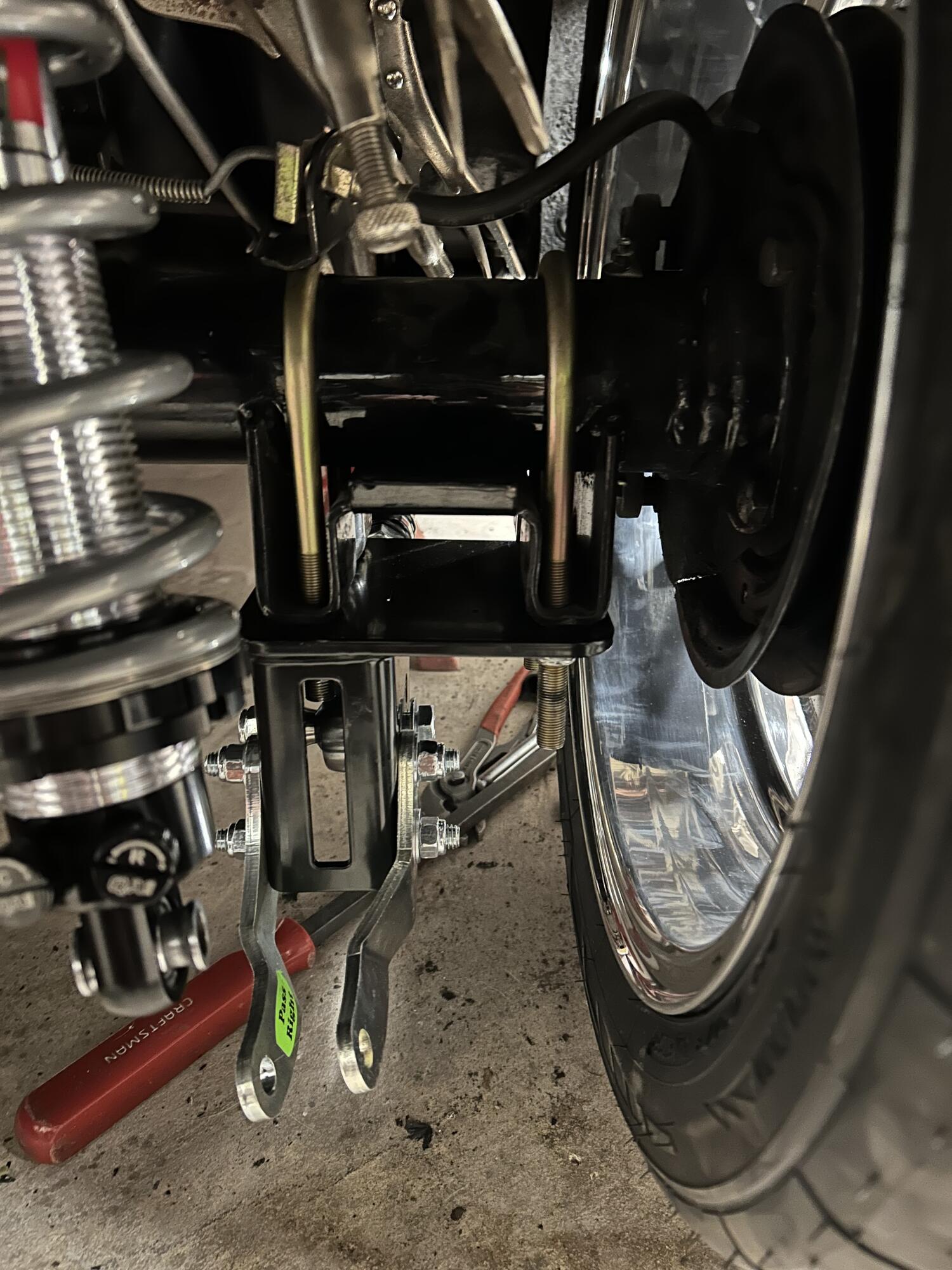

      I recently purchased QA1’s 4 link kit (R256-170) for my 1969 Camaro project. Along with the QA1 kit I am installing DSE mini tubs and narrowing the 9in rear end to fit a custom offset wheel.
      The issue I ran into is the upper and lower mounting brackets that attach to the axle housing (pictures attached) don’t fit. It appears the QA1 brackets are designed for a 12 bolt axle and do not work on a ford 9 inch housing which I have in my car. I reached out to QA1 about the issue (nice people) and after some checking they suggested I purchase their 9in housing kit which comes with the correct brackets already welded on for $1,900. Obviously that’s a no go. After some more discussion with QA1 they referred me to Quick Performance who supply’s them with this particular housings in hopes they would sell me the brackets. I called Quick Performance (again nice people) but after some checking they informed me they were not willing to sell the brackets alone and suggested I purchase the entire housing.
      Currently scratching my head weighing my options. I am thinking I can make a template out of cardboard, transfer that to metal and have a fab shop make them for me.
      What do you guys think?
      You can see how this bracket does not fit on the 9in housing.

      Once I narrow my axle (3in per side) to accommodate the new wheels it will hit the plate on this bracket.

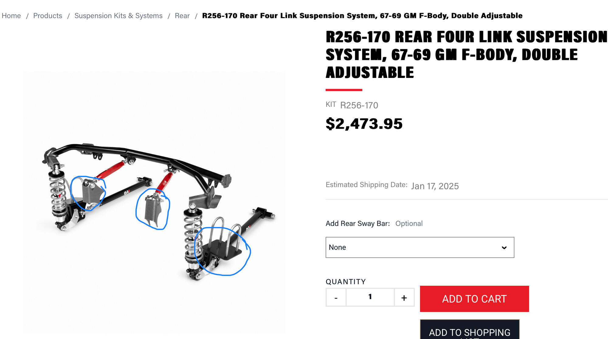

      Here are the brackets I need.

      This is the package I have

      If it was me id be selling the 9inch thats in the car and ordering the narrowed one with the brackets. As I am not sure there's much cost savings with the time and materials to have some one make those brackets and the cost to narrow vs selling and ordering what you need.
      Jun 2015
      175
      Country Flag: New Zealand
      just fit braket to housing

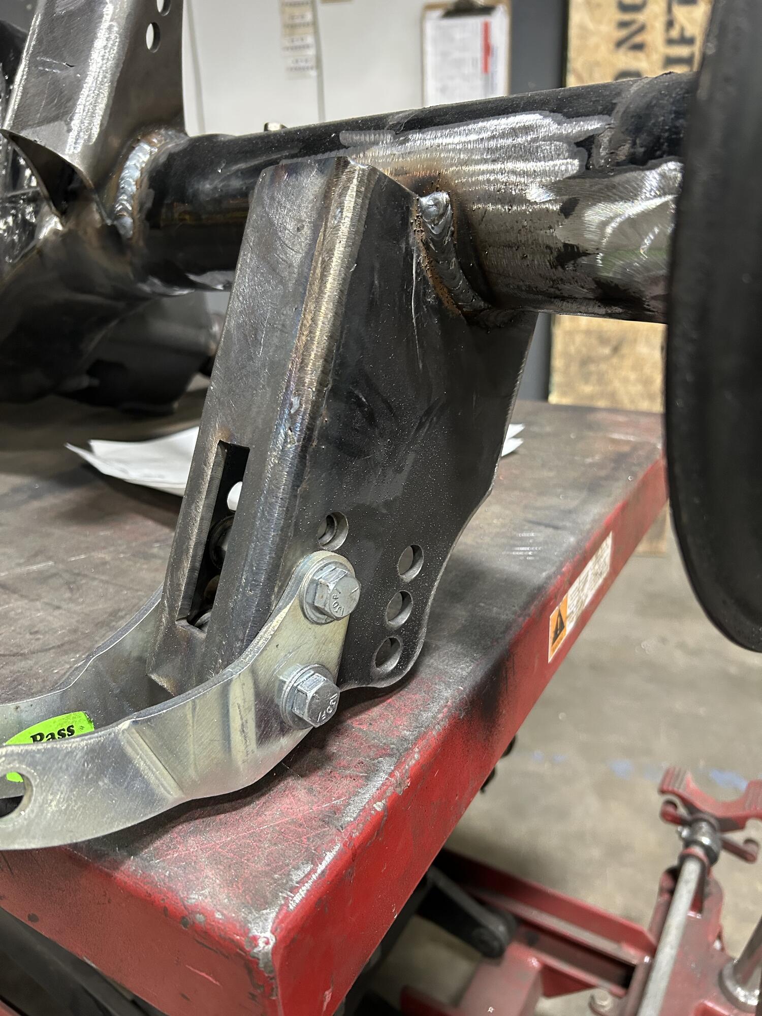

      Got it figured out.
      A buddy of mine who owns a custom trailer shop helped me out. He is a good fabricator and has all the right equipment.Name:  IMG_0813.jpg
