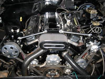

      Matt, do you know if they do High-Temp coatings like Jett Hot? I need to get some headers coated. I really like the result of powder coatings, I got my intake manifold and various parts done for my engine, check it out...
