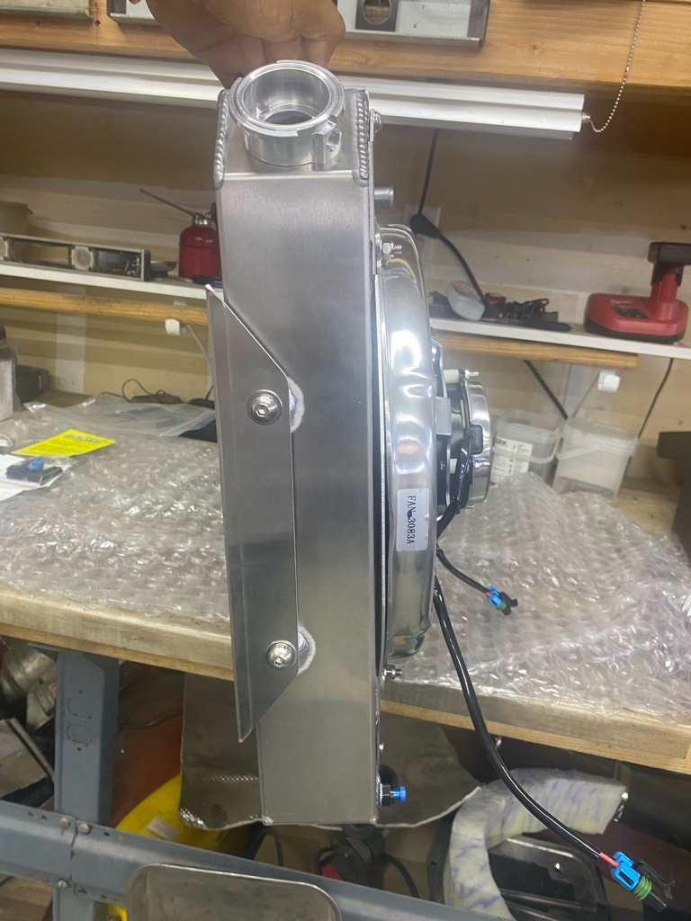

      Received my entropy radiator in week and half and had to be manufactured to boot, killer time. Looks like a quality product planned to install this weekend and test out in hundred degree plus weather.
