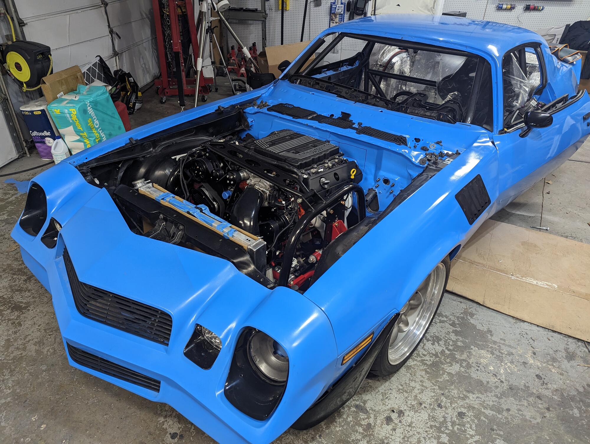

      I should probably start a build thread on this site but here is a link to my what most people would call a "pro touring" build over on Nasty Z28 - https://nastyz28.com/threads/1978-z-...malgam.344828/
      I figured you guys may be better suited to answer this question seeing as this forum is more track focused and less about restoration or purity.
      I'm looking for help choosing a master cylinder that could possibly fit in my limited space. Due to having a front subframe with tubular shock towers that will be tied into the roll cage I'm limited to a firewall mounted master cylinder with about 7" of overall length. I'd like to not have to move to a dedicated pedal box with under dash MCs due to the fact that I had to modify the OEM pedals to add brake and clutch position potentiometers to keep all the 6th gen Camaro computers happy.
      I'm currently running Wilwood 6 pistons from a C6 vette on the front and 4 pistons from a C4 vette on the back. Any suggestions on bore sizing would be greatly appreciated.

      Can't do master cylinder math without know caliper bore sizes. Also, power or manual? Pedal ratio needs to be known as well.
      That aside, this should fit easily. https://www.wilwood.com/MasterCylind...ter%20Cylinder
