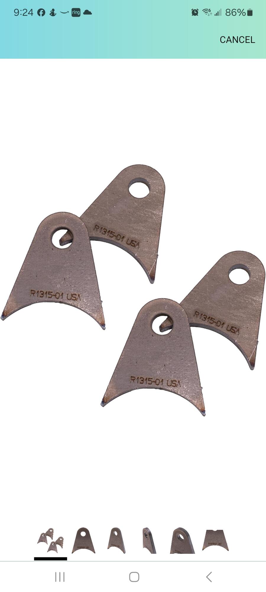

      It depends on the mounts. If they are cantilevered out 8 inches and only welded to 25% of the tube diameter, I don't feel great about that.
      Pictures are worth a thousand words, can you show us what you are doing and maybe a pic of the mounts that you already have?
      Donny

      Yes they only engage about 25% of the tube but only cantilever out a few inches.Name:  Screenshot_20240703_092415_Amazon Shopping.jpg

      In this application, either material will suffice. A 3" tube seems to be more than you need, especially if it is 0.120" wall. Either way, you won't need to worry about it failing as long as the welds are of good quality.
