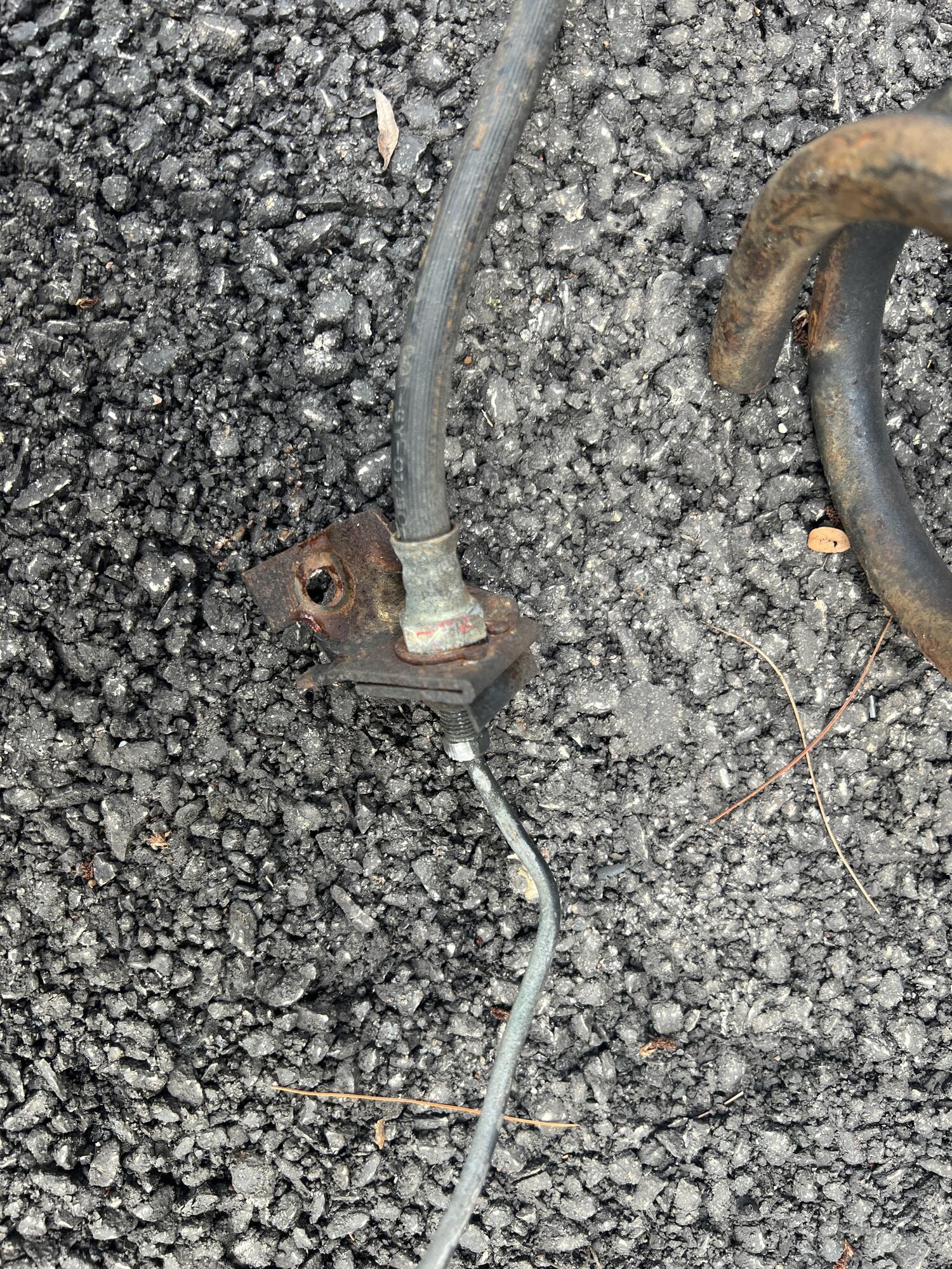

      What do you guys recommend for the front brake frame mounted hard line to flex line mounts??
      These are the OEM ones that I took off and theyre all jacked up
      Need a new hard to flex line option to secure to frame
      Whats some good recommendations??
      Also any preference for flex lines for rhe C5 upgrades?
      Im not the best at knowing which brake line sizes to go with either …lol
      Any guidance would be appreciated. C5 front, Ls fbody rears, and 1” bore master 9” Dual booster

      Are you removing the stock distribution block (on inside of frame)? You can run the front (MC) to a T and from there to the front lines. For the rear, just plumb in an inline prop valve to the rear lines. I would call Tobin at Kore3 and get the stainless flex lines from him.
      Chris
      1968 Chevy Camaro SS
      LS3/4L70e, DSE suspension
