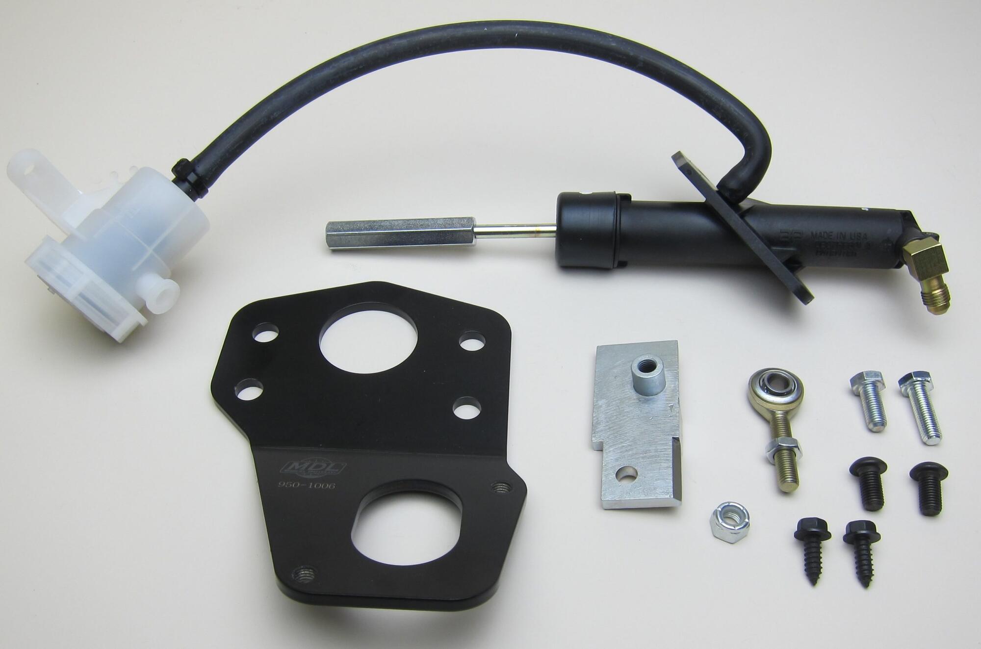

      I have a firewall adaptor plate behind where the booster goes to mount my LS / T56 swap slave cylinder on the firewall.
      https://piratejack.net/booster-conversion-kits/gm/

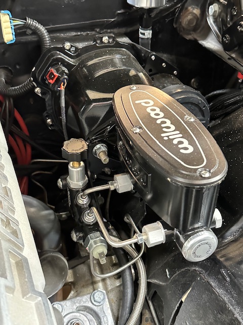

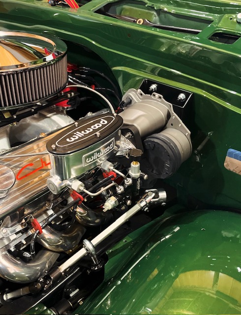

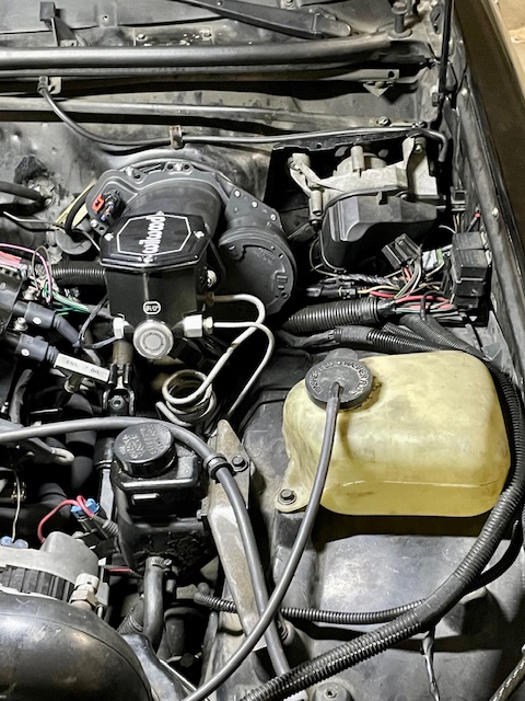

Size:  126.8 KBName:  booster2.jpg
Size:  207.4 KBName:  booster3.jpg
      I use and highly recommend the iBooster. A body kits in stock and ready to ship

      Not sure if it is permitted for me to mention here or not but my company, Retrofit Innovations, sells application specific turn key iBooster retrofit kits. retrofitinnovations.com

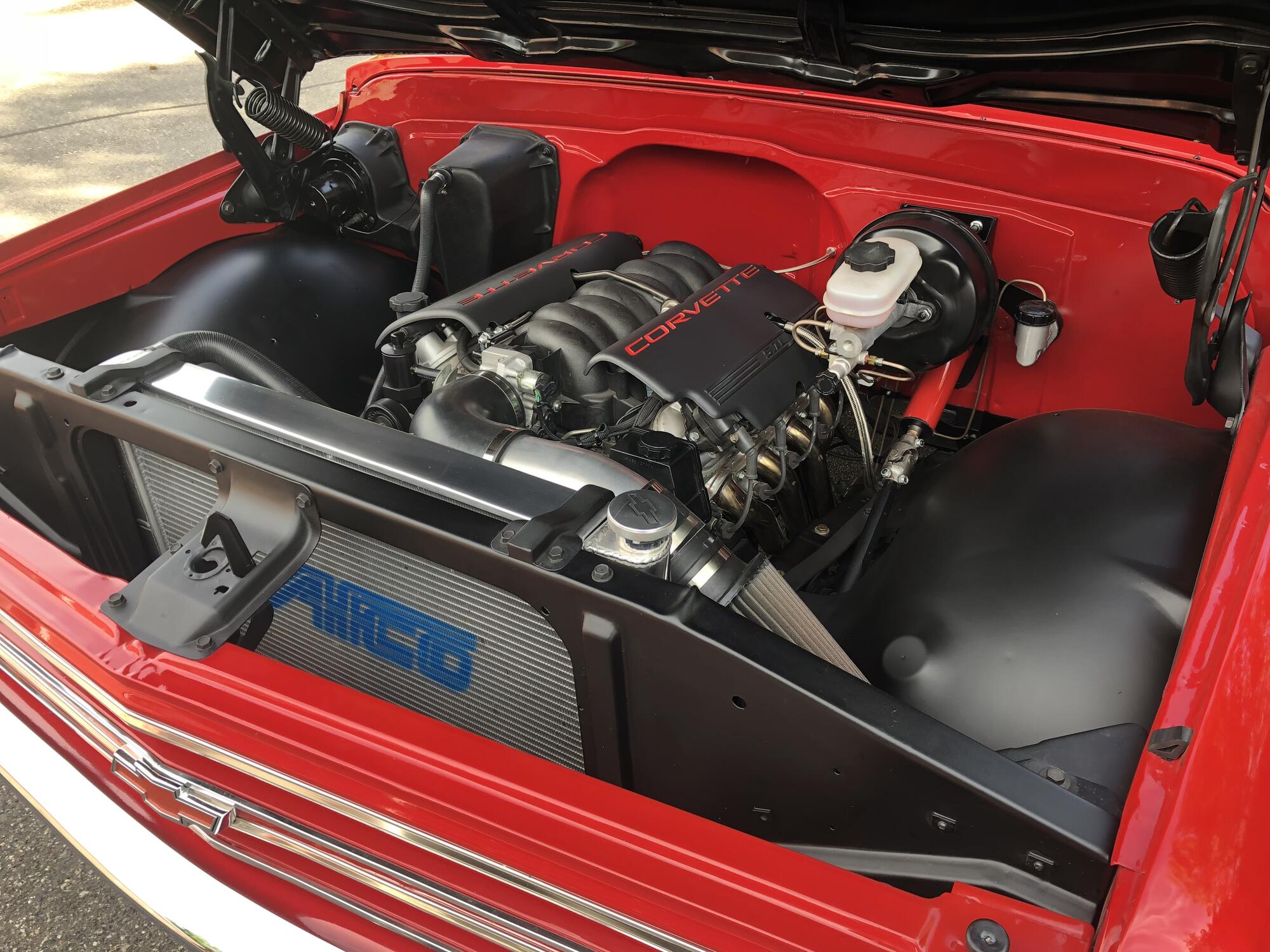

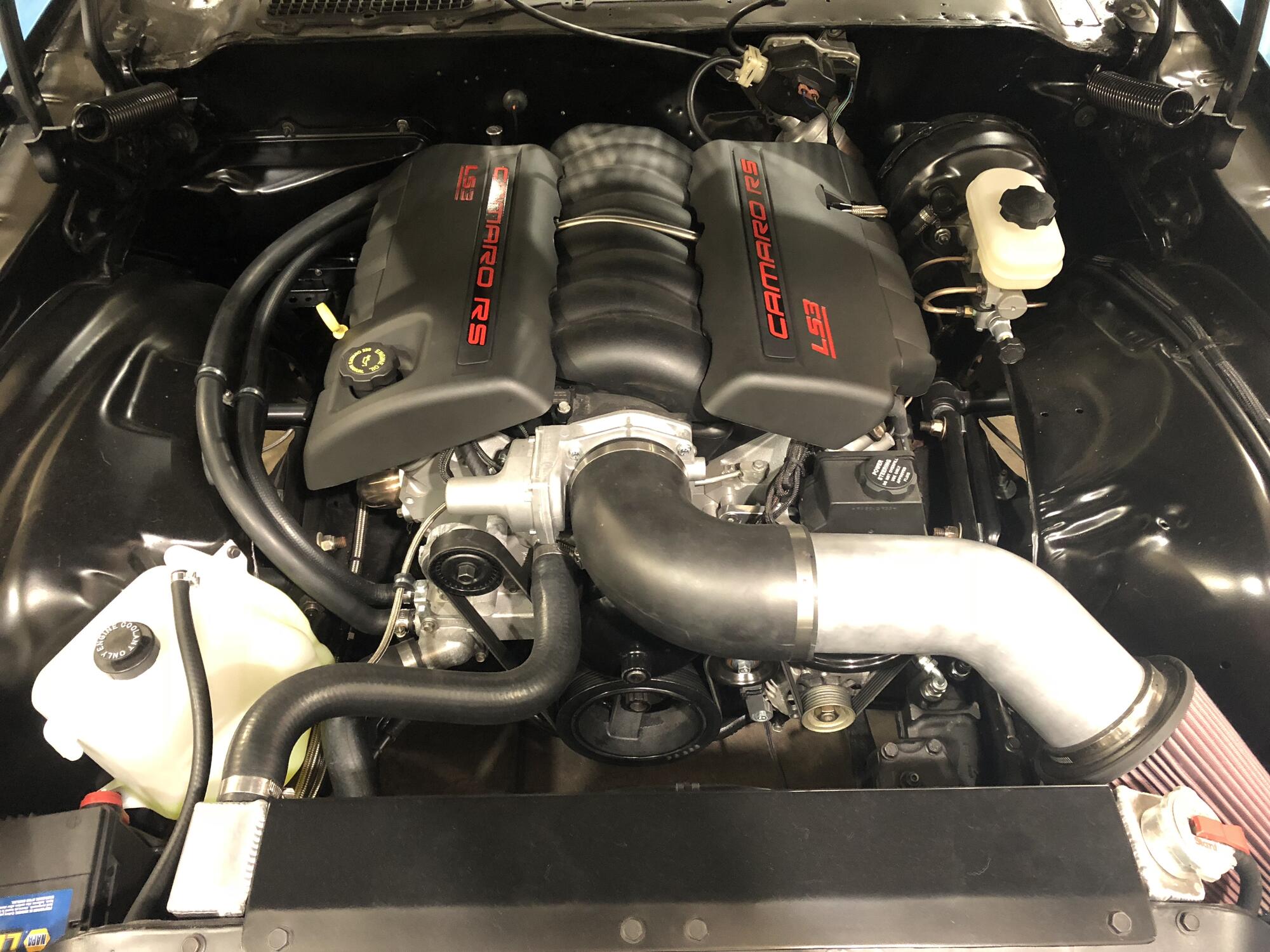

      A couple of pics of my C5/C6 brake swaps. 18" wheels on the 80 Camaro. 20" wheels on the 68 C10. C5 13" rotors and calipers on the 80.
      C5 14" rotors and C5 calipers on the 68.
      Many years ago I used C5 13" rotors and calipers on a 79 Camaro. It was tight but no clearance issues.

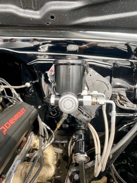

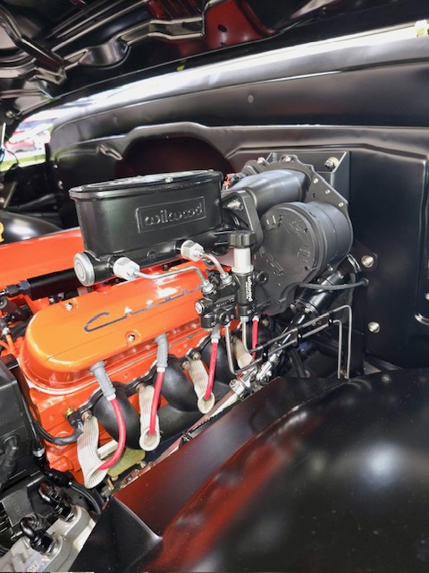

Size:  159.3 KBName:  booster5.jpg
Size:  184.3 KBName:  booster6.jpg
      None of the pictures I posted are of show cars, all are drivers, but I’ll pass your kind comments along to those customers! One of these is my own, 10k miles on the install and driven regularly.
