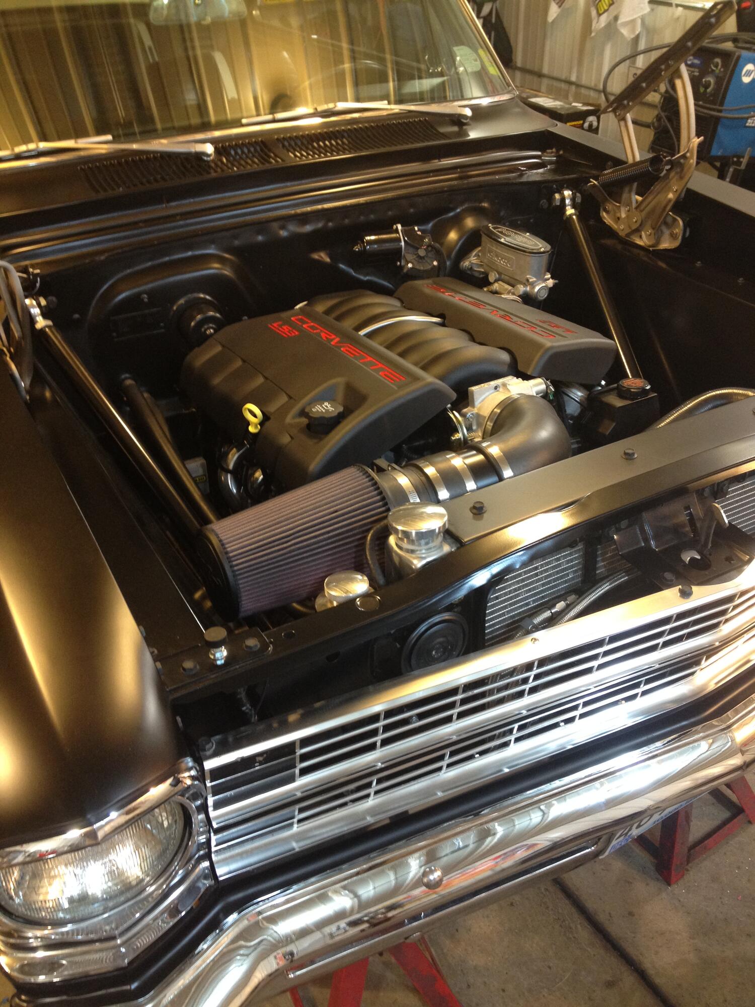

      But there is an up side to someone getting tired of their project.
      I bought this 67 Nova SS from a guy that got totally hosed by a shop doing a LS swap.
      Zero rust car. Turned out great.Name:  67 Nova LS1 001.jpg
Size:  324.5 KBName:  006 (2).jpg
      429
      Yeah, that did turn out nice
