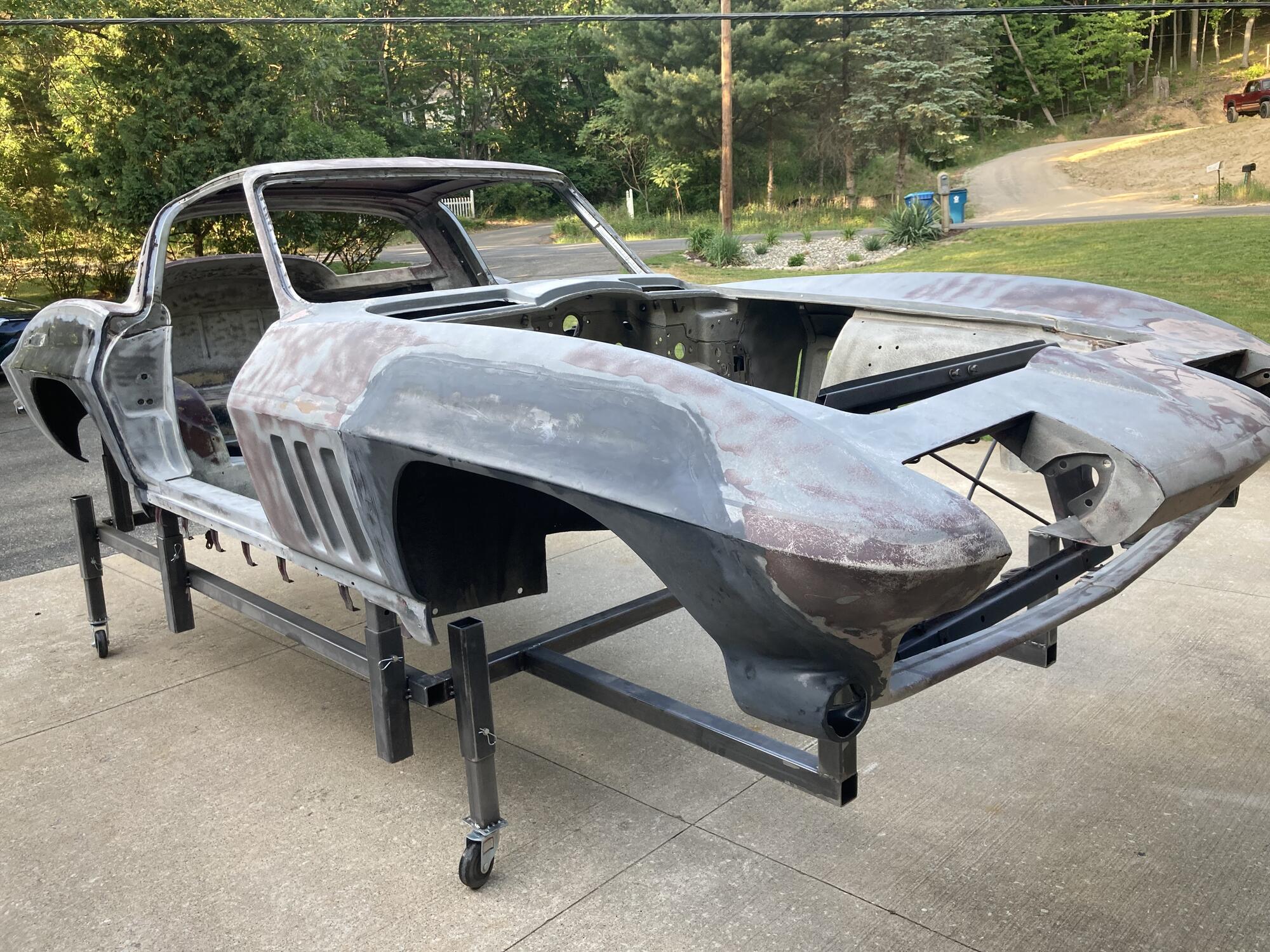

      My first task was getting rid of the nasty flares.

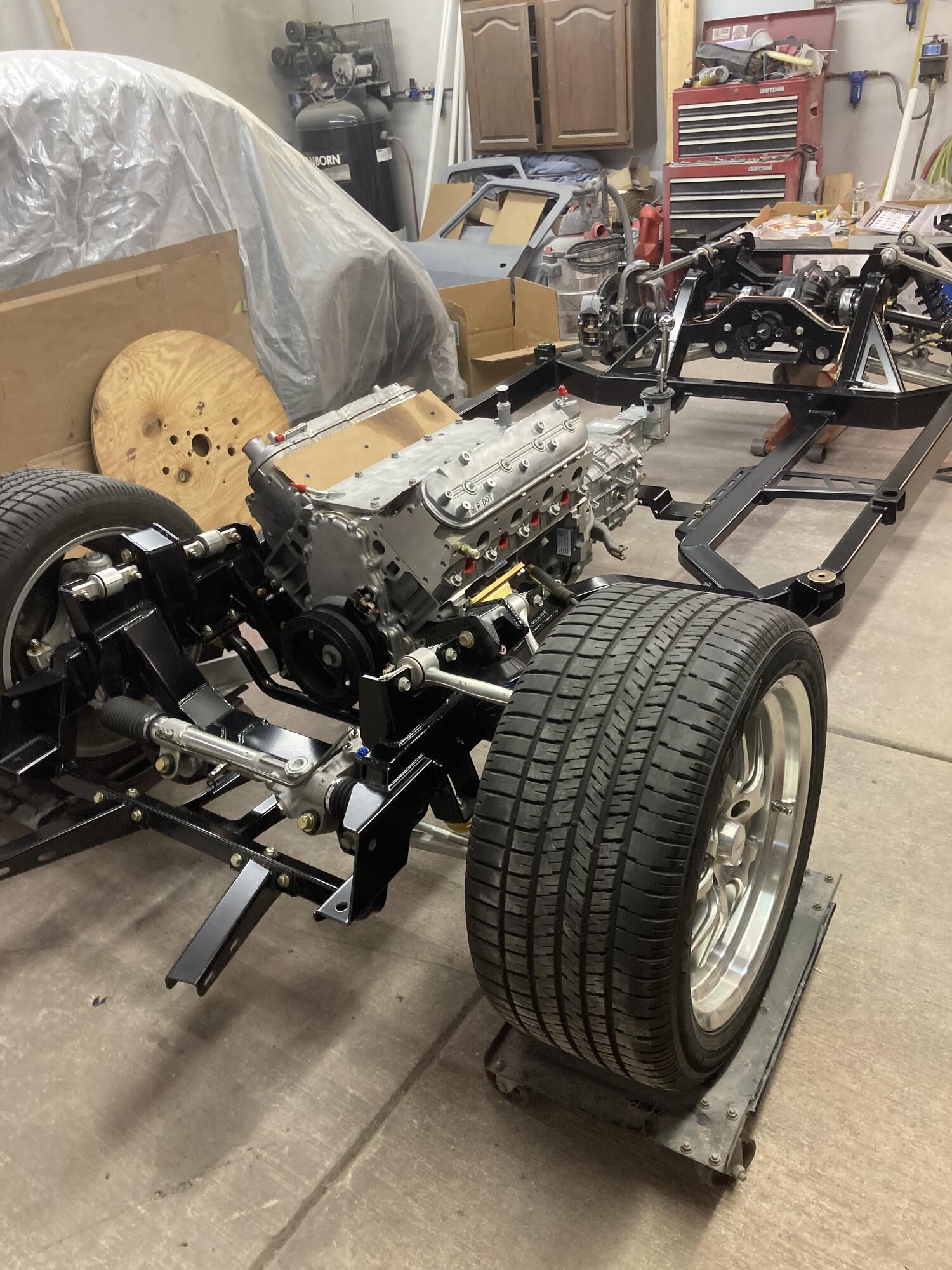

      Then I placed my order for a Roadster Shop spec seven chassis. There was a nine month wait for that. In the mean time, I built a body cart and stripped the whole car down and had it media blasted with walnut shells then epoxy primer. More to come.

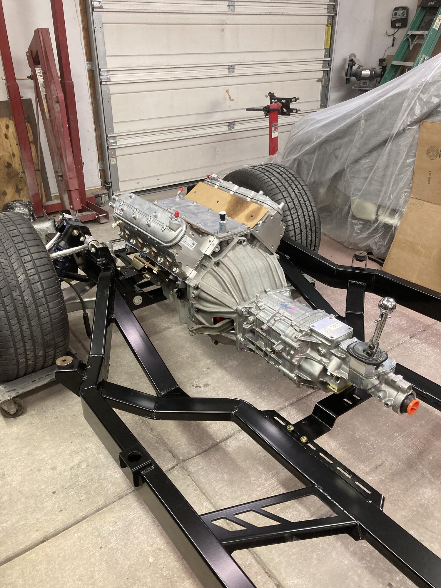

      Got a new Ls3 crate motor and a TKX 5 speed from Silversport. I swapped the cam out for a cam motion ‘spin monster’ cam.

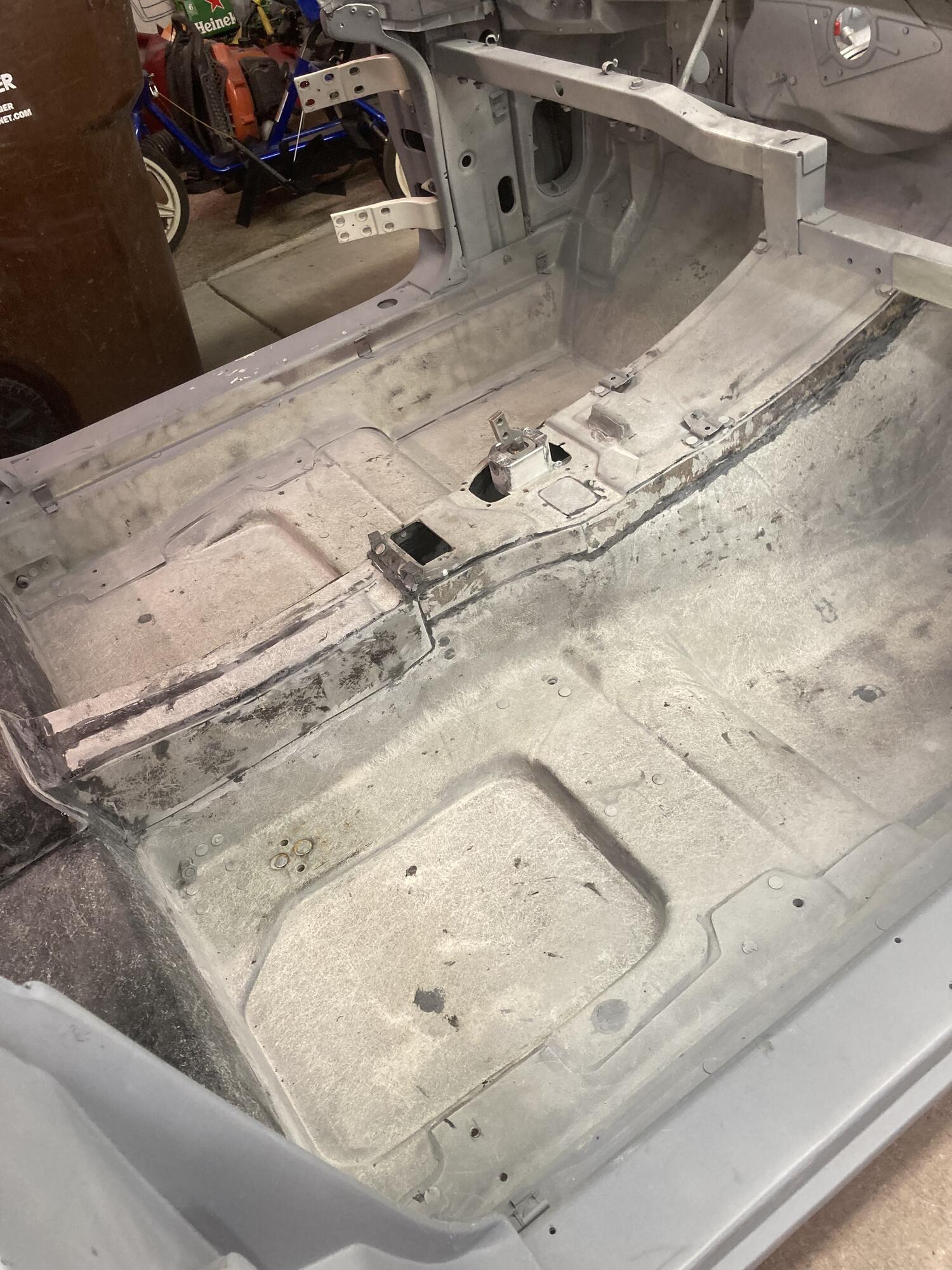

      I live about 2 hours from Dynamic corvettes so I went and got their rear floor and tubs. One thing I found as I was putting these in is that they make the tubs a little small height wise so that a convertible top will clear them. Since mine is a coupe, I’d rather have them taller so I can get the rear down a little lower. I raised them up by bonding in some inch and a half fiberglass blocks.

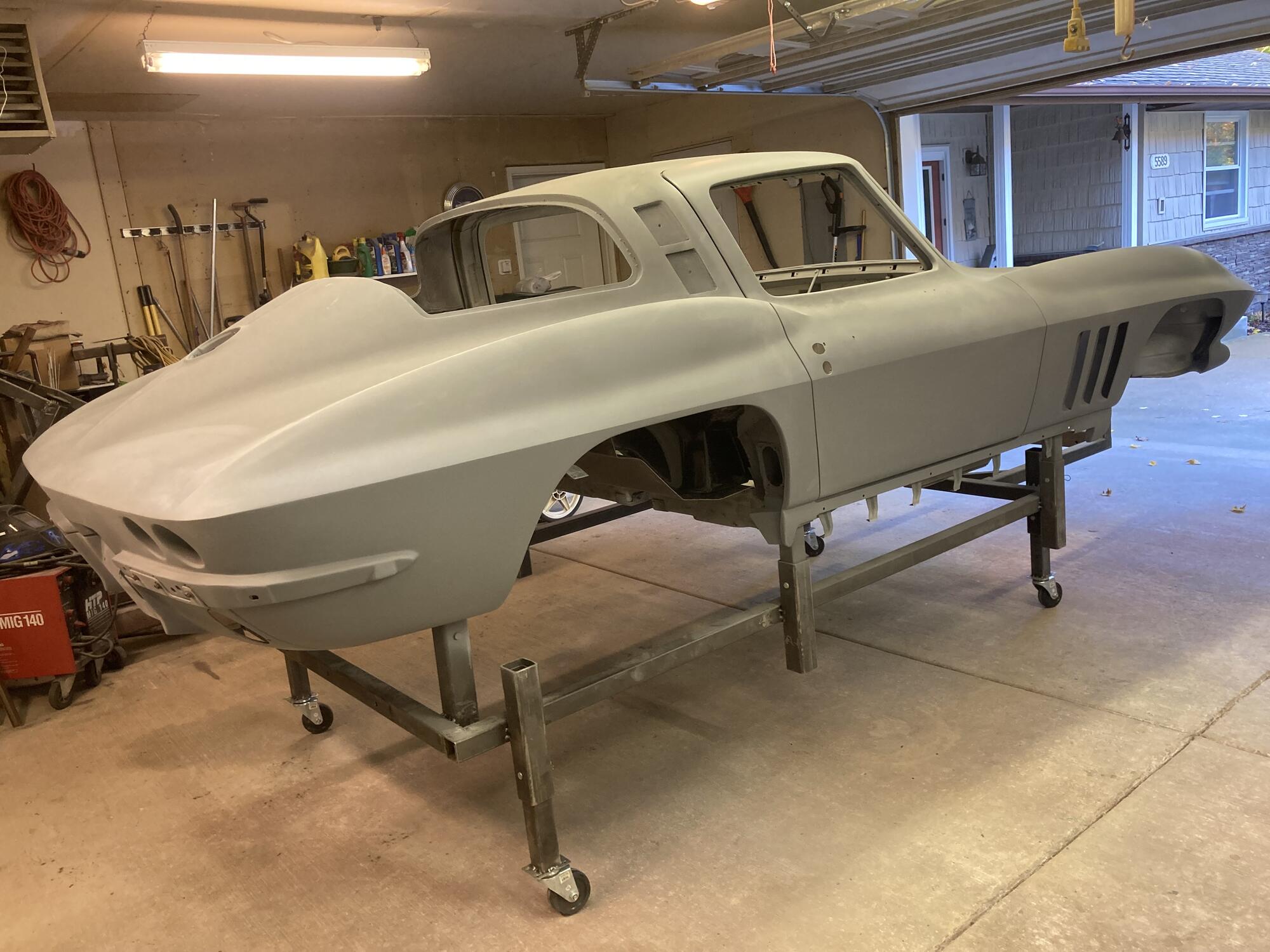

      Lots of body work. Prime, block, prime, block and on and on.

      Last September the chassis was finally ready for pick up. I test fitted the body and found that I needed to raise the trans tunnel about an inch.

      Just got my new wheels. Schott ‘vulcan’s’. 19 x 12 and 18 x 9’s.
