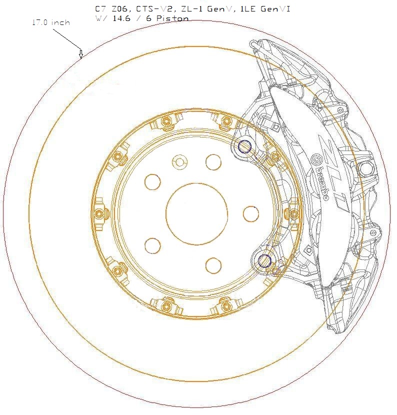

      They actually use a 14.6 rotor and yes they do fit into a 18, better than the 4 piston set ups actually. This is a C5 thin spoke wheel from the rear, it is a 18, same 14.6 6 piston as the V2 and ZL1 5th gen

      You can see more examples here https://bigbrakeupgrade.com/what-cus...ying-about-us/

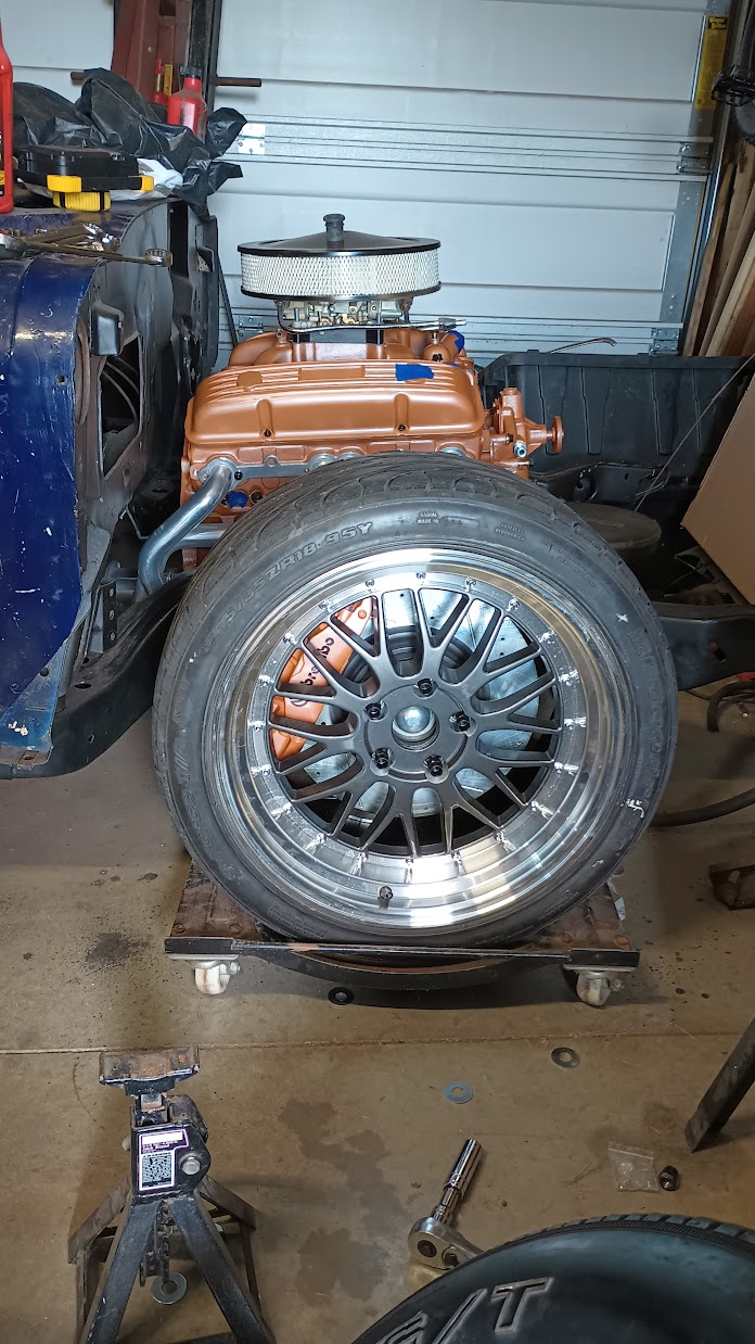

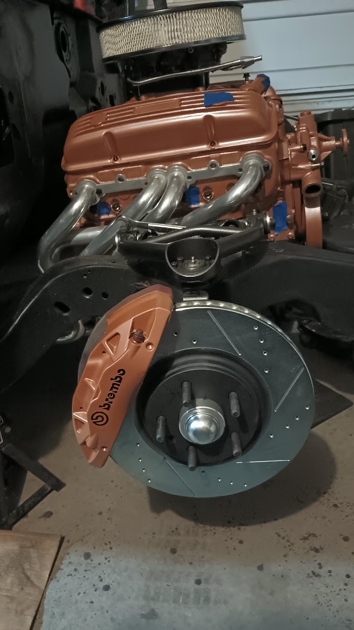

      So I have the 4 pot c7 zr1 brembos, still a 14" rotor and wide calipers, I ordered extra backspacing so I could run spacers on my 18s so the spokes would clear the calipers. This is on a 68 chevelle with speedway g-comp spindles using bigbrakeupgrade brackets btw. I've got the full set, using camaro rear backing plates to have parking brakes.

      22 offset on a 9.5" wheel, so something like a 6.25" backspacing, right now I have a 20mm spacer, but a 10mm would clear. Oh, I meant z51, that's what I went with for the rotors front and rear, found an unlabeled powerstop kit for the pads and rotors. I painted the centers black (even though they don't need it) cause I liked the look. You'll also need 1/2"x at least 3" wheel studs.
      To mount these calipers on the afx spindles is pretty tricky. You have to mount at least the top of the bracket to the caliper otherwise when it's mounted, you can't tighten the bolt with an h12 socket.
