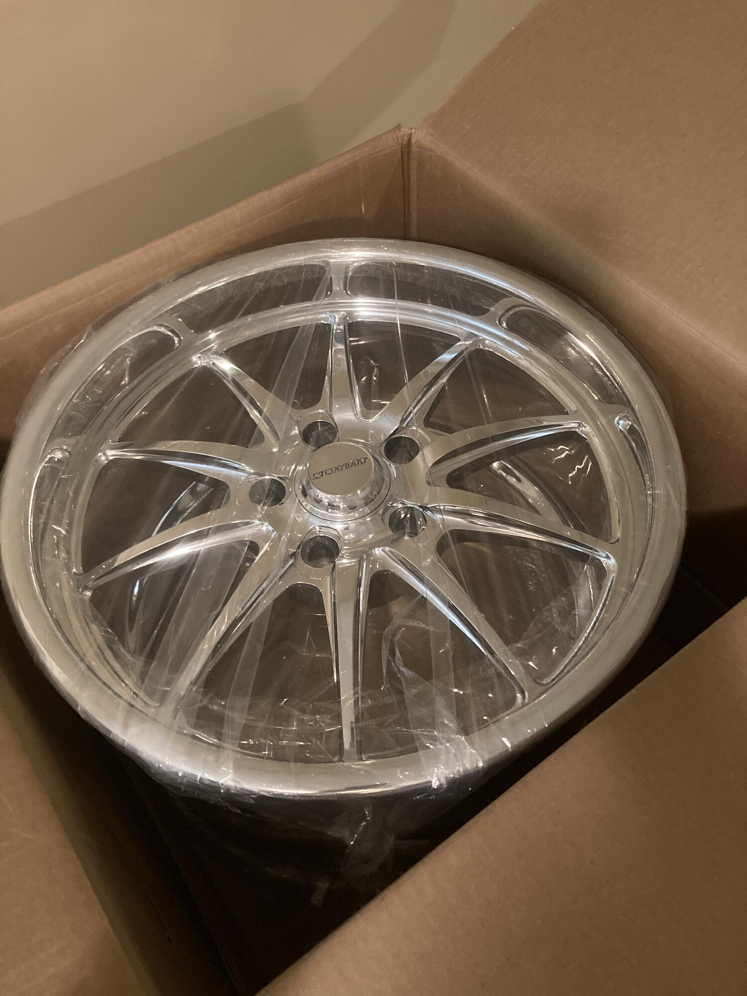

      If there’s any way you can make 18 x 12 with 8.75” BS work, I can make you a smoking deal on some new Schott 2 piece forged wheels.Name:  IMG_1869.jpg
      How much are you asking for the set? Whats the front?
