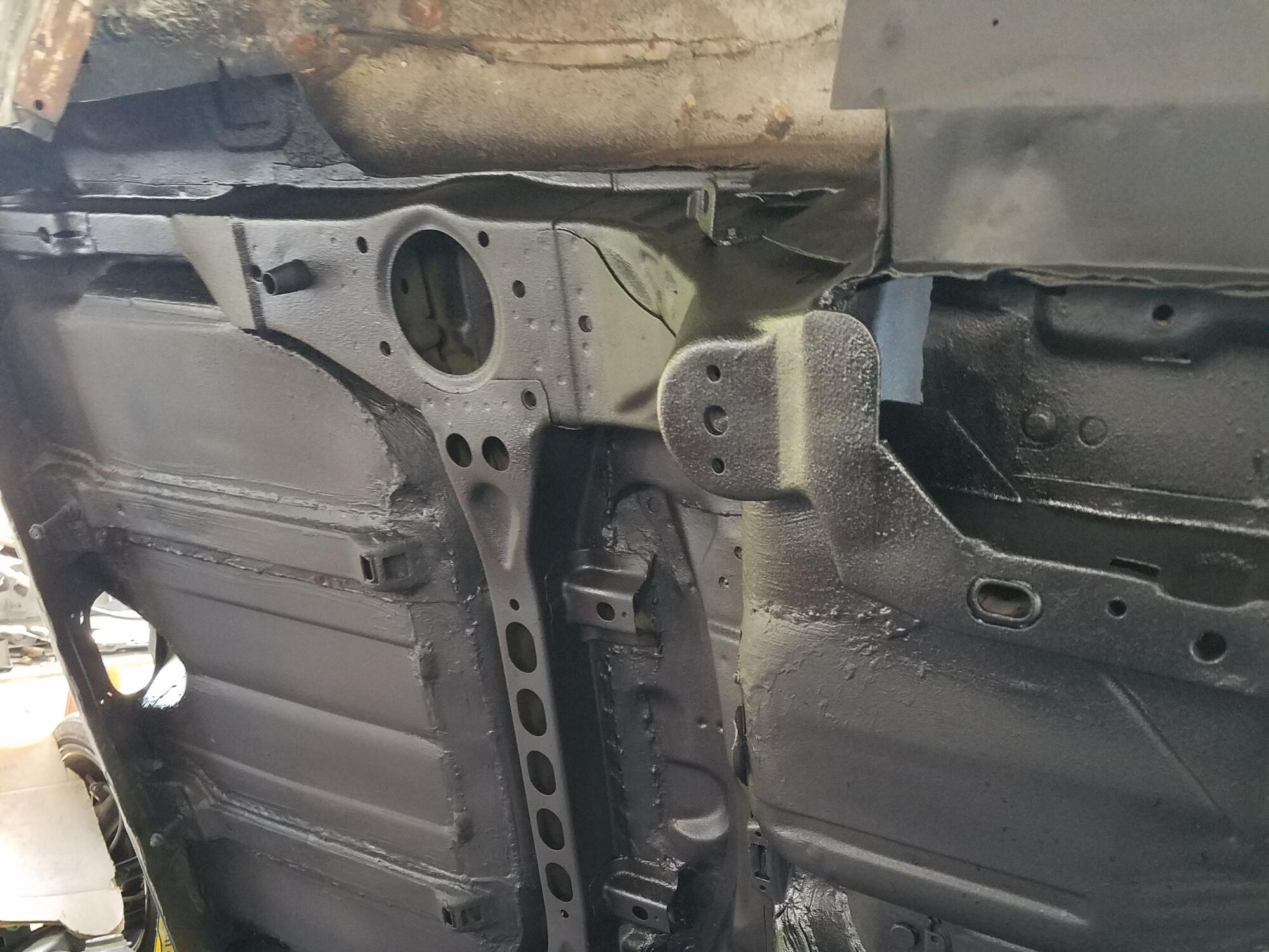

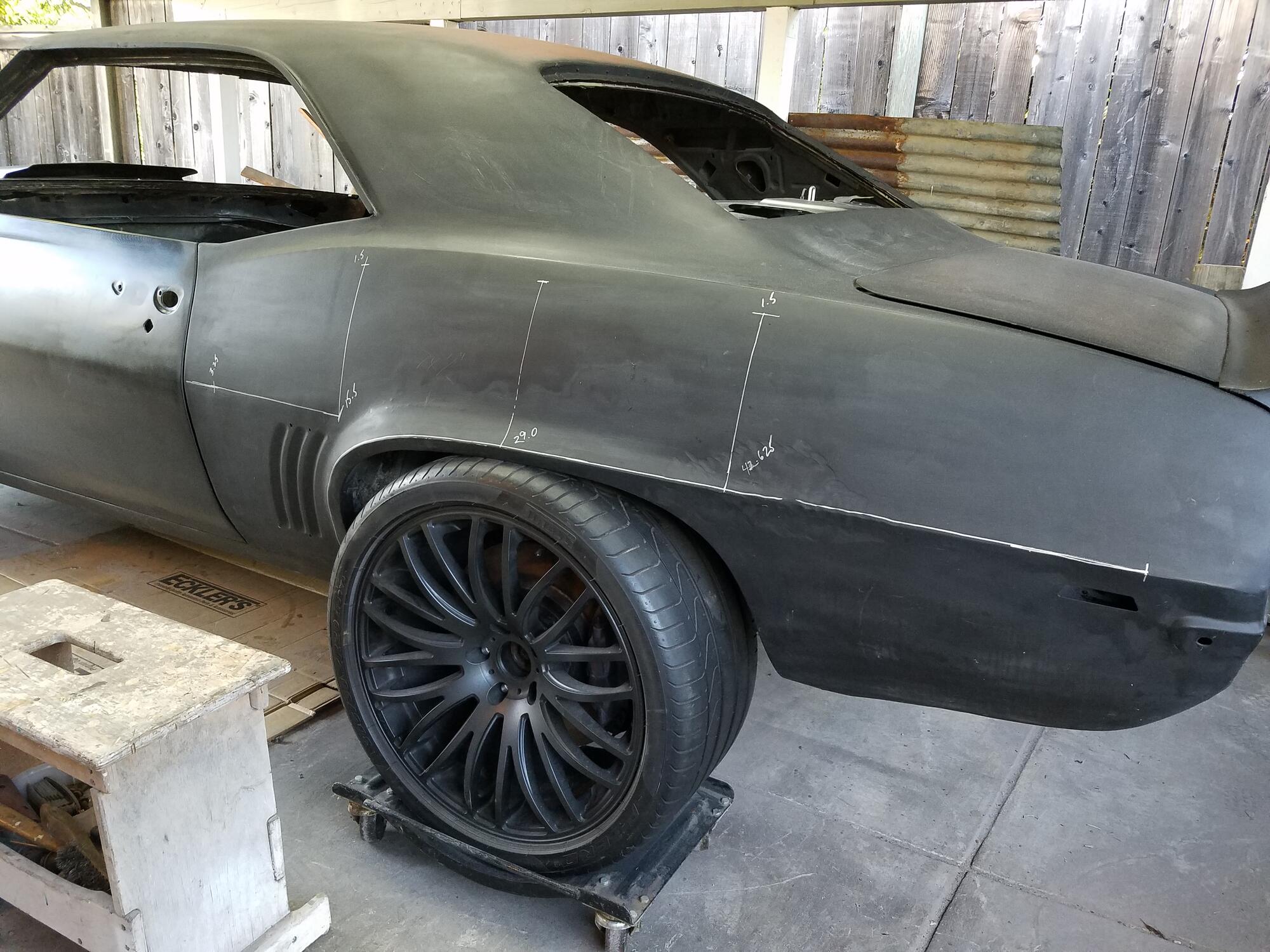

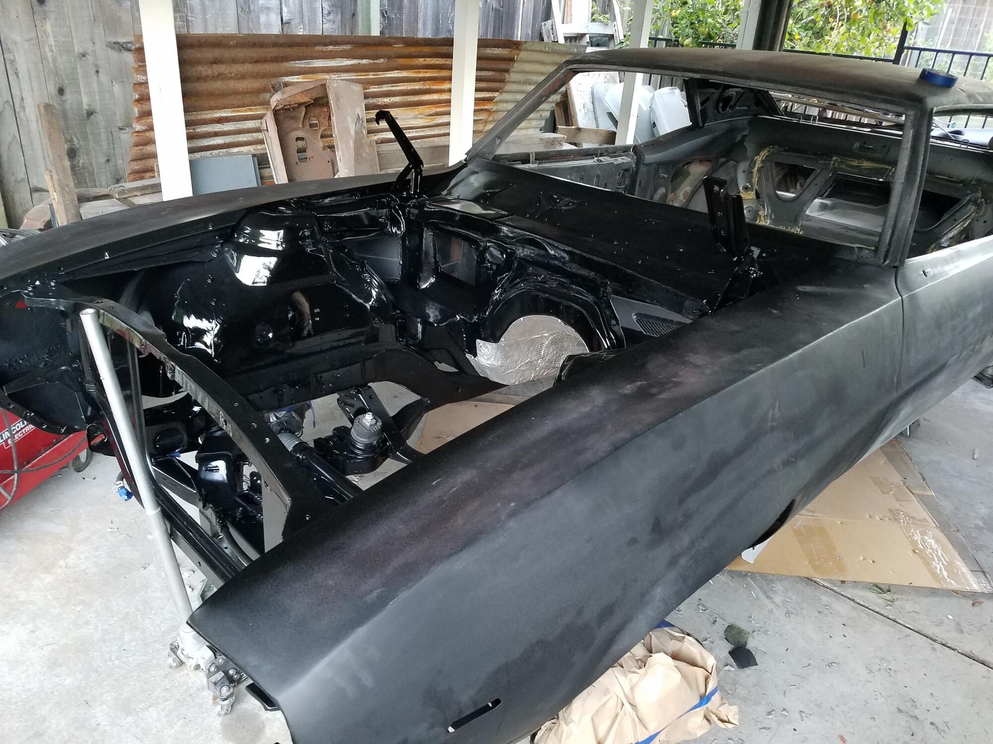

      My vision was to build a fat, low 69. I actually widened the front fenders 2" on each side and the rear 3" on each side. I spliced in gen 5 strut towers to the front subframe and ZL1 rear cradle and joined with the front. It drives beautifully!
