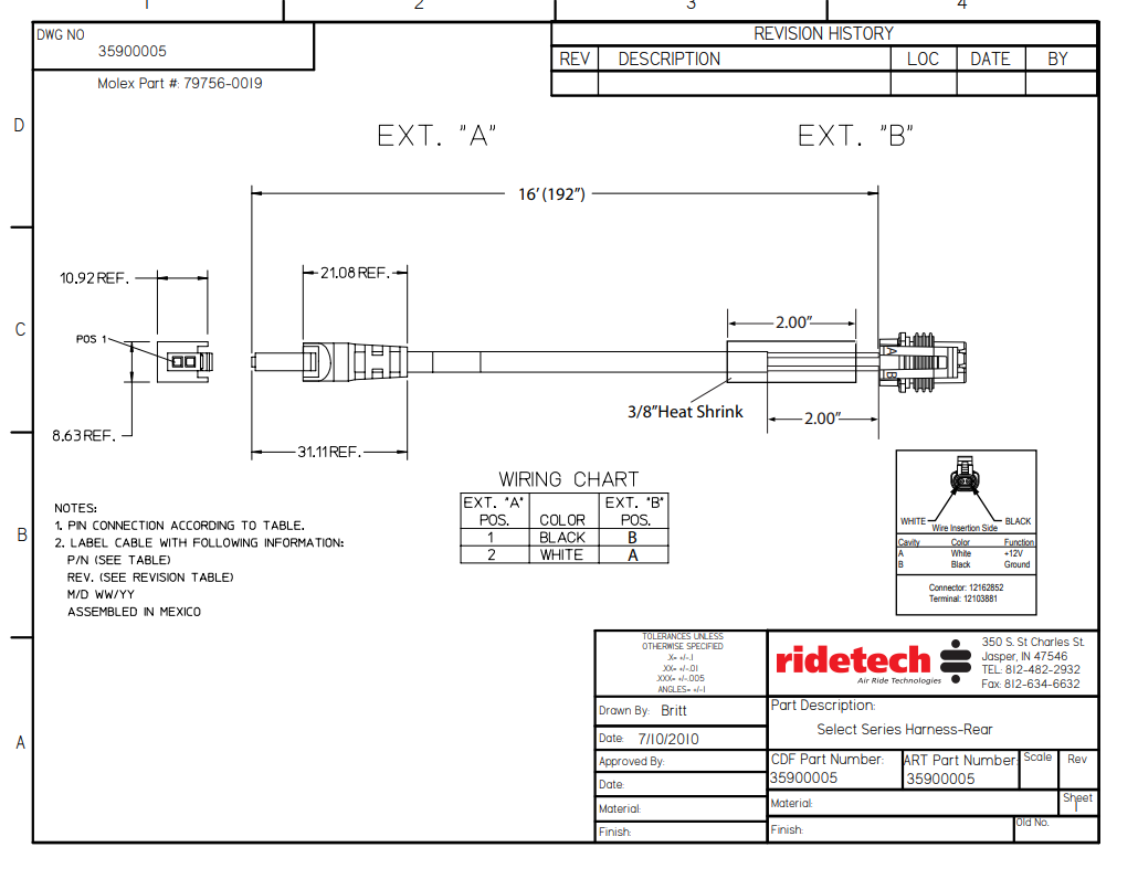

      Don is correct. . .Select Series was one of my projects.
      The Select Series parts came from BWI (formerly Delphi suspension division), and are the "bi-state monotube" platform (think GM trucks with Delphi shocks that change valving for towing. . .same parts).
      They are triggered by +12v.
      I tried attaching PDF's but it didn't like it, so here are some screen shots so you have part numbers for connectors and pinouts for power/ground:

      Again, Don is correct. The shocks just need +12v to "turn on".
      When no power is applied, valve stack #1 is working. When +12v power is applied, valve stack #2 is working. That's it. Either/or; bi-state; one or the other but not both.
      The little black box we provided was only a breakout for +12V and ground so you had a nice box to plug all the wires into. Super simple.
      The safest way to make your system is just as you suggest. . .find a switch you like and have it trigger a relay. The relay provides +12V to all the shocks.
