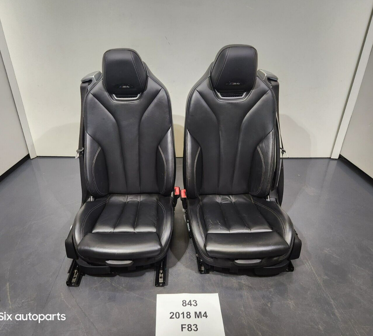

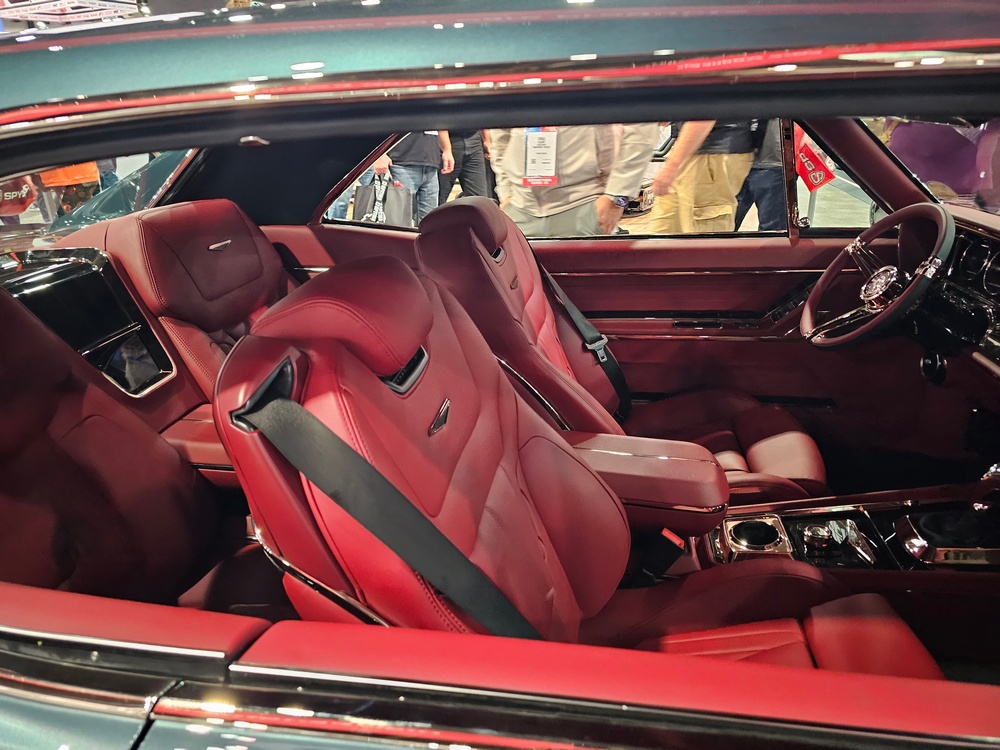

      Don't know if anyone saw this from SEMA or other media but a dude named Stephen Aguilar's 67 GTOs on display and was sporting some modified M4 convertible seats and they look like a pretty awesome option for a custom seat with an integrated 3-point seatbelt. If my interior wasn't already done this would be on my short list. They're also very reasonably priced at $1400 for the pair on ebay. given the cost of TMI, Sparco or Ricaro seats thats not bad. Heres the seats in stock form and from the SEMA Car
Size:  1.58 MBName:  TMI-pic-2.jpg
