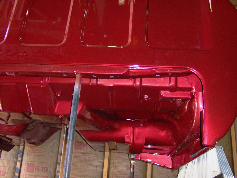

      I had a truck that I wanted to paint the underside to match the body.
      I used Omni on the underside to save some money & the regular PPG on the top.
      Omni paint was much cheaper but took twice the coats.
      In the end the cost was offset by the additional material plus labor time for 6 vs. 3 coats
      Also, the finished color was not as nice as the better PPG paint... it was the same color but had somewhat less depth/brilliance when comparing the 2 side by side in direct sunlight.

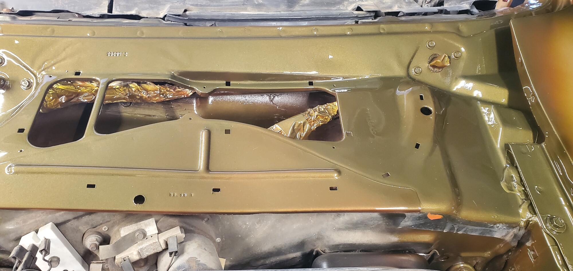

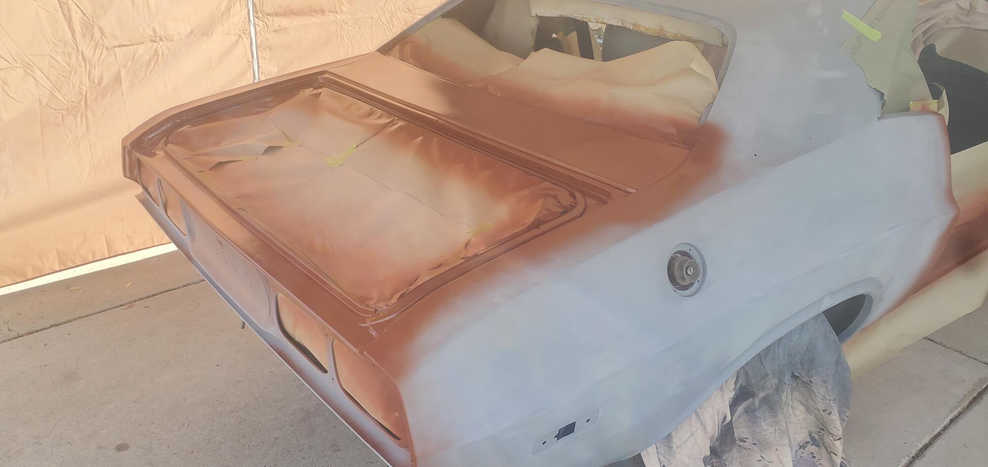

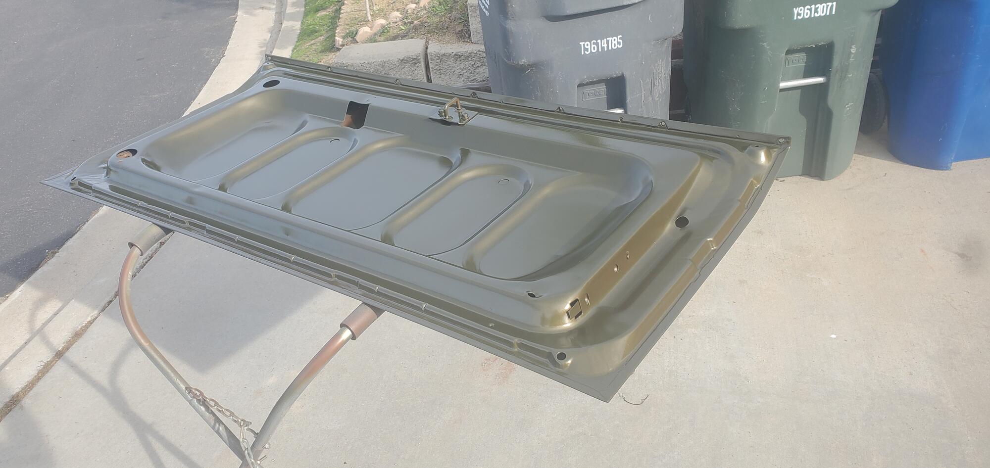

      Not the best pics but I thought I'd share what I got.
      The first time I sprayed over the gray it took close to 7 coats and I still had a lot of coverage issues. Also the color didn't match well.
      Spraying over the "red oxide" (which was also hard to find) I found the color comes out correctly but still takes many coats to cover
      I bought a cheap can of army drabe green and will experiment if I can get better color. Then I'll try to find some sealer that can be tinited.
      Not sure if you can see but on pic of the cowl just to the right of the center (where the wiper motor would be) you cab still see the red primer that didn't get full coverage
