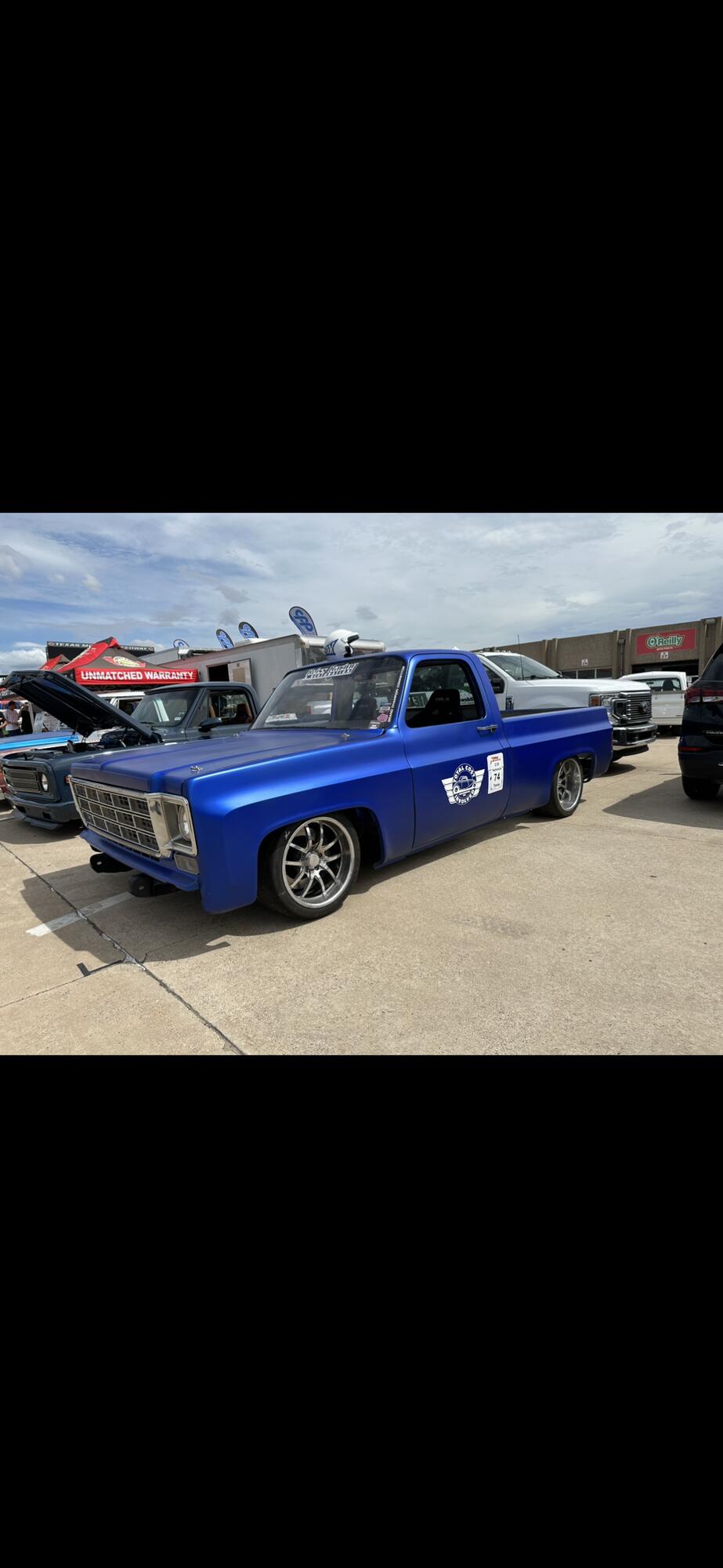

      Definitely check out TCI Engineering. I just got their setup for my '85. Haven't installed it yet but I've watched their blue "in-house" truck wax the field. Made me a believer, I can't wait to get this installed. They've got both 4-link and torque-arm options for the rear and can accommodate just about any rear axle setup
