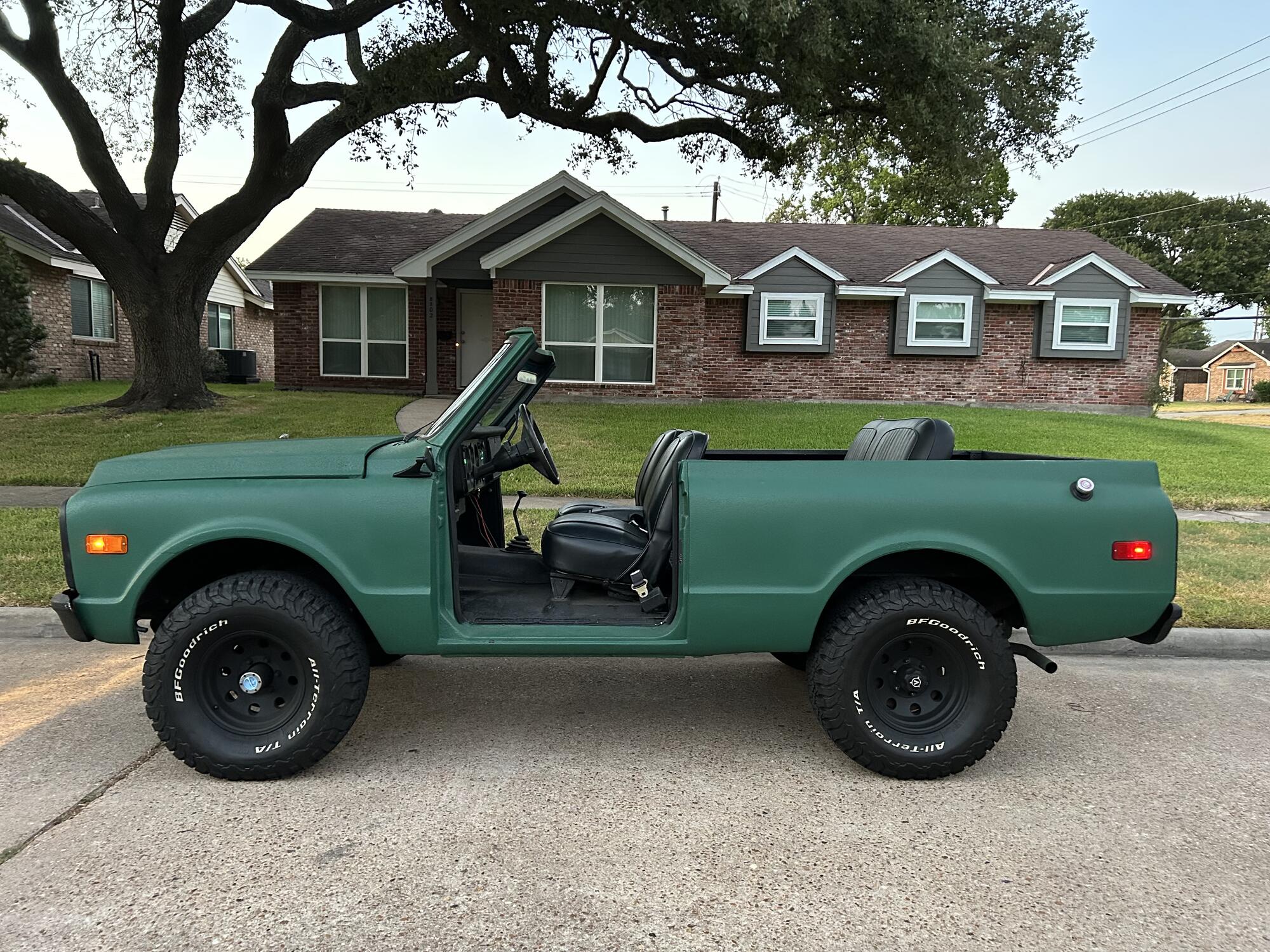

      Long time Pro touring member here but its been a long time since I've been back. Build a lot of First Gen Camaros and other vehicles but never tackled a truck. With the price of Broncos way up, I decided to stay true to my Chevy roots and buy a 1971 Chevy K5 Blazer. It is solid but came with no doors and no top. I dont mind though since I want this to be a fair weather vehicle to take to the beach, surf, and eventually down south when I retire. Looking to connect with members here who have 69-71 K/5's to get their ideas, opinions and experiences with these vehicles. Here is a pic of what I am starting with as well as a rough idea of a start. Dont mind the color, I will be stripping it away and taking the body off the frame to make it exactly to what I want.
      First idea is to get tube doors for it, only problem is, noone that I know of makes tube doors for them. There is a company that makes them for 73 and up using partial doors with tubing. My plan is to make my own grafting part from donor doors. Also want to add a cage for safety and cool factor. Here are some other ideas on the wish list.
      LQ4/9 motor swap with auto trans
      4 wheel disc brakes with hydroboost
      Roll cage
      Tube doors
      Exhaust ( I like them loud and flowmaster 2 chamber have always made me smile.
      Light bar?
      Audio System.
      Any other ideas out there?

      I have plans to do a ,K5 for myself, but still looking a decent body I can afford. Yours looks good, but check for bondo on the rockers/quarters. I am going aftermarket frame on my build, all the way. Going big bore LS, dual quad tb's, and a 4l80, all the way.

      Just a thought on the tube doors.
      Maybe mod TJ or JK tube doors? Many of those available in different styles.
