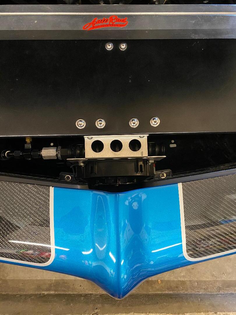

      Derale has trans coolers with temp sensors and fans that you can put just about anywhere... I have a small one in the nose of my Firebird and run a trans temp gauge and it never gets hot.Name:  Trans Cooler.jpg
