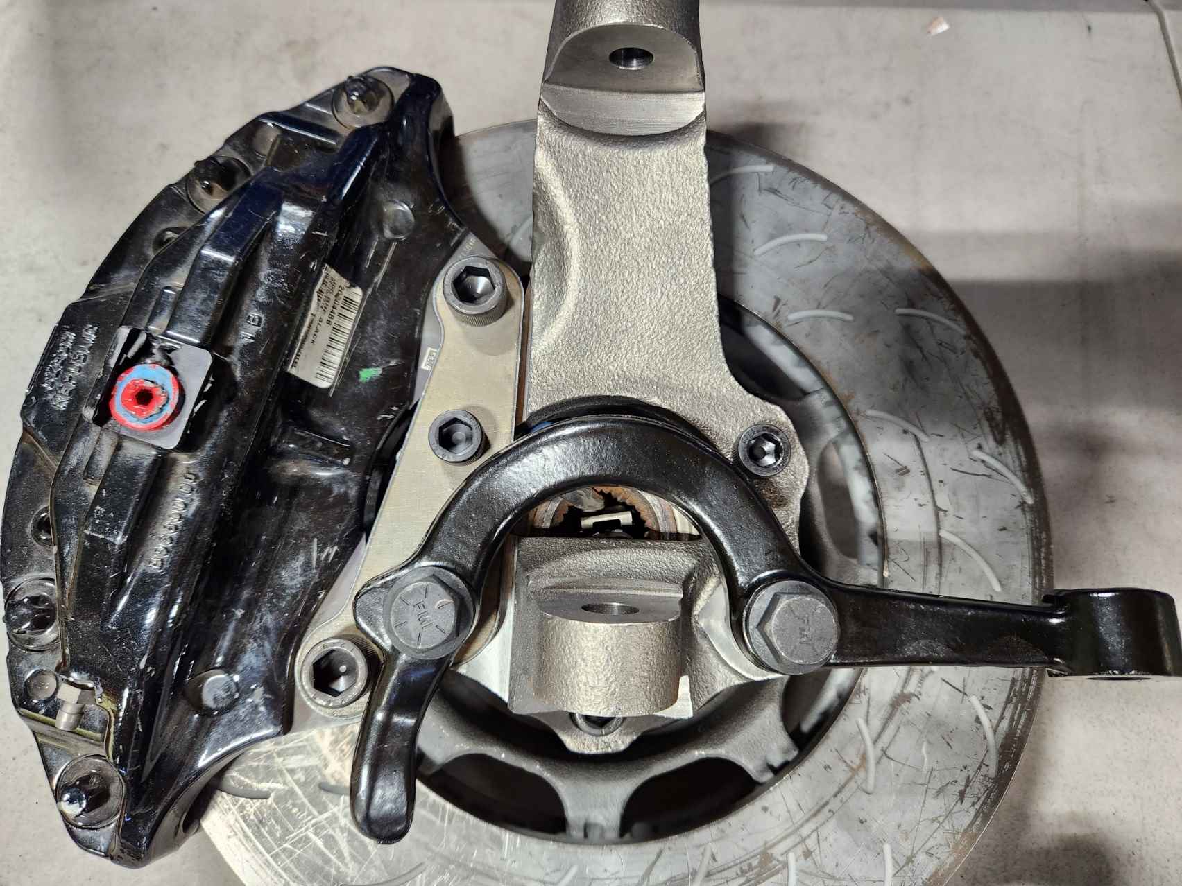

      Stock height CPP C5 knuckle with GM brembo brakes
      These need some mods to fit the various GM Brembo brakes but it is a nice option for a A-Body or front steer

      What mods did you perform, what brembo did you use, camaro?
      Mar 2015
      11
      Quote Originally Posted by Jk918 View Post
      I sink the bracket into the casting so it is at the original steer arm pad depth and remove the C5 lug mounts of course, brakes that fit...basically all of the GM ones- they are listed here
