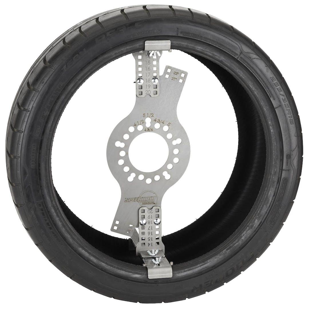

      I know this has been beat to death and please don't pick on me. I'm in the going together stages of a 72 camaro and have hit a road block. the stock spindle has the a arms running way up hill and struggle to get to desired ride height (qa1 a arms and front suspension kit). I bought a set up Wilwood 2" drop spindles and the steering arm section of the spindle crashes into the wheel, or where the wheel is going to go- I have tire mocked up on wheel fitment tool. I know guys run big tires on the front of these cars and I'm not sure what to do. CPP Corvette style? is there a better option? tire is 275/35/18. I see that lots of guys say don't use drop spindles. If that's bad ok. I'll get rid of them.

      100% the wilwood steering arm portion of the spindle crashes into a 10" wide 18" wheel (actually the tire). My tool is the one from speedway. I think I'm figuring out that's why guys don't like drop spindles on these cars on anything but drag cars. the tie rod end stays in the same place and the wheel moves up 2" effectively crashing the steering arm (cast on- not a big deal on other spindles as you can fabricate steering arms and move the steering around like is done all the time on drag cars).

      The bottom of the steering arm is 2.98" straight down from the spindle CL. Tie Rod CL is 6.34" forward of the spindle CL. Rough math from an online calculator puts the center of the tie rod hole approximately 7" from spindle centerline. I admit, that seems close, but I will stand by my statement that I think it is unlikely that Wilwood would manufacture a spindle for a Camaro that doesn't fit in an 18" Wheel.
      These tend to not work very well. There is nothing to center the tire on the fixture or keep it square to your hub face. I had the cast aluminum version of this a long time ago and the information I got from it was not useful.
